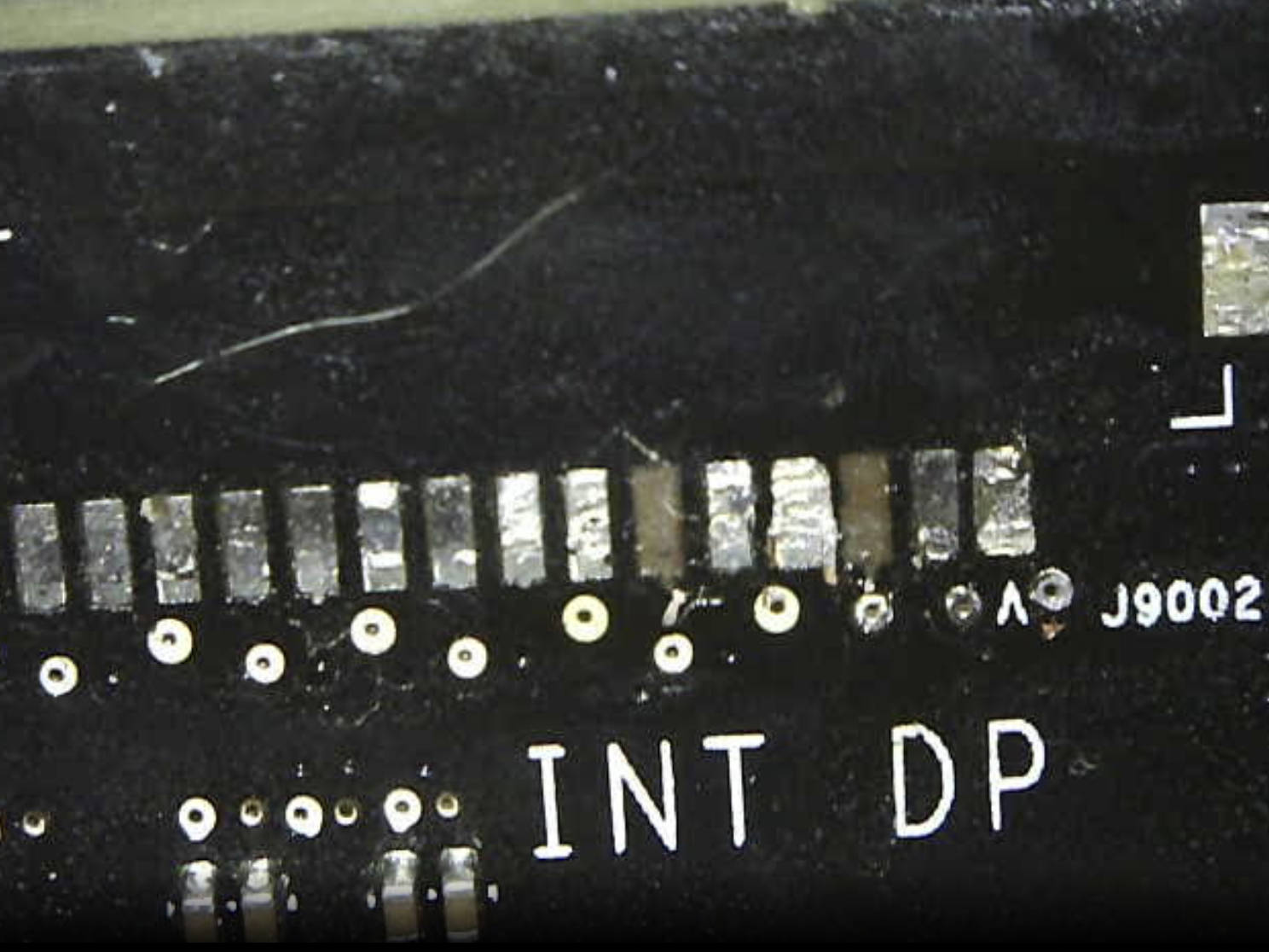

I have 2 missing copper pads under pins 3 and 6 where my LVDS connector mounts to my logic board. I have seen some videos where folks run jumper wires when this happens. If this is the correct way to proceed I need help finding where they need to go. I have the schematic for my computer and have pictures with red ovals next to the relevant information.

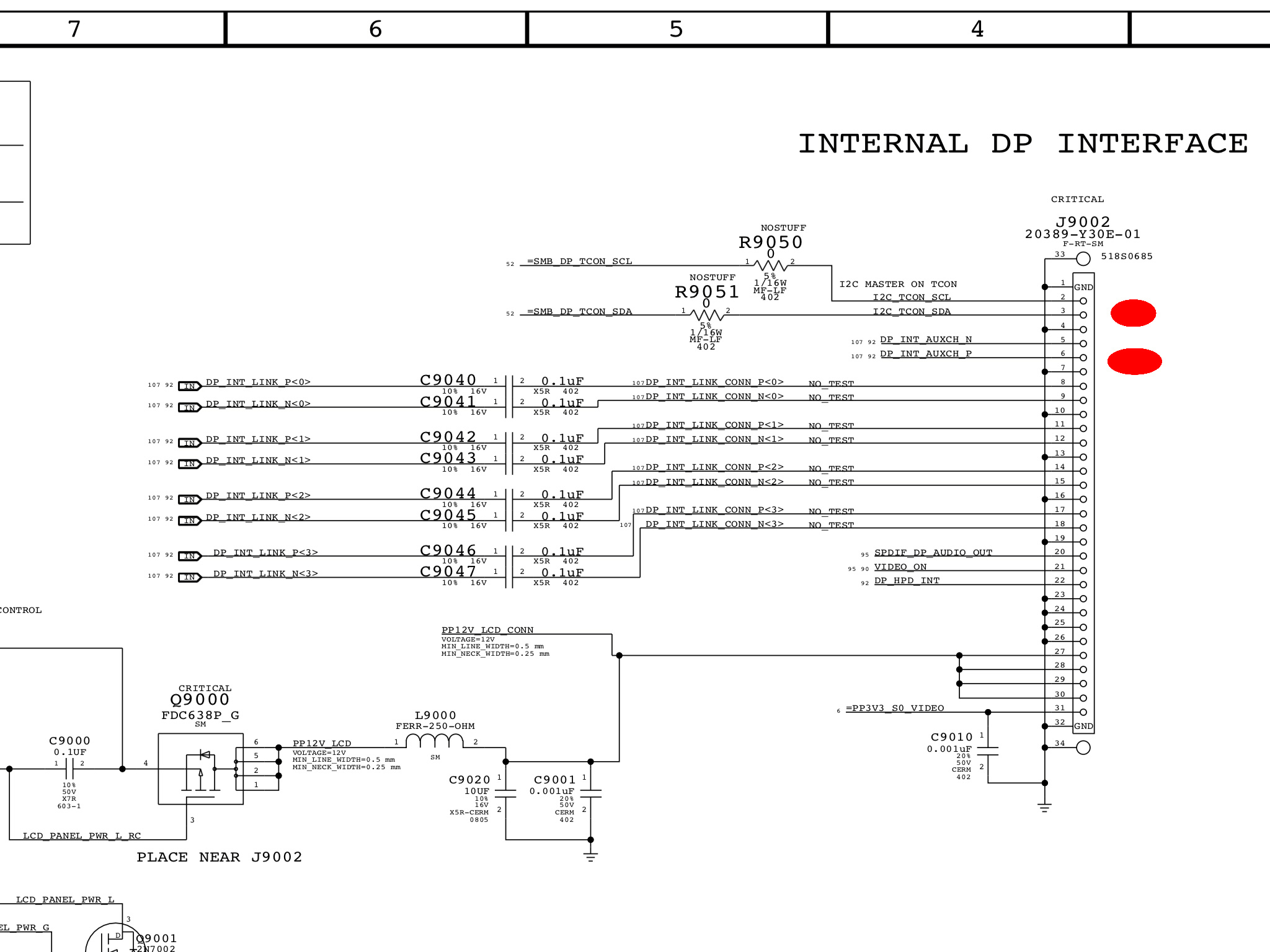

Above is the LVDS connector schematic.

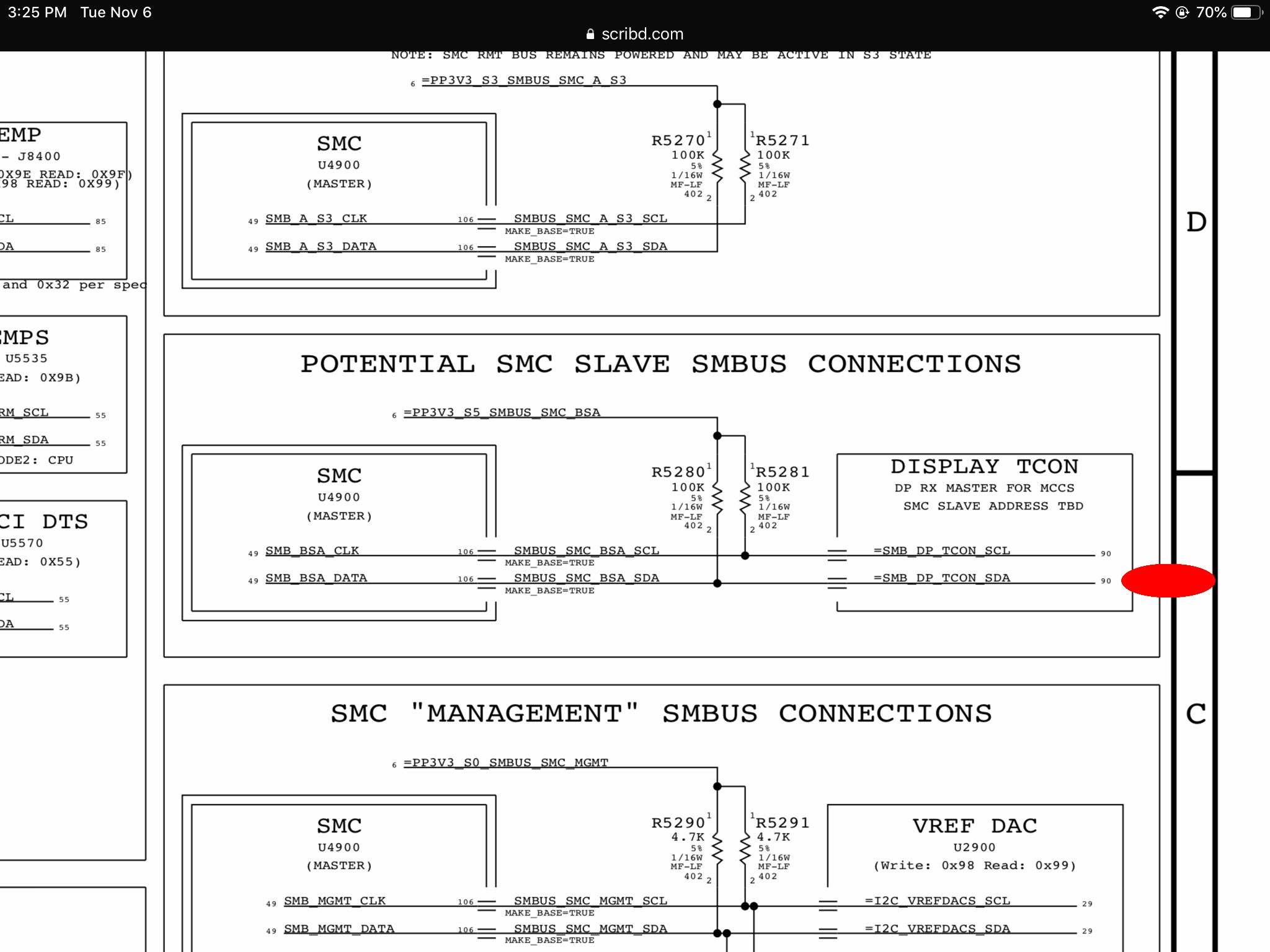

This is where I believe pin 3 is supposed to go.

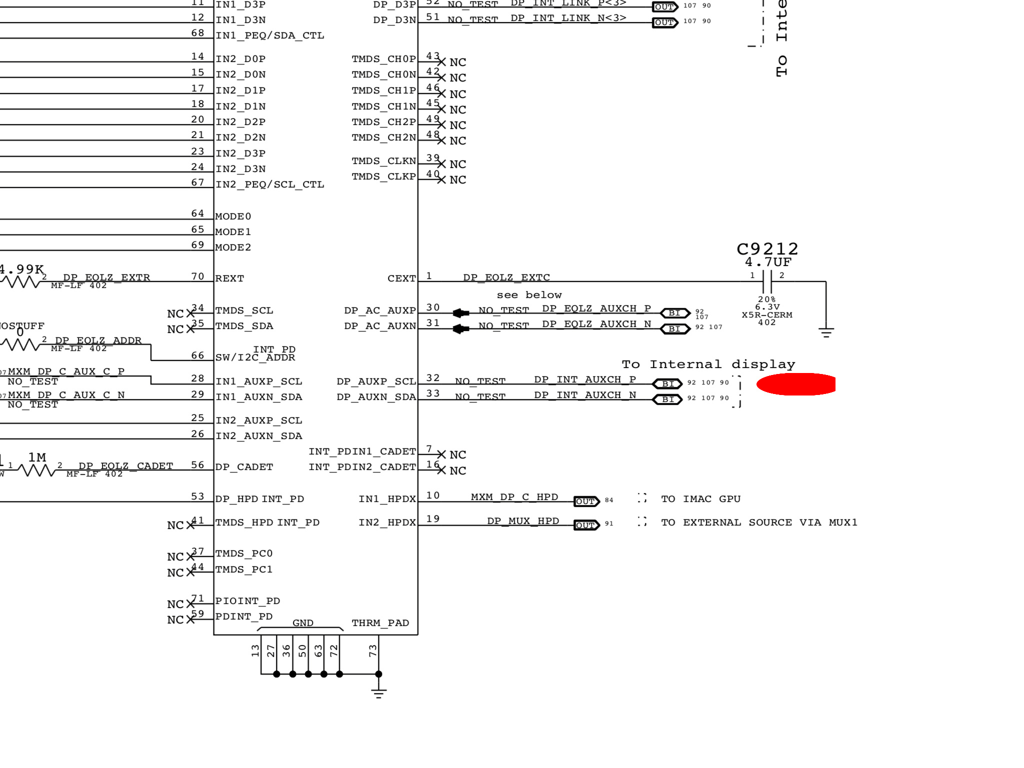

This is where I believe pin 6 is supposed to go.
Is it possible to run jumper wires from pins 3 and 6 of the new LVDS connector to where I have indicated on the schematics? If so, how do I find the locations with the red ovals on pictures 2 and 3 to run the jumper wires to?
