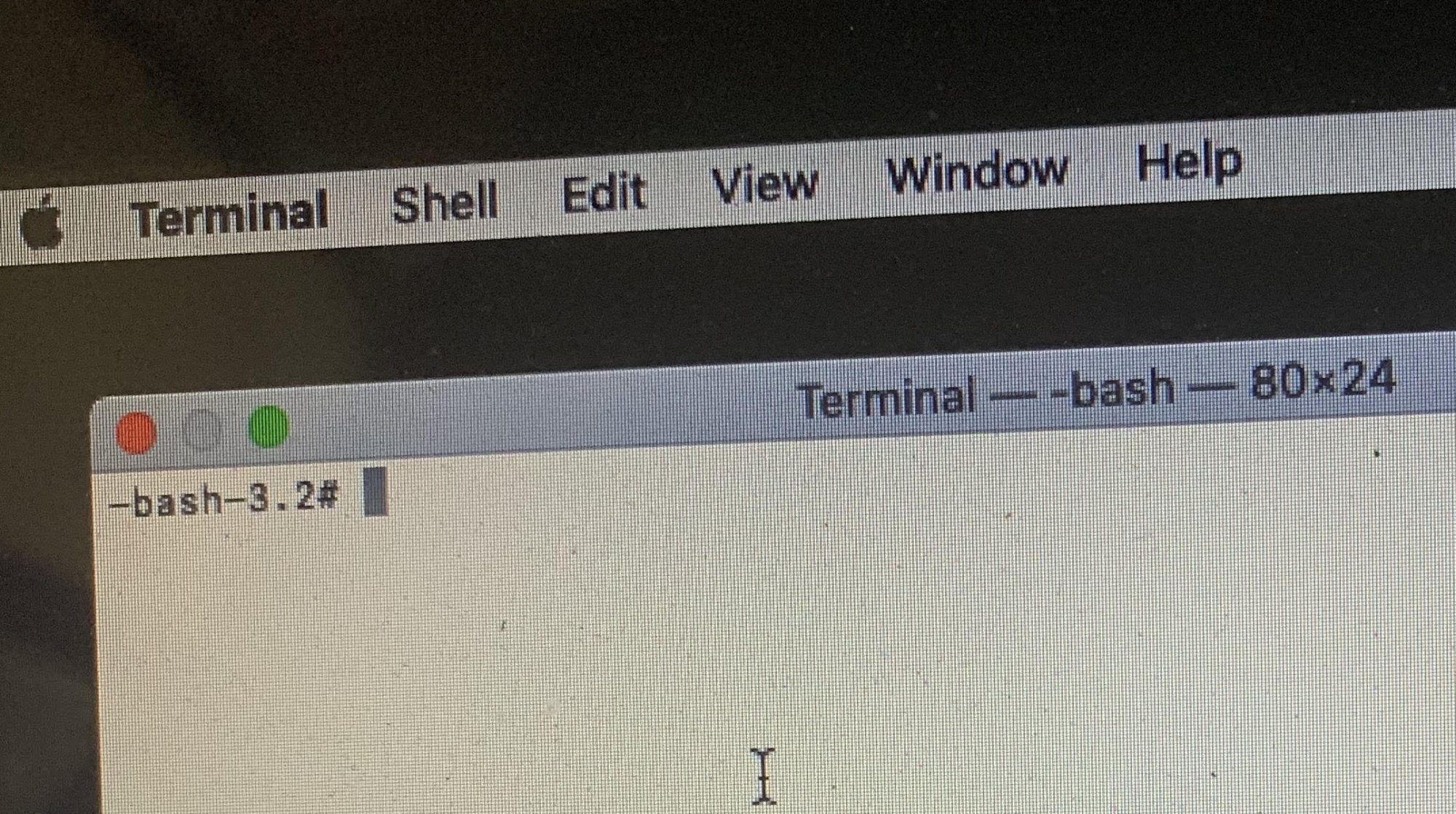

I can not connect to my network since I type in terminal this command
networksetup -removepreferredwirelessnetwork en1 Name_of_WiFi

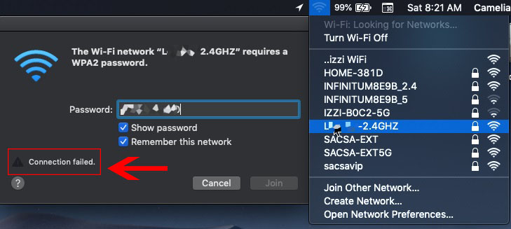

I can't connect, after entering my password and check "Remember this network"
Please Help!
"Connection Failed" after selecting my "Network" AND entering my "Password"

Hm. The command you typed in Terminal shouldn't have anything to do with this. It's the equivalent to just forgetting the network existed and connecting to it anew should work. - Do you get any further details on what part of the connection process failed if you hover the mouse over the triangle to the left of "Connection failed."?
No, I don't have any further details on what part of the connection process failed if I hover the mouse over the triangle to the left of "Connection failed."
I can only click on the "question mark symbol" it opens the "macOS User Guide"
"You are not connected to the the internet"

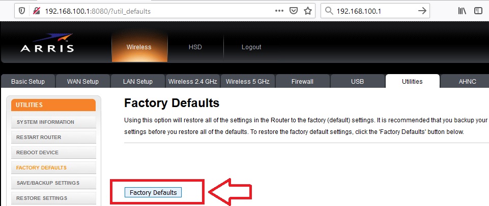

They are 2 ways to do the factory reset, the modem has a small hole in the back, if I pushed for 20 seconds, the factory reset starts or from their Portal:

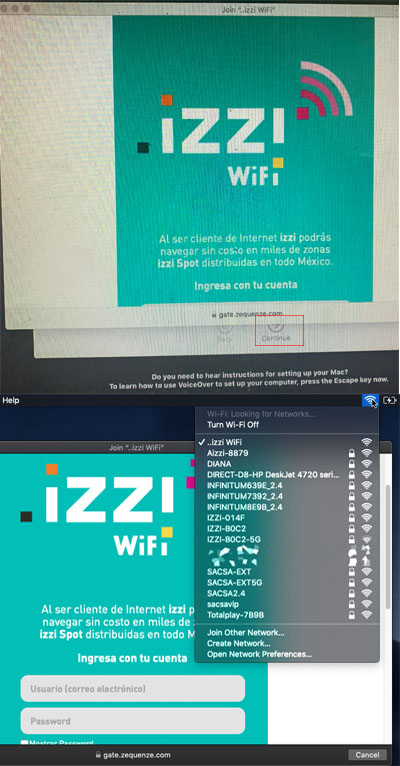

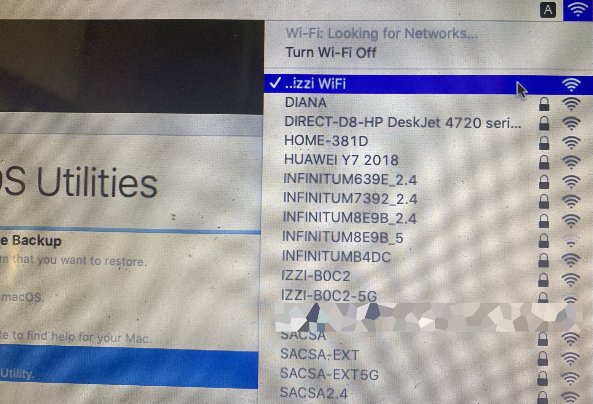

A) The problem started when iZZi enabled a free WiFi Spot (...iZZi WiFi) very near to my apartment, and their signal is stronger than mine.
B) Connected to my Network, and having a lot of problems with a slow system, I decided to format my MBP, and start a clean install, inserting my bootable USB Stick, but immediately my MBP connects to the...iZZi WiFi network, doesn't allow me to choice my own Network, click on "Continue"
C) Due the ...iZZi WiFi is not secure, I decide it to type networksetup -removepreferredwirelessnetwork en1 NANE OF MY NETWORK Instead networksetup -removepreferredwirelessnetwork en1 ...iZZi WiFi
D) How do I list via terminal all the active Networks?
E) Is possible to block Mac "...iZZi WiFi" Network from macOS Recovery Mode > Terminal?

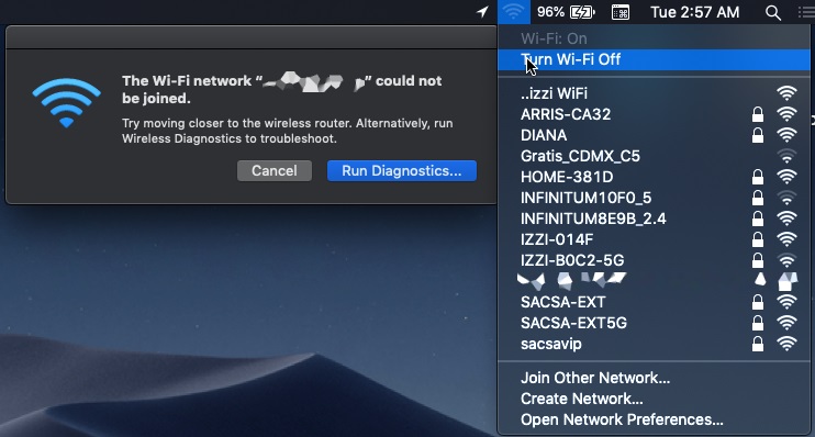

In your router’s wifi settings, change the channel from auto to something else, e.g. 1, 11, 6 for the 2.4 band. One of the settings you try should fix it. Macs can be pickier than iPhones and PCs about interference on the auto-selected channel.
