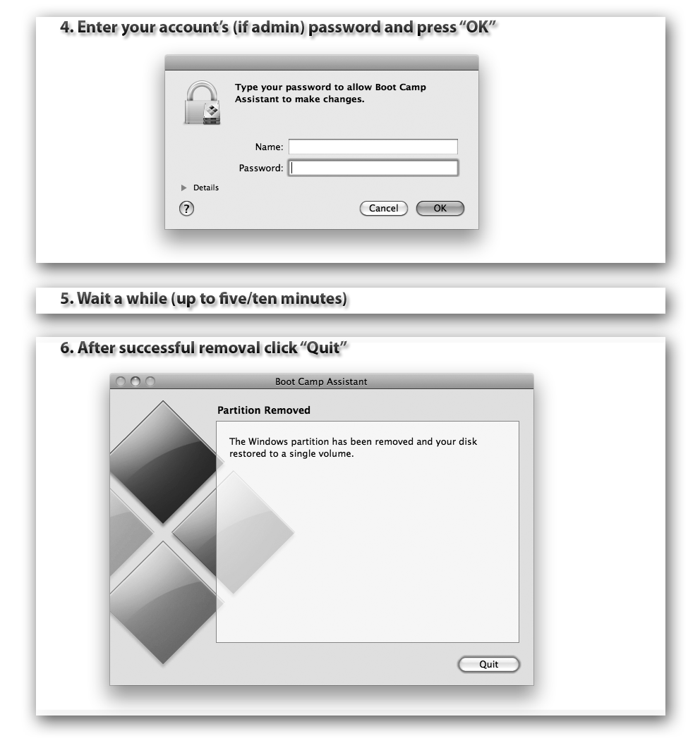

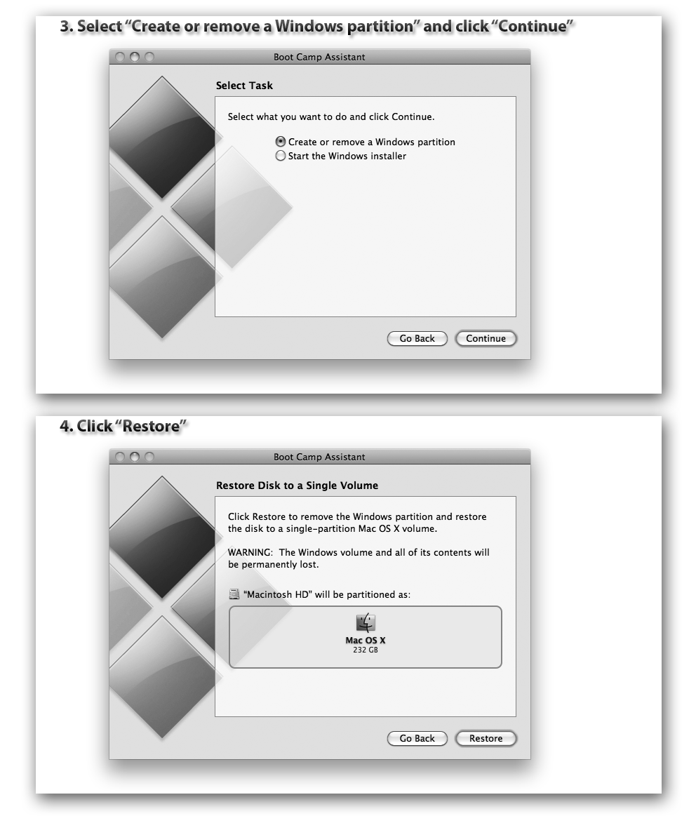

Then use Boot Camp Assistant to remove the Windows partition and use it again to create a new one and try to reinstall WIndows again. Don 't use Disk Utility to erase the Windows partition.

It is not really complicated as shown below.
