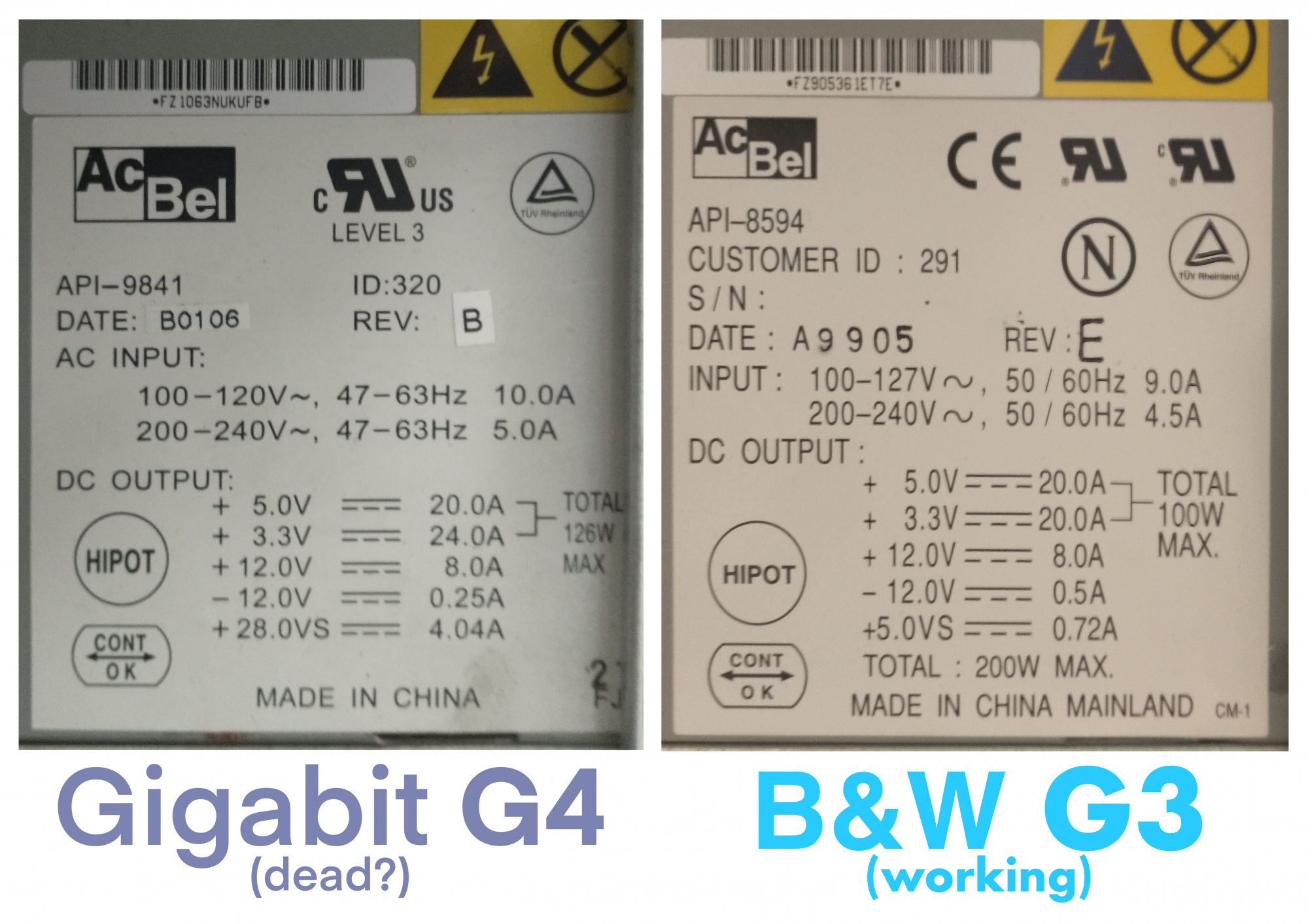

On another note I have a working B&W G3 PSU but the numbers are different. I have included a picture with the specs of both, perhaps it could be useful.
Thanks –BronzeLight
The G3 PSU looks like a pretty good match. Are the connectors to the logic board quite different? If so you would need some pinout diagrams of both units to rebuild the plug to suit the DA.

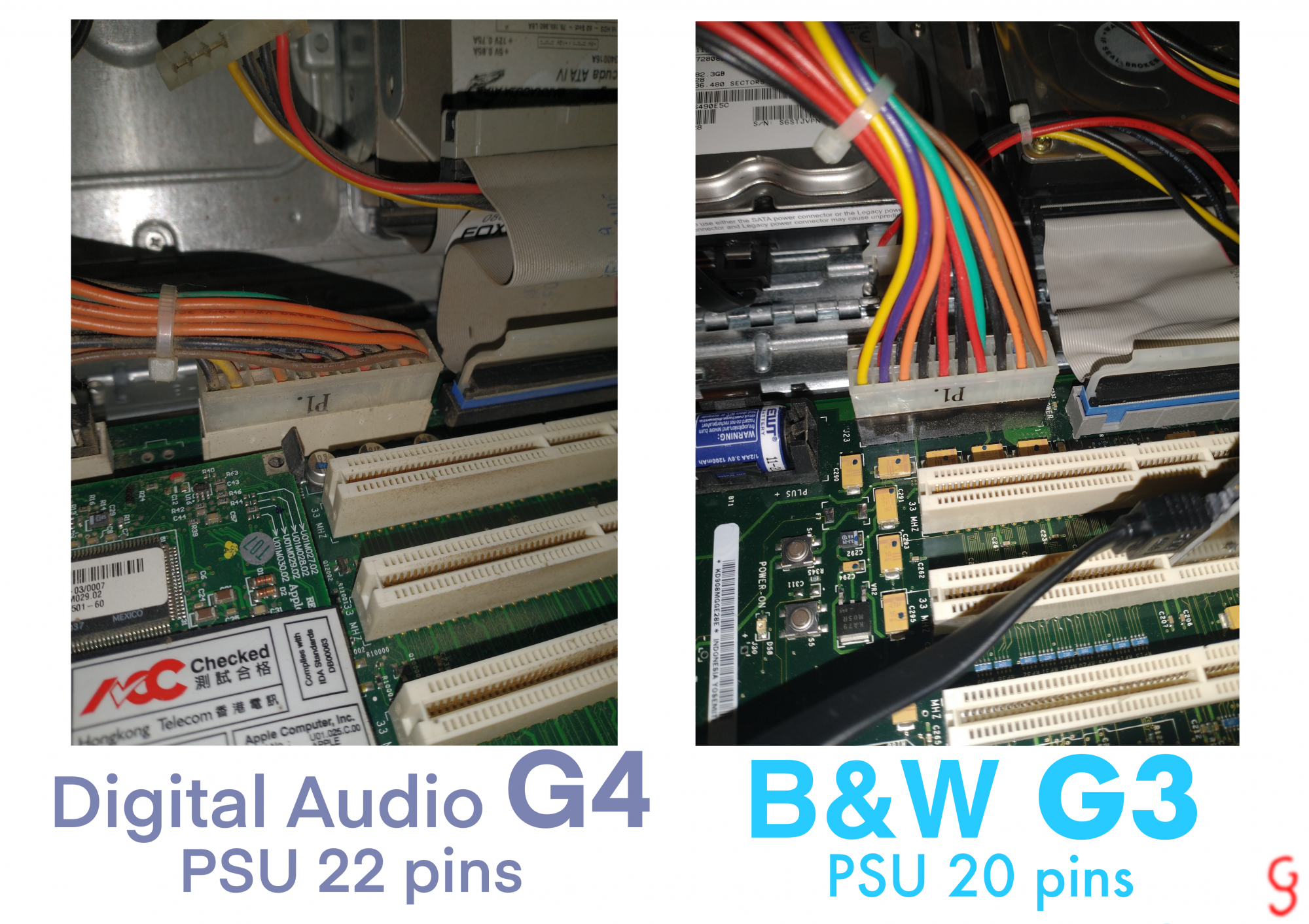

Ok, I checked out the PSUs last night and found the the G3 has 20 pins and the G4 has 22 pins, here is a pic:

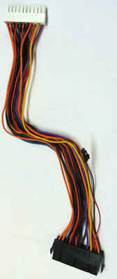

I’d pick up a brand new ATX psu and use one of these converter harnesses.
Thanks for this! If I go this route, do you know if there is anything else I need to look out for other than size/molex cables when shopping for a replacement atx unit?
You'll need to decide if you're going to run the system with the PSU on the outside and the door down OR find an ATX PSU that is going to fit into that space.
You may have to do some cutting.
This may give you some idea of what is involved.
Seems like one of these adapter cables is the way to go. Thanks for the comments everyone, they are very helpful! If I manage to get this rig going I'll post an update in this thread.

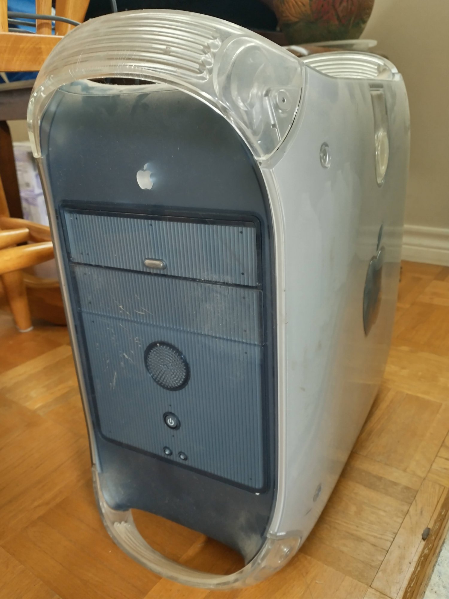

That looks like a dual 533 CPU. Those are nice computers. So you pressed the button in the lower right part of your picture?
Yes I pressed that button. That's pretty interesting that it might be a dual 533 as the sticker on the back indicates it was supposed to have a 466. I noticed that the ram was mixed so maybe somebody swapped it the CPU aswell.
Entirely possible as my single 733mhz quicksilver is upgraded to dual 1ghz w/ L3 cache. Lots of us tinkerers around. :apple:

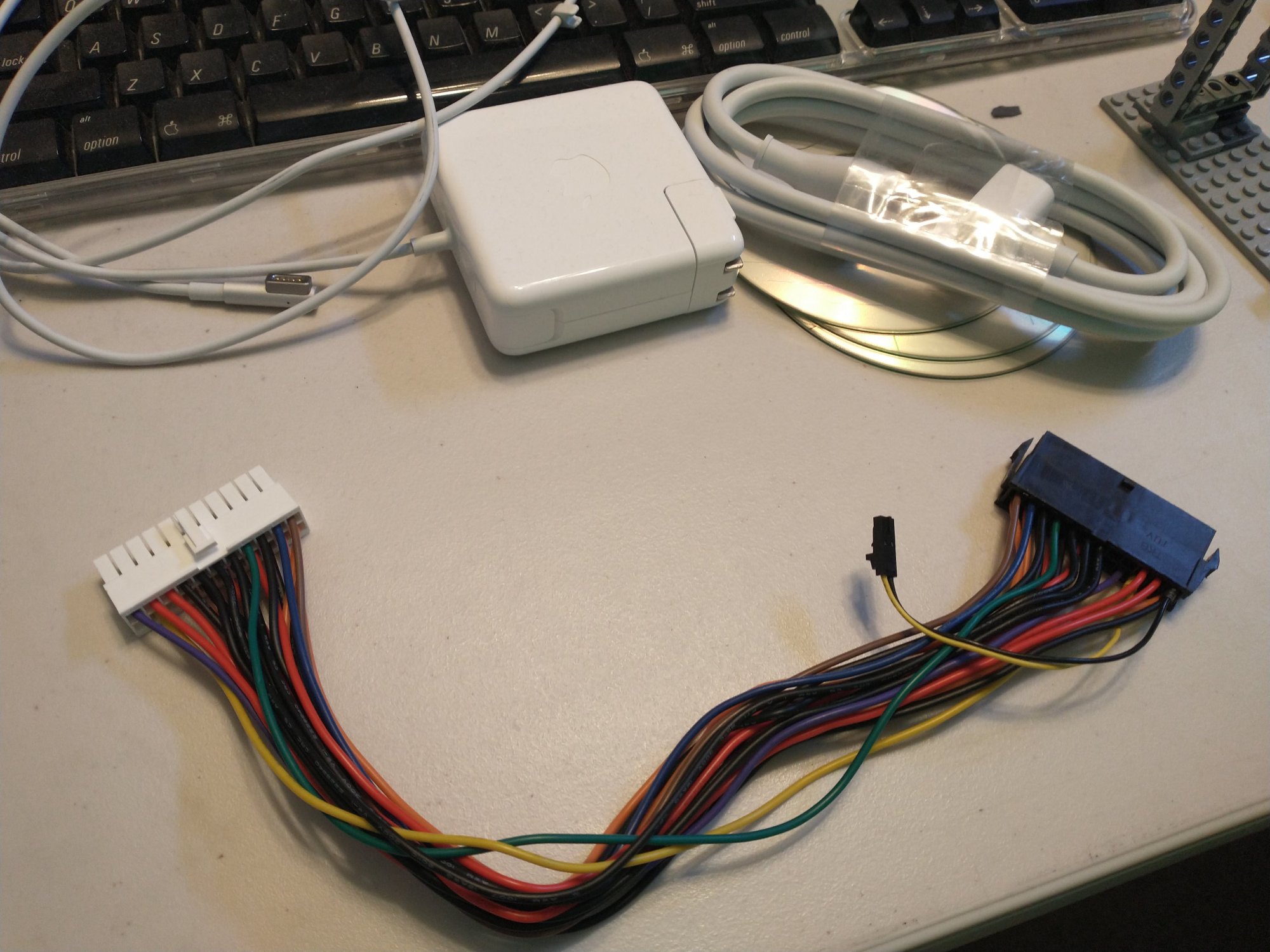

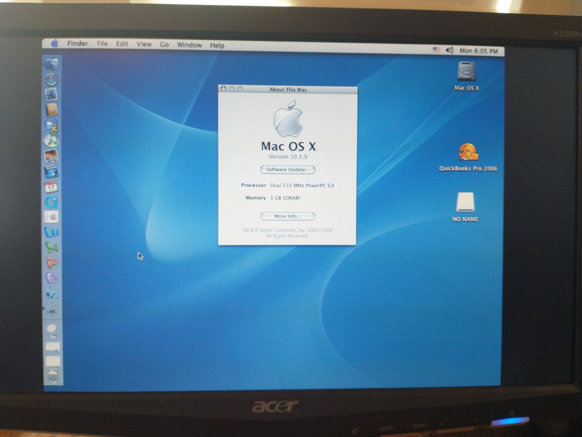

Update: The machine is up and going and the previous owners data has been recovered!
(upon their request of course)
A hearty thanks to: ervus, AphoticD, Certificate of Excellence, eyoungren, salamanderjuice, and Macbookprodude! Your replies proved very helpful!

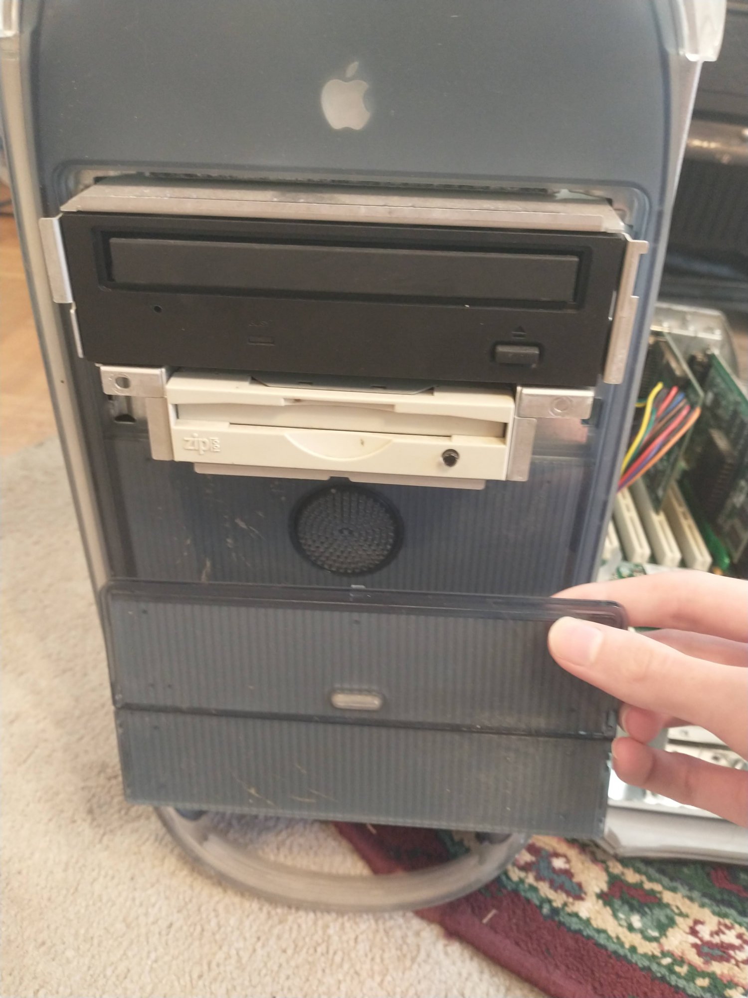

I ended up purchasing the adapter that Certificate of Excellence highlighted since I didn't have some of the required parts in my stash. The machine is a 533 MHz G4 with 1gb total ram over 3 sticks (2x 256 and one 512) running OSX 10.3.9. Another quirk about this machine is that it has a Zip drive but it's missing the cutout for it on the front bezel! Everymac says Apple did sell some models with Zip drives but this one is held in with only one screw... my gut still says "factory" but maybe it was added in later!
