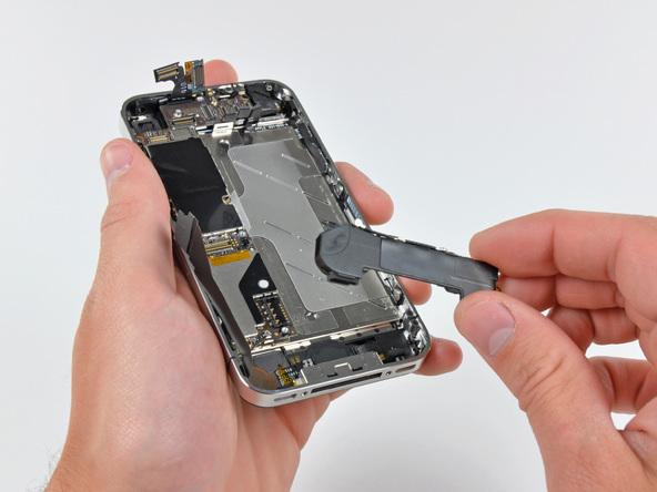

And as pointed out in step 12 of iFixit's iPhone 4 teardown, the cell antenna at least( they never pointed out the WiFi/GPS/BT antenna) is where the left seam is. So the interference is the strongest there causing the issue. Where touching it on the opposite sides doesn't cause much of an issue because you're not near the actual antenna.
