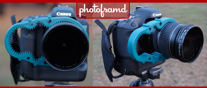

I'm assuming you are either considering or have considered a follow focus ring as well?
I think that one's made from a jar opener :eek: :D
Yeah, but never that one.
