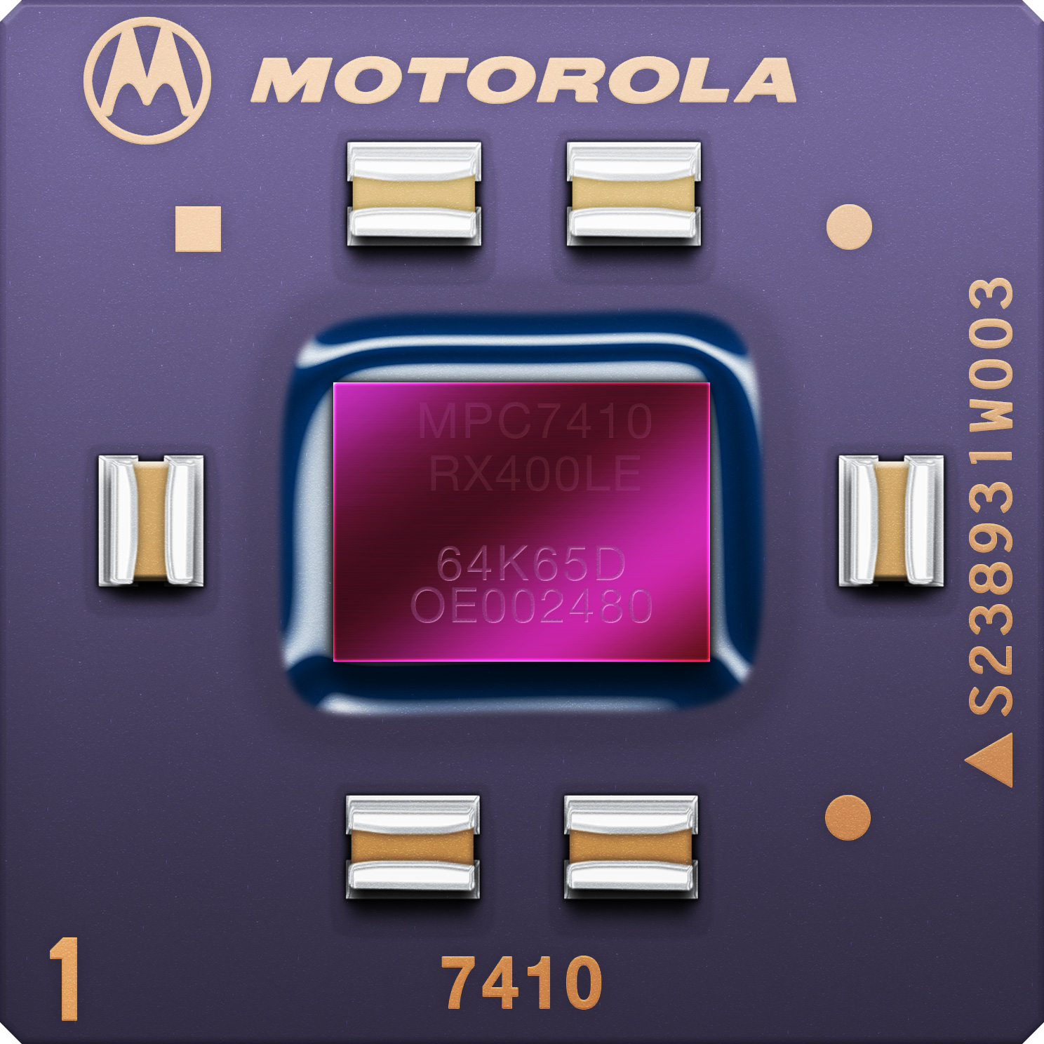

Hi. I have an iBook G3 Snow a Dual Usb, and I bought a Motorola 7410 to upgrade it to. I also bought 512 MB RAM to get rid of the current 64 Mb RAM. I am also interested in buying a SuperDrive.
Here are my questions:
-How do I perform the upgrade from a G3 to a G4.. I’ve seen people do it, but it looks hard..
-What SuperDrive do I have to buy? Will this one work? It’s from a G3. Or will this SuperDrive from a G4 work? Link here. Or will a Macbook SuperDrive work?
-Can I buy a 100 to 120 GB HDD to replace the current 30 GB HDD? If so, what are my requirements for a HDD? Size?
I bought OS X Tiger; it came, but I am going to install thru Target Disc Mode. I’m on Cheetah 10.0.3 right now. Wanted to know if I could install a superdrive/DVD drive.
I am planning on using it daily.
Here is the Motorola 7410 I bought.
Anything else I should know? Already bought the 7410 and the 512 MB RAM. I want to upgrade it to Leopard, if that is even possible. If you know any guides or steps to re-assemble, I’d appreciate it. Thanks!

@dosdude1 would be the only one I can think of with any knowledge on this.
To install the G4, you have to de-solder the G3 and solder the G4 in its place. They are not CPU sockets. So unless you can do that, don't waste time on this project. Dosdude would probably do it for you for a fee, and on his own time if you are still wanting to do this but can't solder the chip. He did my Pismo's G4 upgrade. Myself and many other can vouch for his work.

Sorry to shoot this idea down immediately, but it is not possible to upgrade the CPUs on these Snow iBook G3s to G4 CPUs, simply because they use a variant of a G3 CPU (IBM PPC750CXe) that is not pin-compatible with any G4 CPU available. Therefore, it cannot be upgraded to a G4 of any kind.
I didn’t actually realize that. I assumed they used the same “socket” as 7400s/7410s. Just curious, is this all the white iBook G3s? They made quite a few different models as you know.

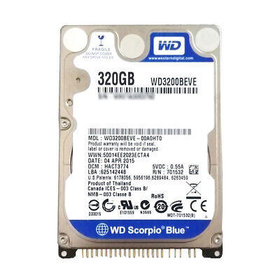

Pretty much any 9.5mm IDE drive should work fine. Most any drive you’ll find new today will be SATA, and those will not work in an iBook. Your best bet for a new drive is eBay. What I normally suggest to people is to get an old original 160GB Apple TV for about $30 and harvest the hard drive from it.
You can still get 320GB WD IDE 2.5" drives (the largest ever made) on eBay for about $35/£25 open box but unused, according to listings, from China if you are prepared to wait for shipping.
e.g.
but that's brushing up against the current cost of 240GB mSATA/M.2 drives plus a cheap IDE adapter.

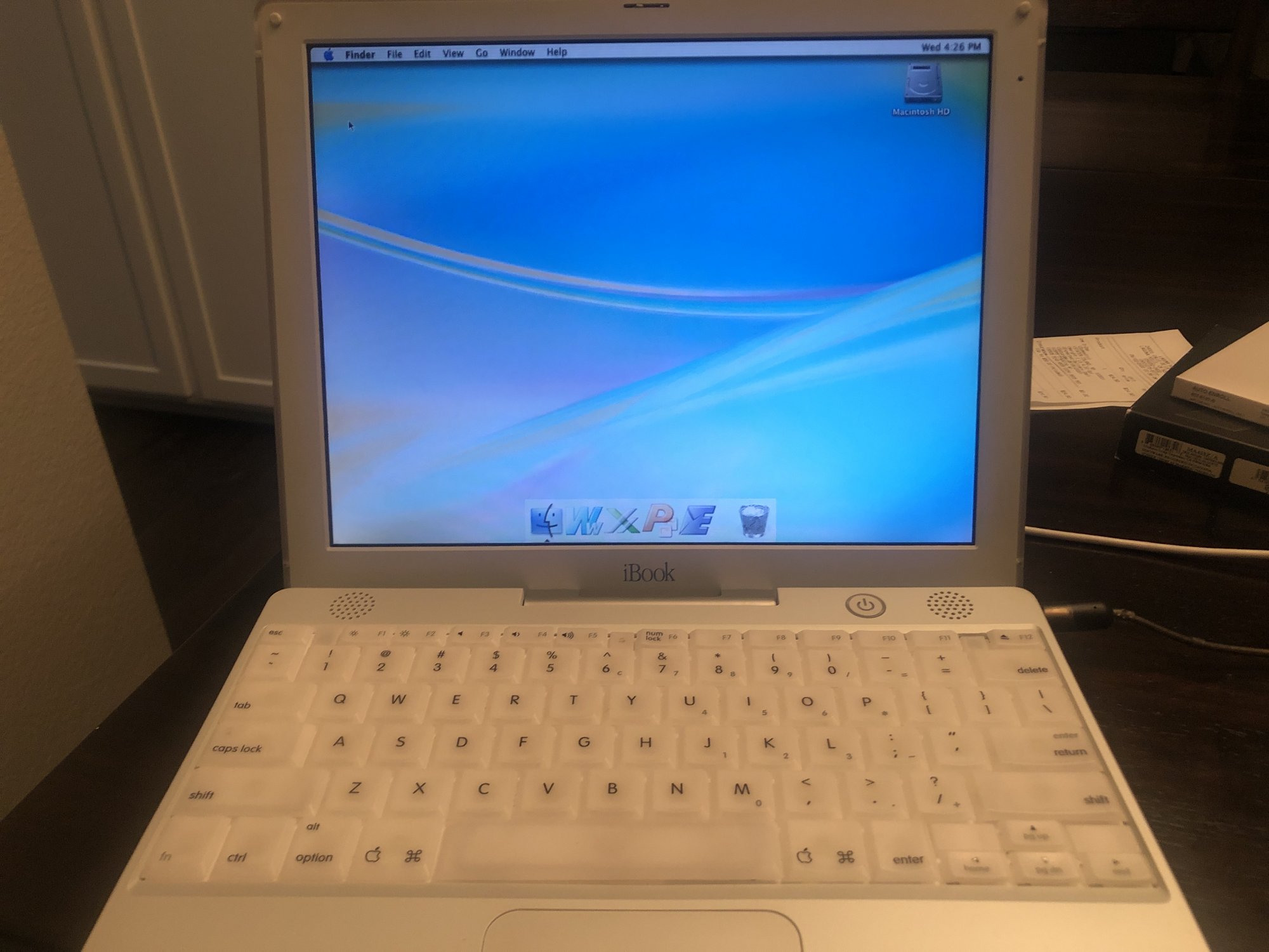

Well, I don’t know if I want to buy a G4 if I got my G3 for “free”. I don’t know that much about soldering, I just turned 13... I’ve been working on all my 6 computers every day... Sigh. I wish the Snow CPU were pin compatible because it would be nice to see Leopard on it just for “show”.. Now that I have a MacBook, I feel stupid spending a lot on the iBook. I’ve successfully installed the RAM, that was easy. 512 MB. Still says 64 MB, I have no idea why. This iBook has a really weird story on how it got to cheetah 10.0.3:
This is how.
So around 5 months ago, I began working on the iBook.
It was on OS 9. Had a bunch of old work files on it and stuff.
I decided I wanted to use it. I got permission and got rid of some stuff.
I really wanted to update it to Tiger, so after 26 burned CDs, one of them FINALLY booted. It was a CHEETAH cd! But it upgraded itself straight from 9.1 to 10.0.3 without me having to set it up or anything. So creepy. I holded X and it worked. On the downside, this weird OS X it’s running has NO applications, it’s a waste. Can’t do anything really on it, except in the Classic Environment. Some parts came so can’t wait to get started! It’s 4 AM, i’ve been working on my Mac all night, need to get rest. Bye all- thank u!!

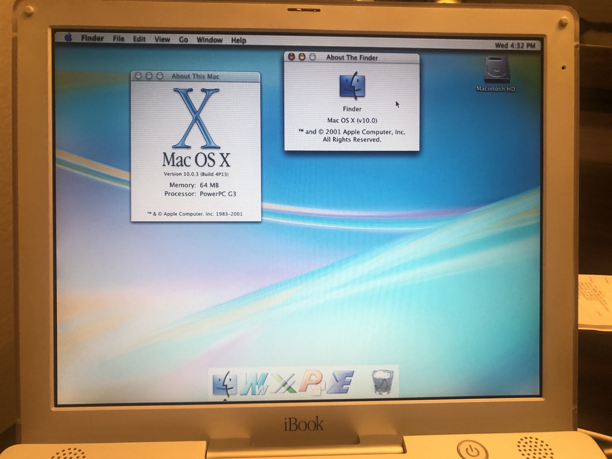

Even then, Cheetah is still a total waste of time.
Yeah probably... I just don’t know why it upgraded itself and messed up the computer the way it did..
