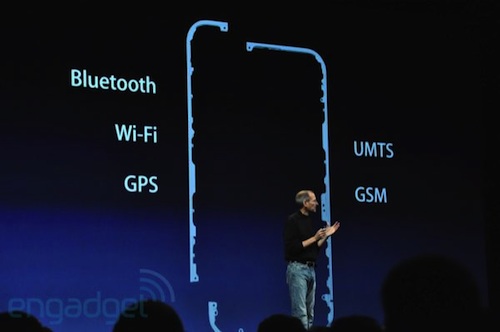

Why does touching the top seam do nothing? Honest question. If we're "elongating" and messing up the cell antenna by joining the two, it should make the same signal issues appear. Any ideas?
Still, the theory should still hold water. Someone should test it out and see if the other functions are affected when bridged.
the antenna on the right side of the phone, isn't that all one continuous gsm antenna? at least, that's how the picture makes it look - that there are 2 discrete antennas and those two should meet at two different spots.

Touching an antenna isn't just touching an antenna. The problem is much more complicated than just conductivity. A simple analogy would be a guitar string, touching it at the tuning peg won't cause a significant shift in pitch, but touching it anywhere else along it's length will cause a change in tone. That's not exactly how it works, but it should give you an idea.
