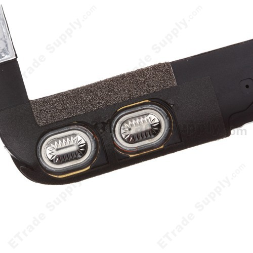

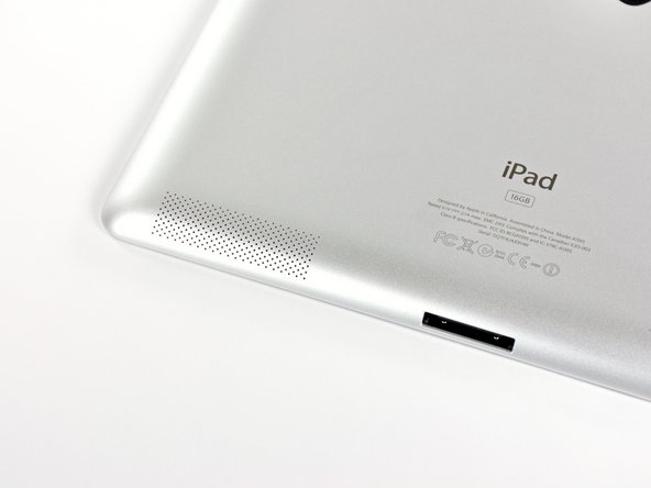

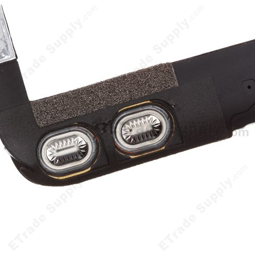

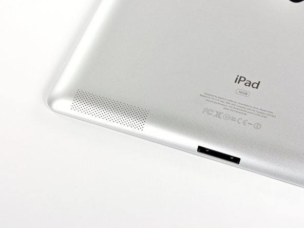

Apple has used a dual-transducer design for each "speaker" since the original iPad. Below are photos of the iPad 2.
