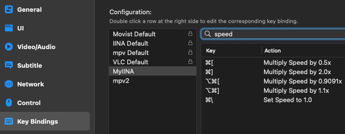

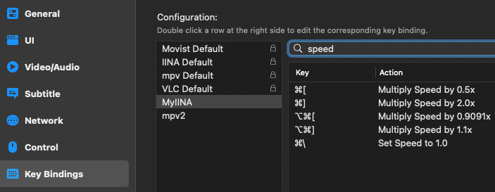

Thanks, I was using the audio delay and reset options in the Audio drop-down menu as opposed to the Playback menu.
To prevent accidental modification of speed settings, you can go into IINA’s settings – Key Bindings – duplicate the IINA Default configuration – search for speed and remove the shortcuts.
