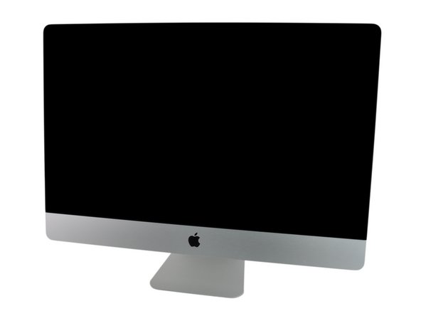

Hey everyone,
I got a 2011 iMac that won't get past progress bar on any OS/hdd/ssd.
So far tested: old hdd with High sierra, ssd with win 10 - can't boot fully, only restarts at progress bar.
I even managed to install Ventura with oclp on new ssd but after root patching, I got the same problem.
Tried to reset NVRAM, SMC, nothing works.
Maybe some hardware or firmware lock?
Thanks!

The 2011 iMac is known for GPU failures (I've had 3 with mine), so maybe that might be the issue. Have you had the machine for some time (by that I mean are you familiar with its history, use etc)?
Tried to boot into safe mode, hangs on half of progress bar (left it for an hour 😂). Ventura via oclp is working, no screen glitches, green stripes etc., "About mac" says 6970m., but I think it's running on integrated gpu because as soon as I patch & restart it, I encounter bootloop. I'm not familiar with it's history, I bought it for parts but interested to learn what is wrong 😃

If you're happy to dismantle a little, there's some LEDs on the logic board that might help indicate what the problem is. I think they light up differently depending on the issue (like a Windows PC going through post).
Pages here are handy for tearing it down, if you haven't already:
