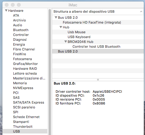

I'm trying to refurbish an EMC 2428 iMac and almost everything has been fixed.
Unfortunately every other USB port is not working:
#1 (close to the audio sockets) does not detect any device.
#2 is working fine.
#3 is not detecting any device.
#4 is working fine.
on both defective ports (#1 and #3) power is available (5.02 V measured with a multimeter) but neither keyboard/mouse nor USB drives are detected.
Tried all sorts of resets and even reinstalled OS from scratch more than once but the problem is still there.
is there any trick I am missing? Not even sure it is HW or SW related...
Thanks in advance to anybody willing to help me

thank you.
I checked and it looks like it is indeed a hardware fault. Also the SD reader (and imagine IR) is not working. USB HUB1 must be at fault.
now I have to decide whether it is a good idea to take it all apart (again) or not.
thank you.

Just fixed a 2011 21.5 with 1 USB port dead. Probably is likely knocked off components during logic board reinstall while swapping HDD for SSD. There is a black rubber tape below the USB ports on the backside (away from facing the screen) with a black foam tape on it. Area is very right during logic board reinstall, mine had crimp mark on the tape and component knocked off below (a tiny (0402?) cap) Solder it back on (I have microsoldering iron + hot air station) and everything works
