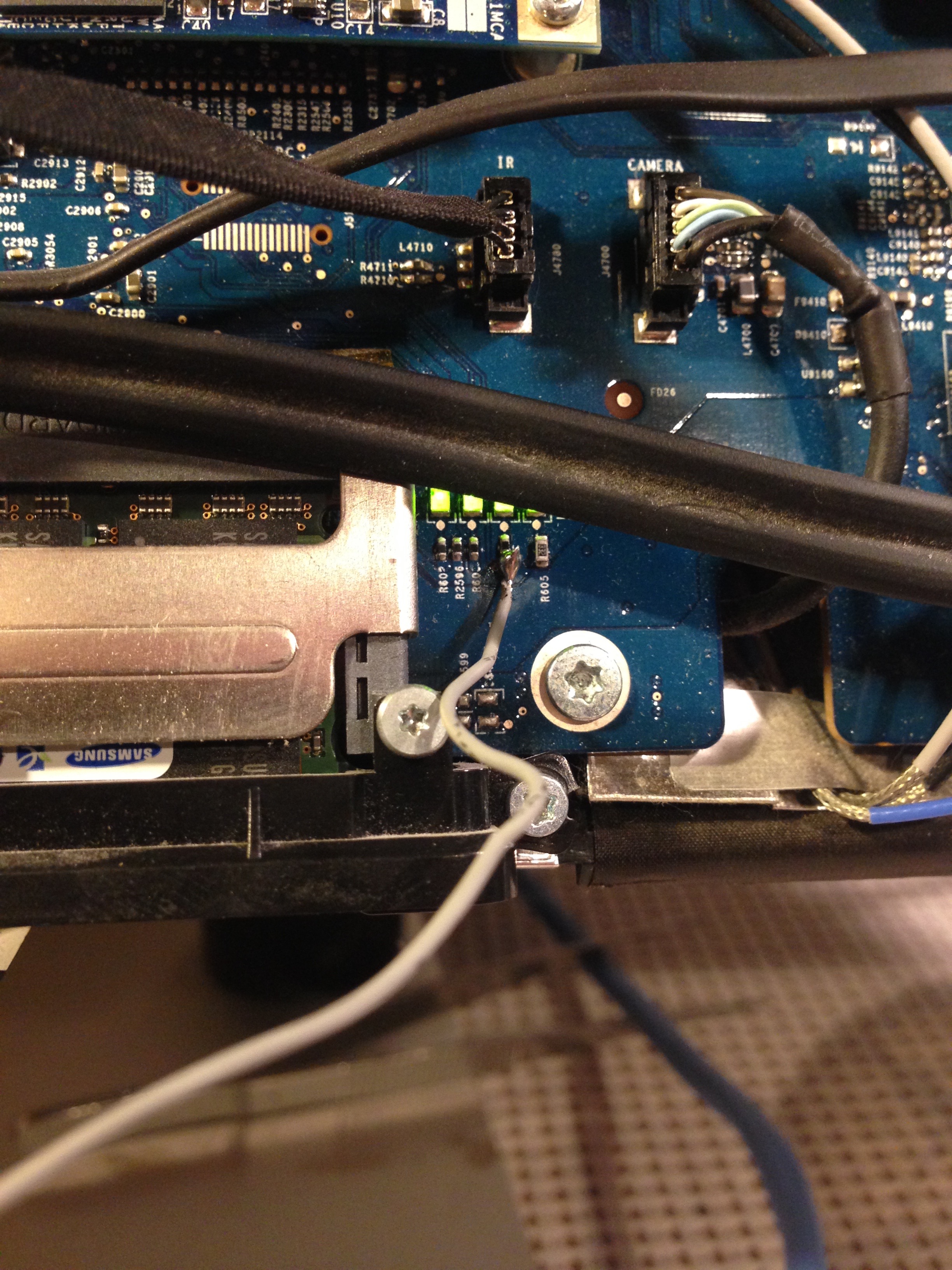

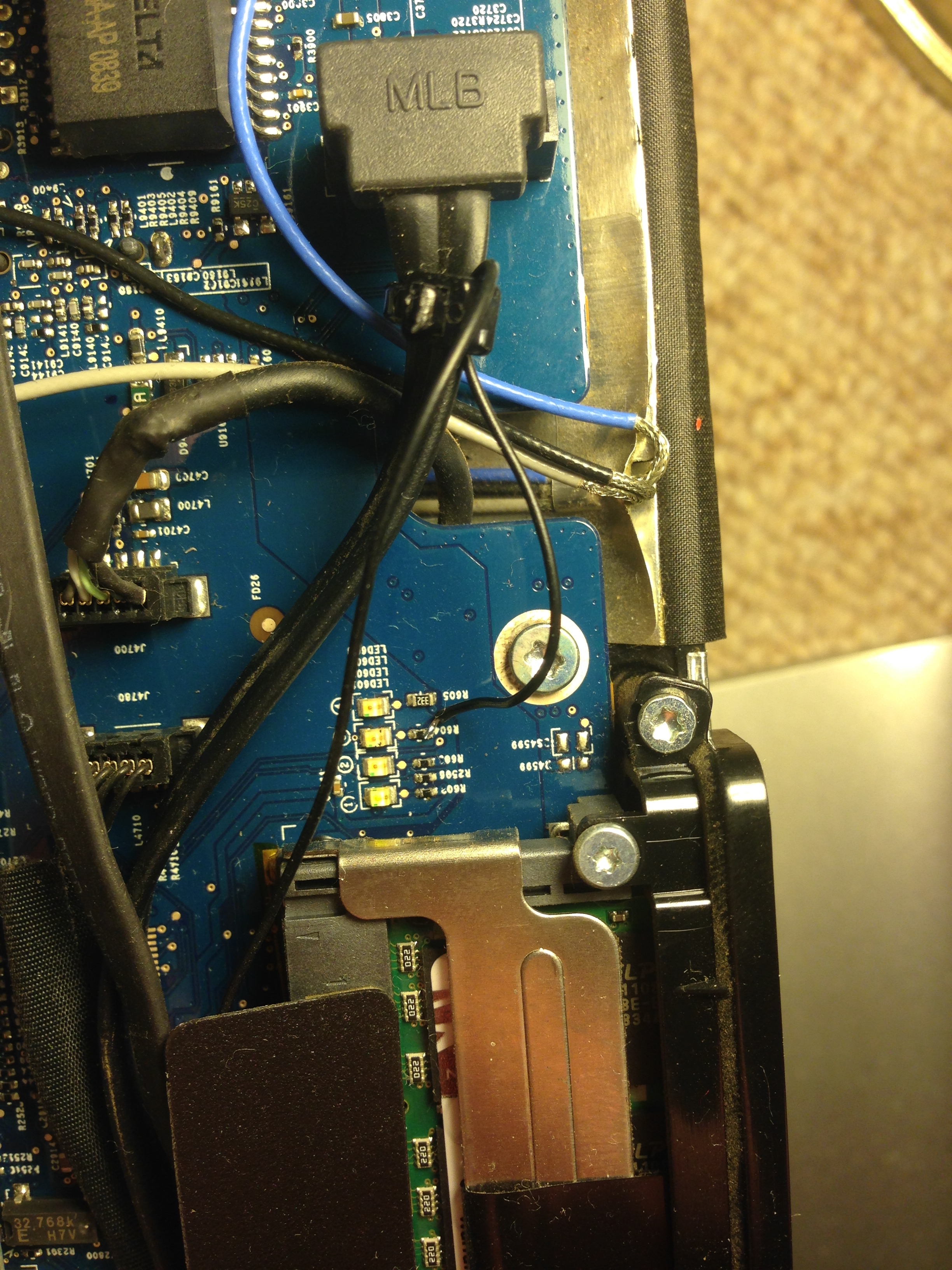

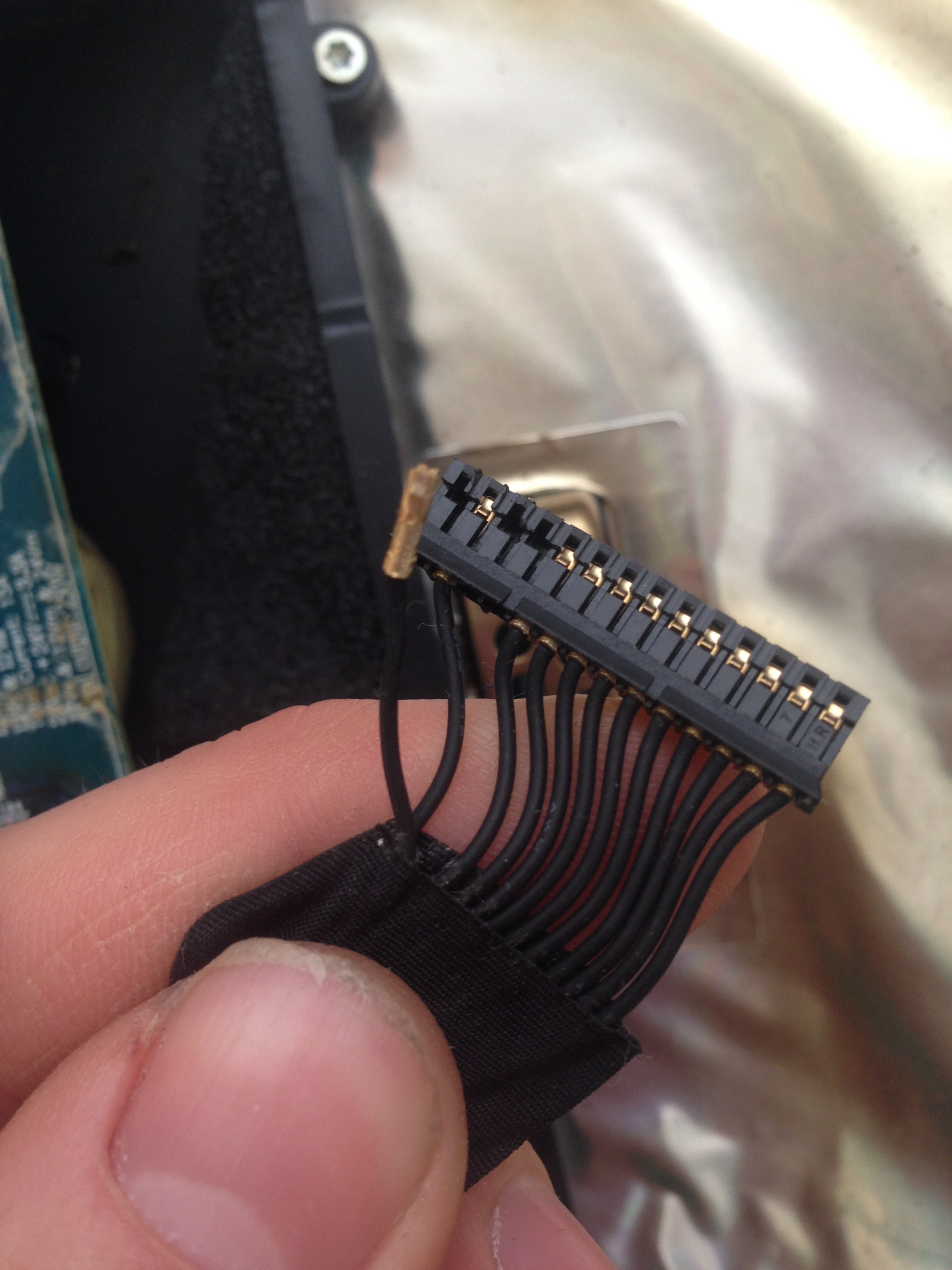

Hi, I had the same problem, so I fixed my Imac the same way. Here are 2 pictures about the fix. You need to solder one end of the cable to the resistor next to the third diagnostic led, and the other end to the inverter board cable. I just unplugged carefully the second cable( this is the on/off) from the psu side of the inverter board cable, and attached it to my cable with a pin from an old connector. I hope that helps.
The picture about the connector is the wrong end of the cable, but the other end is similar, just there is no gap between the 2. and 3. cable.

Thanks for the pics they are very helpful but I still have some questions. I understand that we need a wire from the resistor below the 3rd led. Any side of the resistor in particular this needs to be soldered from? Also once I've done this, can you confirm what wire on the inverter cable is the backlight enable wire? As I will need to feed the wire from the 3rd led resistor into this cable (also is it on the inverter side or psu side?) Also, from there what else needs to be disconnected from the logic board so that the GPU isn't fried? (donmoron's 2nd comment on the thread). Sorry for all the questions. I think it would be really great if you or donmoron could write up a full step by step or ifixit piece? Many Thanks.

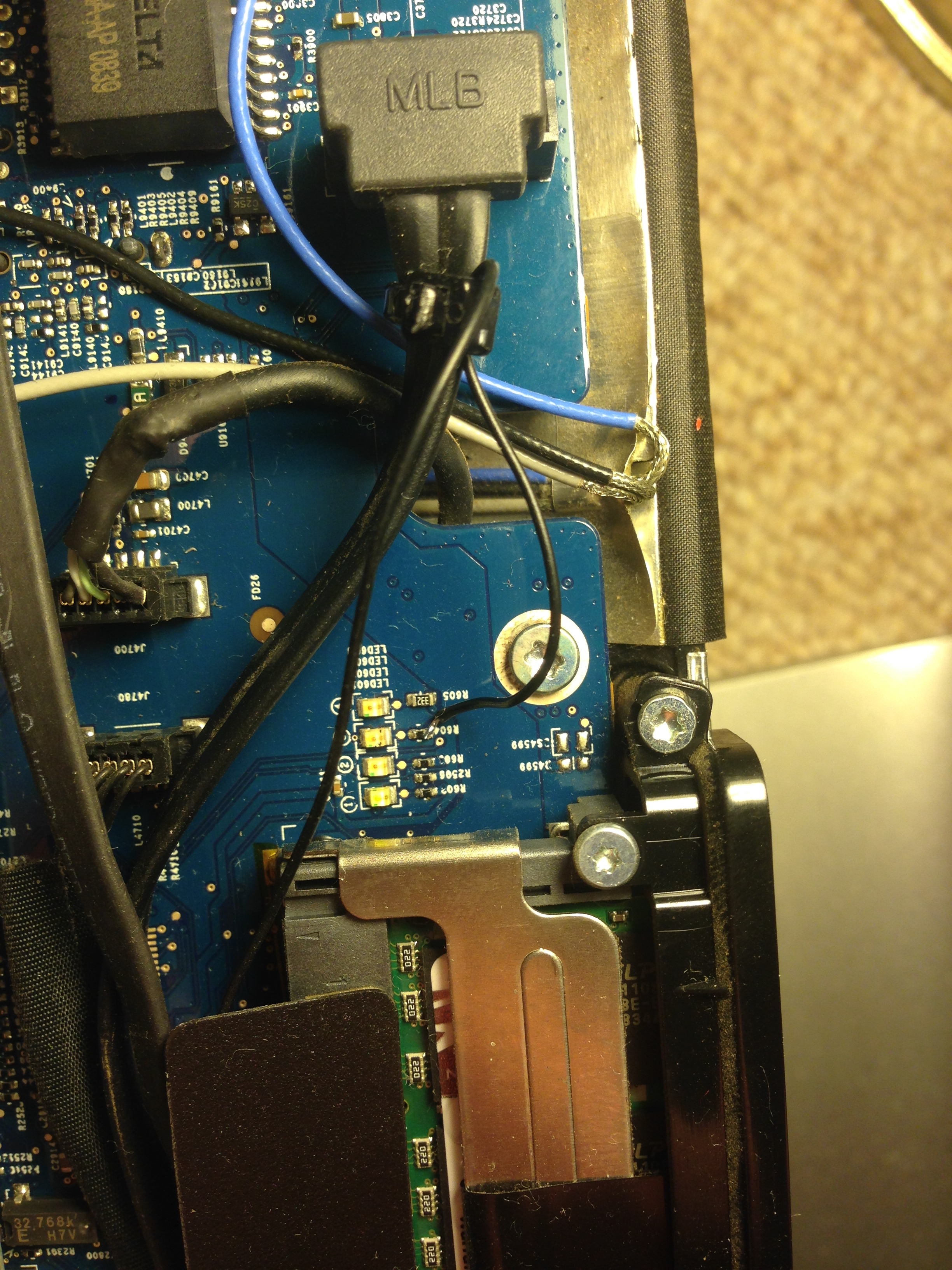

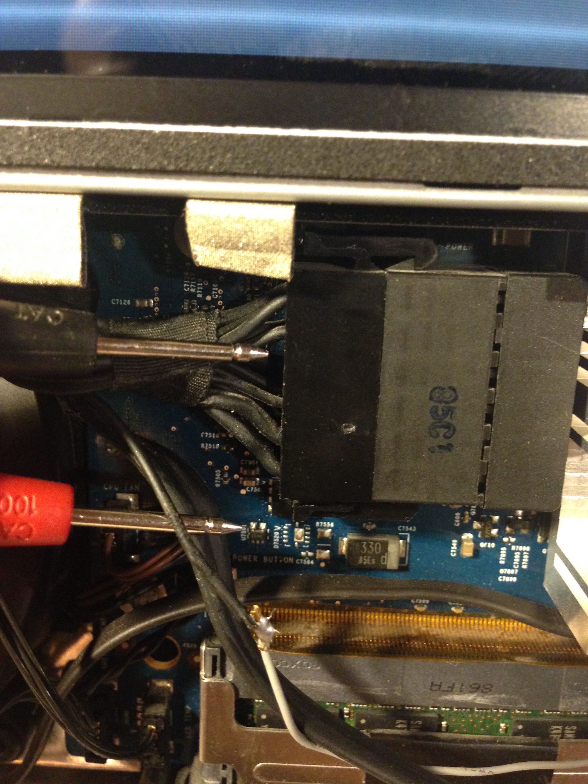

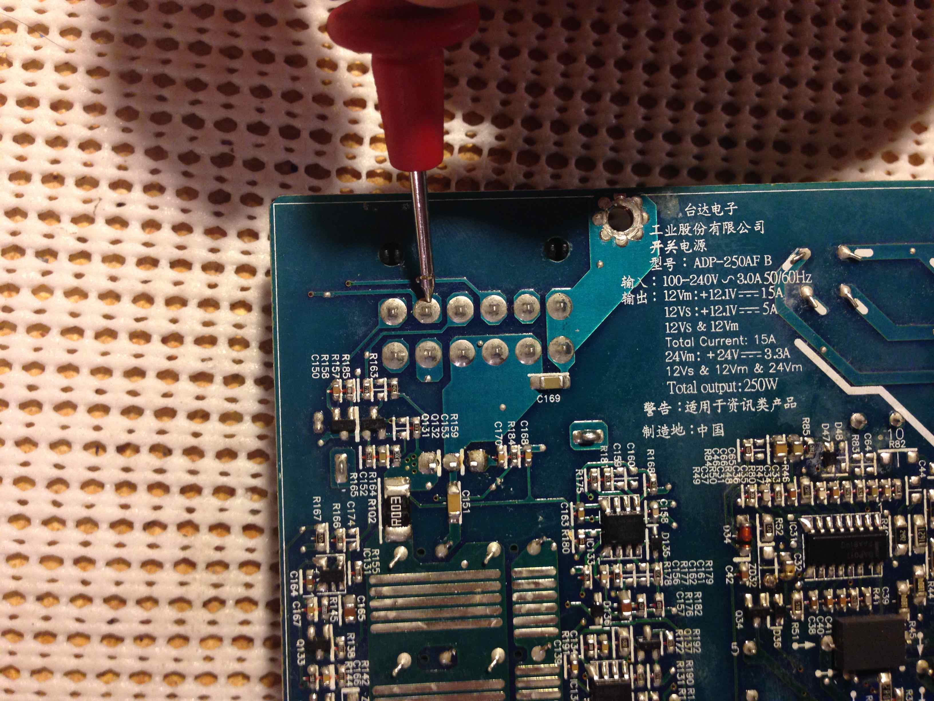

So just a heads up, this worked PERFECTLY. My client was really concerned about the enhanced cost with a new graphics card (the apple fix). I actually used the built-in harness which I pinned across from aforementioned replies. Ill post pictures below of the pin needed. Its actually a DIRECT line with no branching in the harness. I now have a functional display!
1) the made connection to LED #3; The 4th pin puts out 12 volts & #3 is just shy of 5 for me, was plenty to enable the backlight.
2) The section of harness (black lead) and the wire (red lead) I had an old sensor lying around from a previous job which worked a treat. Dont use anything much larger than say a number 24 as its just unwieldy to get in place.
3) This pin on the Power supply is the pin that directly goes to the LCD backlight board. a direct solder here from the previous LED would also work just make sure to disconnect the other wire first!!!
