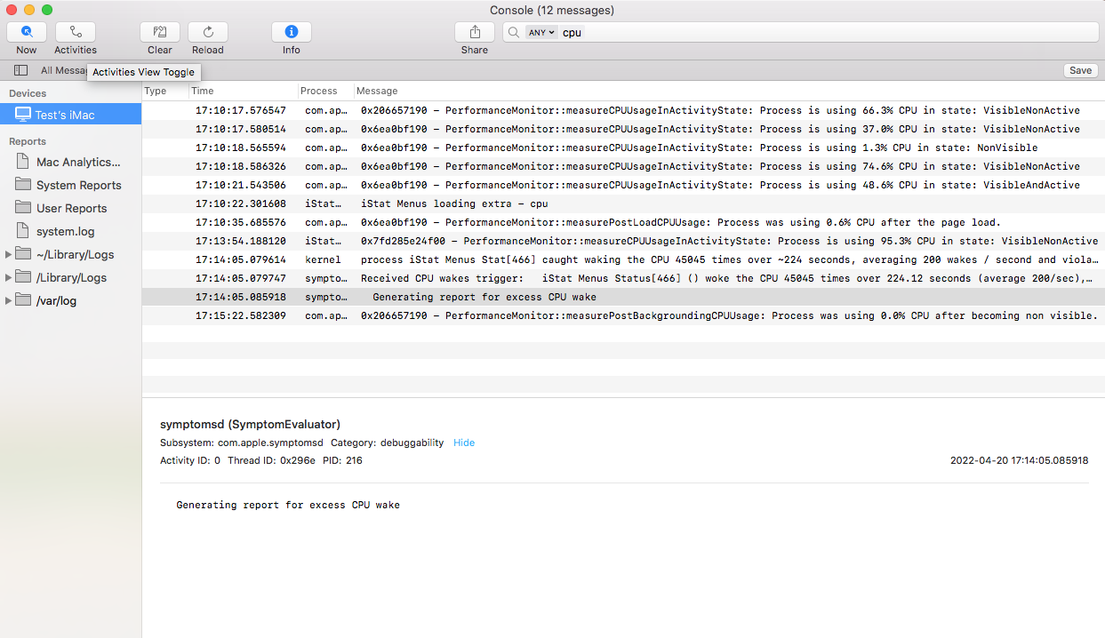

Revised and installed a Nvidia K1100M (TDP 45 Watt) flashed by David Nicks with the original MXM-A Heatsink in a iMac 27" 2010.
I used the OWC Inline Thermal Cable to attach new ssd.
Is it then still necessary to replace the ODD sensor cable to the gpu-heatsink (few apps open, reads 45 degrees Celsius).
First I installed via DosDude1 Mojave-patch, but I got a black screen (due to wrong .kext drivers I presume).
Legacy Graphics patch avoided.
MacOS installed High Sierra 10.13.6 to test the configuration, runs alright, but there are issues:

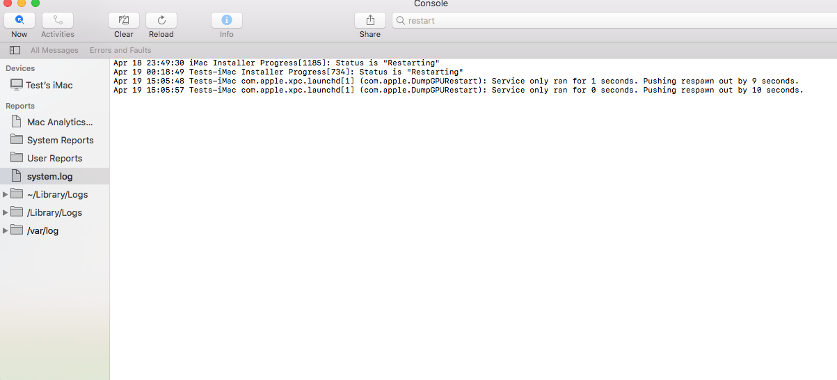

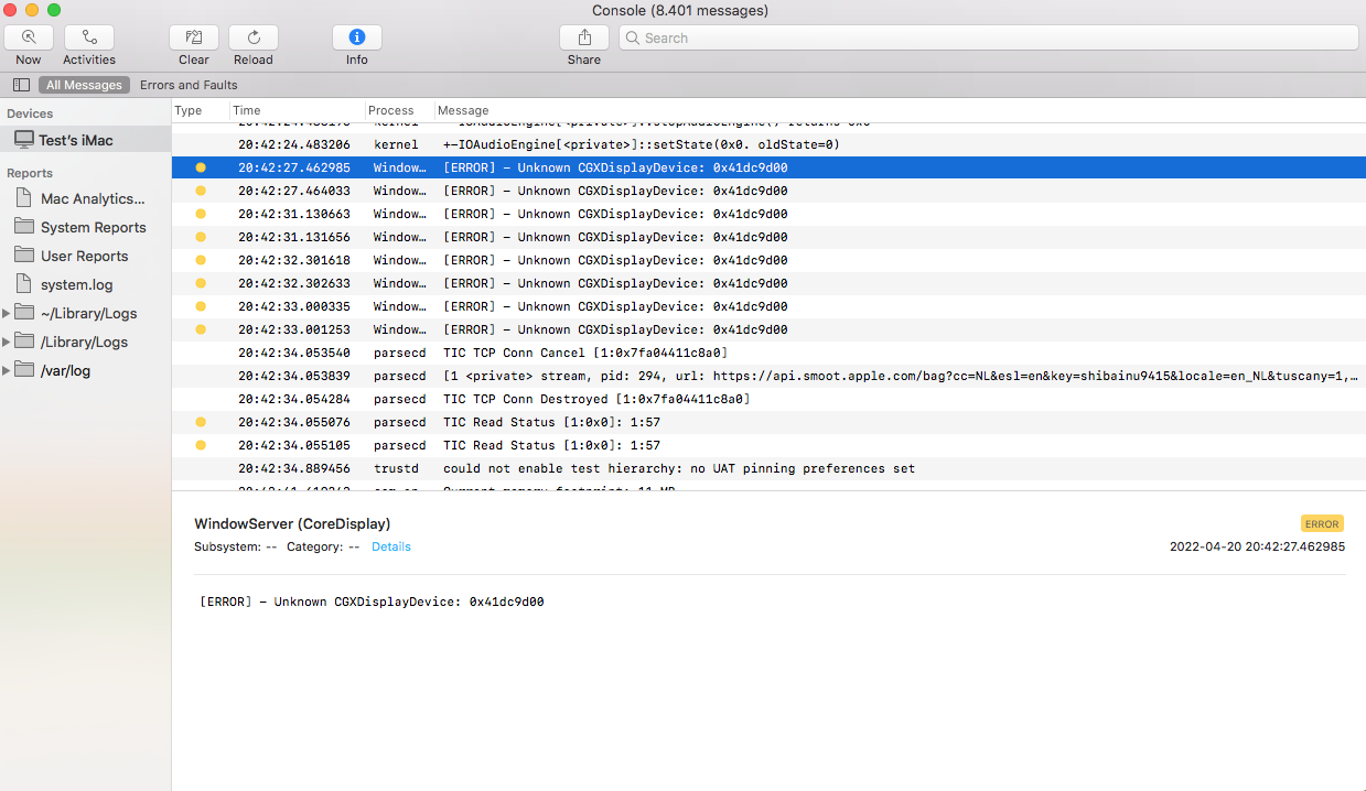

- random restarts (see screenshots form Console)
- hangs in sleep.
is it possible that via OpenCore (Catalina and above) these problems are solved ?
Hope for some insights to get the system stable ?
Greetz, Arnoud

I remember reading in this forum one post in which the poster confirmed that OCLP installation fixed this issues with dosdude1 patch.
I myself only used dosdude1 patch to install Catalina on my iMac 24" early 2009 (original config).
With the K1100m on my iMac 27" late 2009. I used OCLP right from the beginning. No problem at all. No need to move the thermal sensor.
