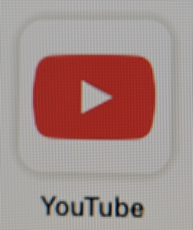

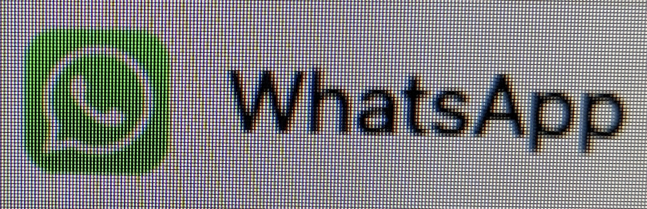

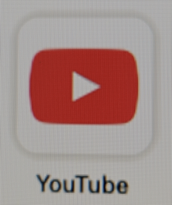

But with newer versions of macOS like Big Sur, Ventura or Sonoma that I've successfully tried just in few clicks via OCLP I've got fuzzy, blurry and distorted images. Mostly it noticeable at small colorful icons. For example (sorry for photos, it's very hard to catch it on camera):

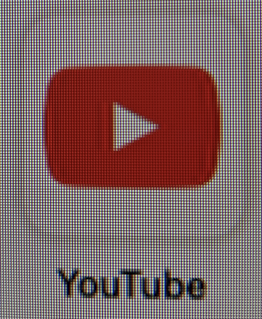

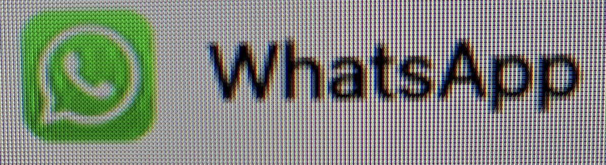

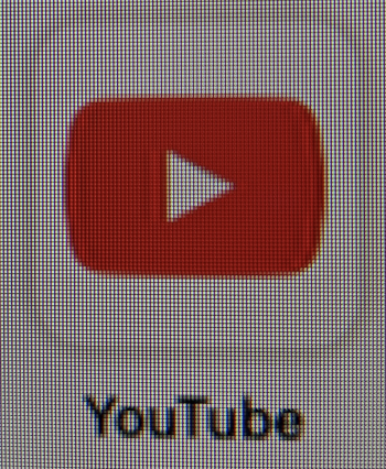

And how clear it looks in native resolution:

Due my visual acuity I'm using it with scaled resolution - 2048x1152. In natively supported versions of macOS (like Sierra, High Sierra, Catalina) it works like a charm in terms of image quality and fonts sharpness (if you don't compare it to Retina displays).
