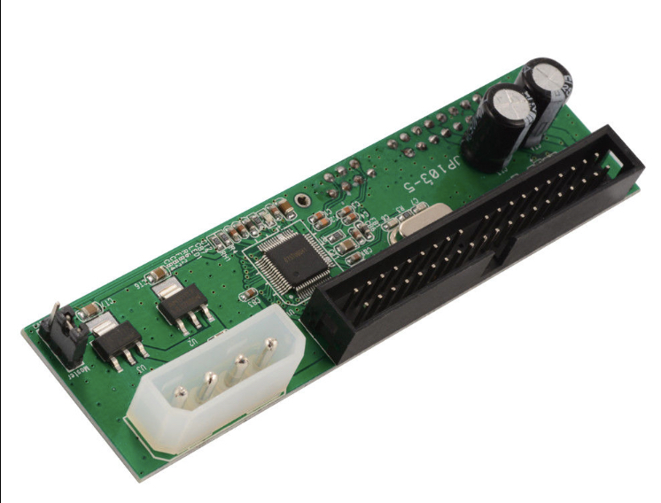

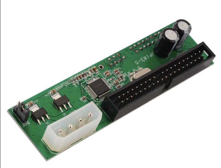

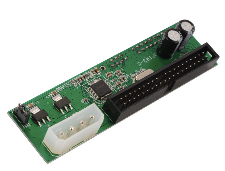

Yep, ordered another adapter with more jumper-options today (do you think, the one on the picture would be appropriate?). Hope that will solve the probleme.
But I'm puzzled, that booting did work for a while as it should ...
Hey, I'm getting one of those for an upcoming project. Wish us both luck. ;)

Yep, ordered another adapter with more jumper-options today ...

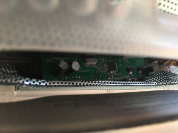

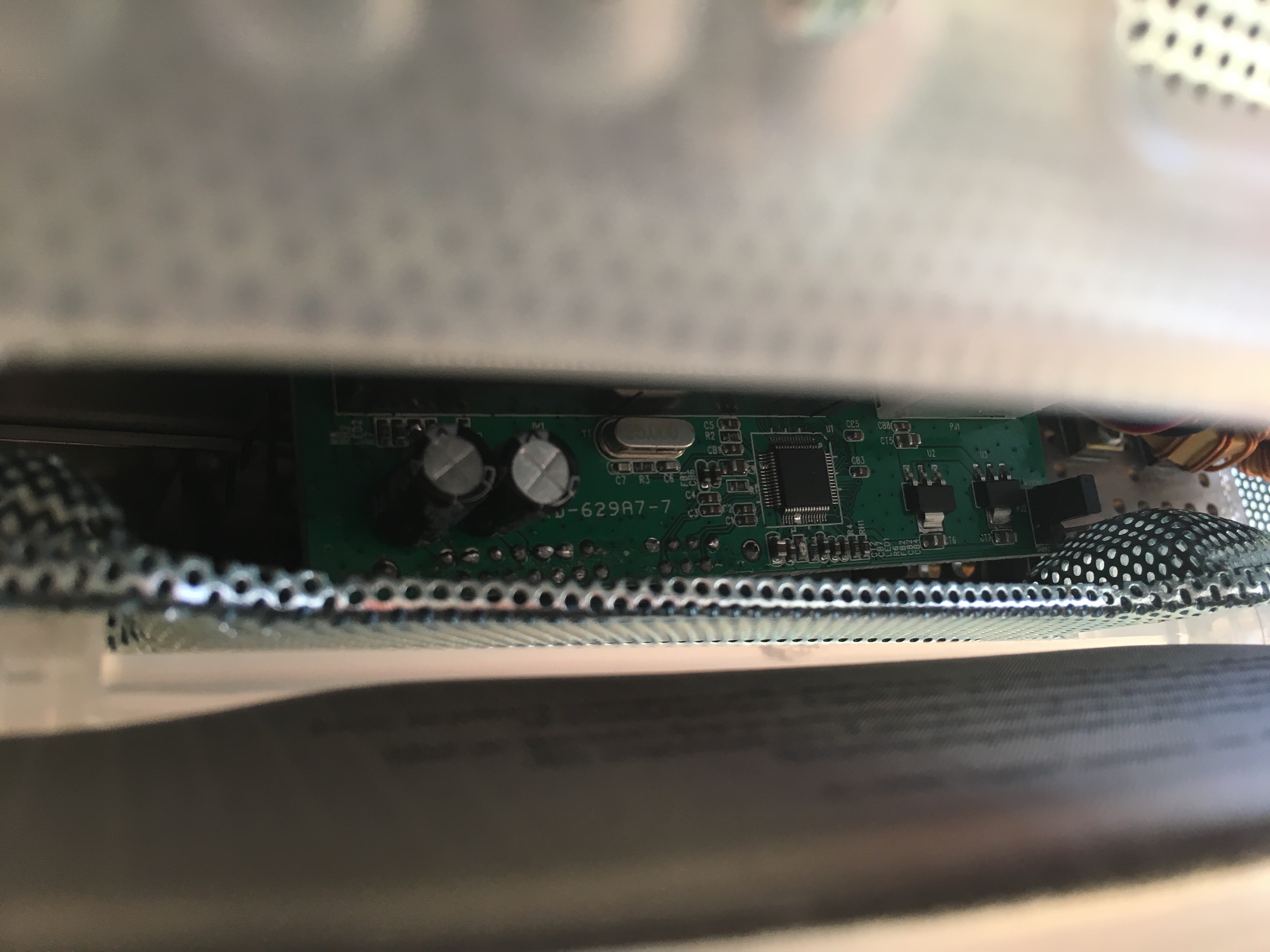

The new IDE-SATA adapter with the 3-Pin-Jumper solved the problem.
Booting into os9 does work fine now.

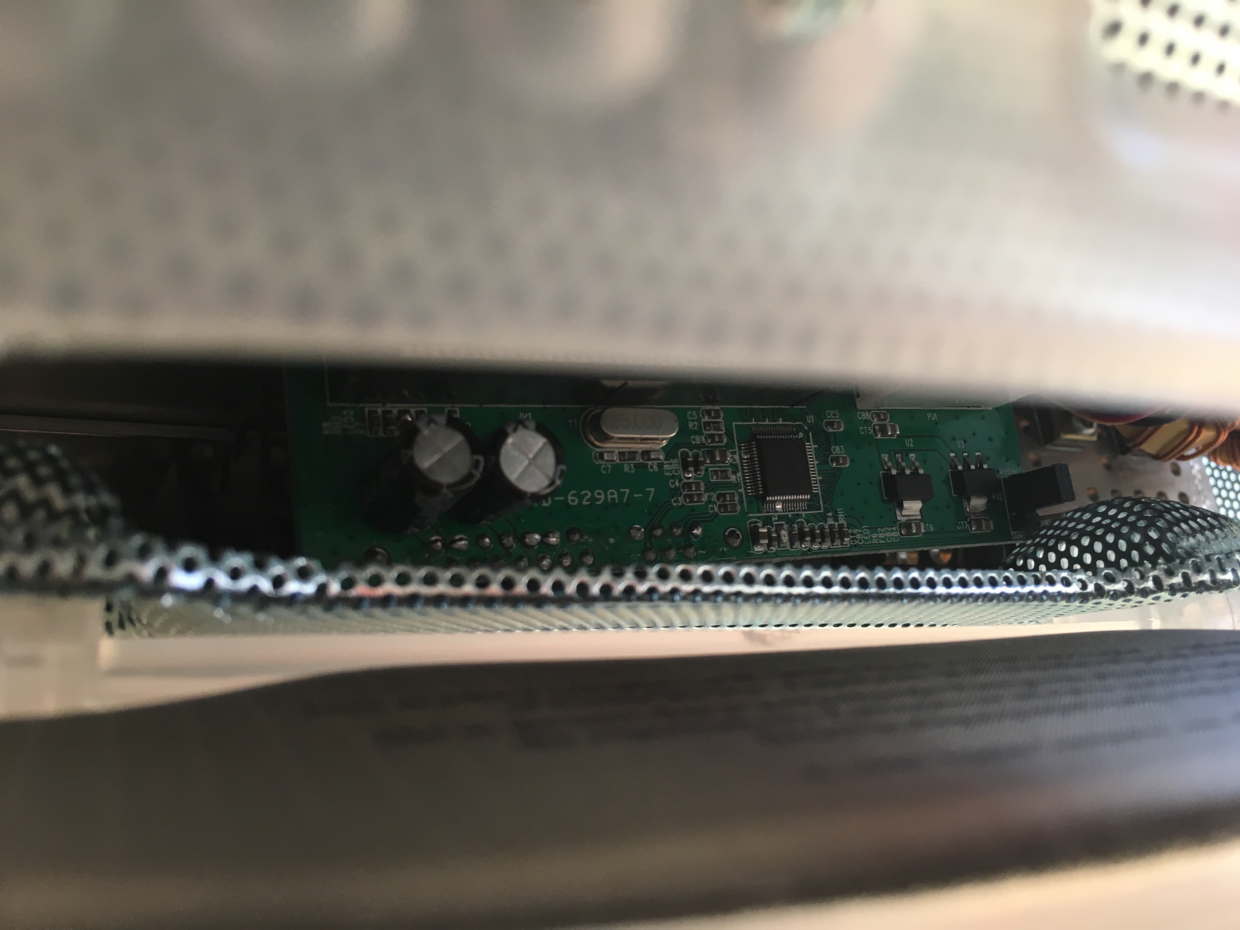

It had been a bit tricky to fit in the new-drive-adapter-combination into the iMac because there's a bulged part of the EMI-shield in the way (meant for the hinges of bottom-door for easy RAM-access) which gets contact with one corner of the IDE-SATA adapter (exactly at the location of the jumper ...) and I had to slightly reduce the bulging of the EMI-shield with a hammer to fit in everything but leave enough space to the RAM-door-hinges. Now I don't dare to open the RAM-door since the one hinge is fittet really tight and I fear to break it by opening the door with force. Instead I have to remove the complete bottom (just 4 screws) to get access to the RAM-bays...
Honestly not a big deal.
