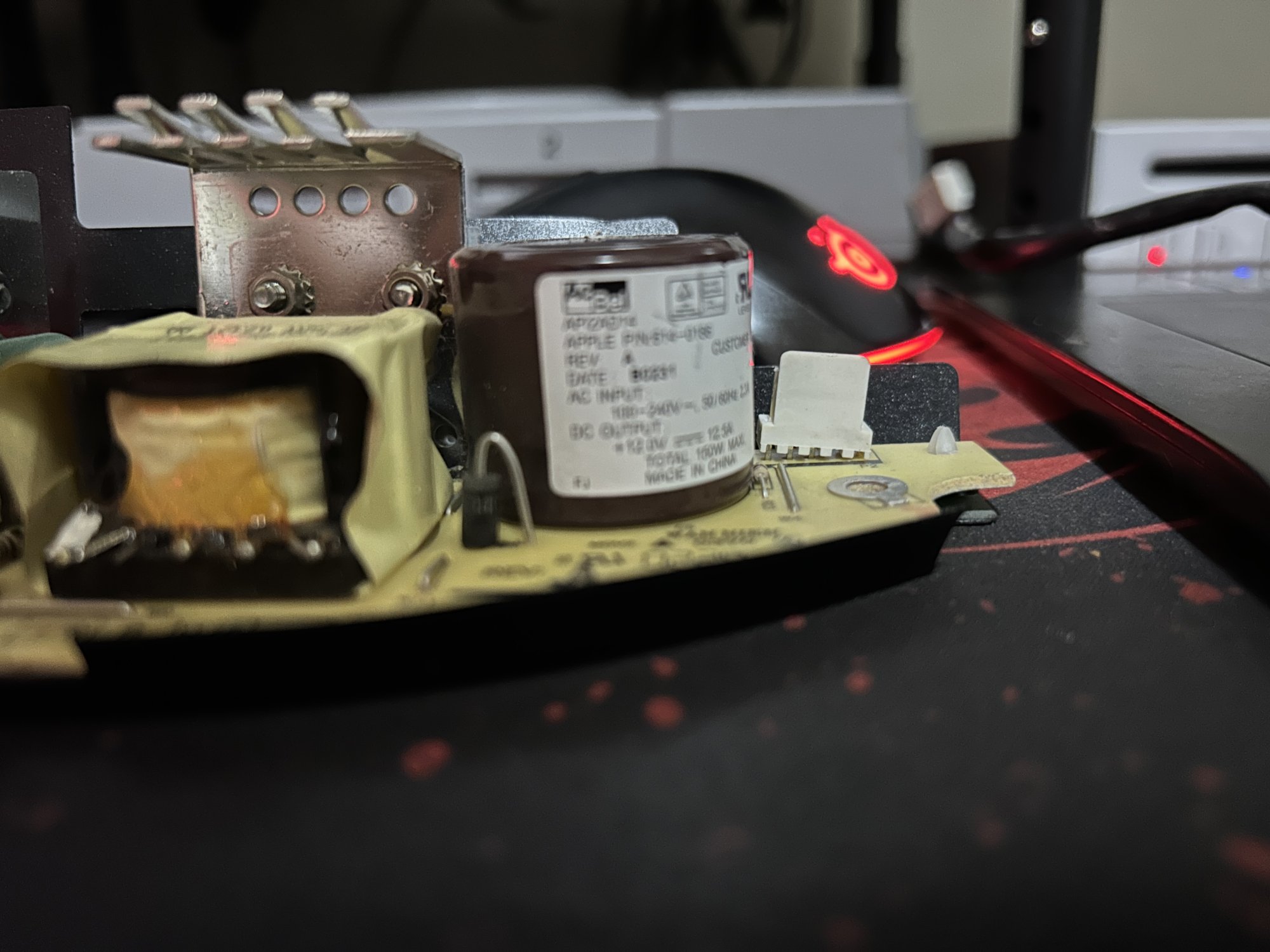

i still have some of the parts to my original imac, so will be testing out the psu as per flufftechnical's post
*edit*
well, swapped in the very first psu, buttoned everything up, pressed the power button and it chimed and booted! i was able to play around in the os for a good 10 min and no hiccups. yay!!!

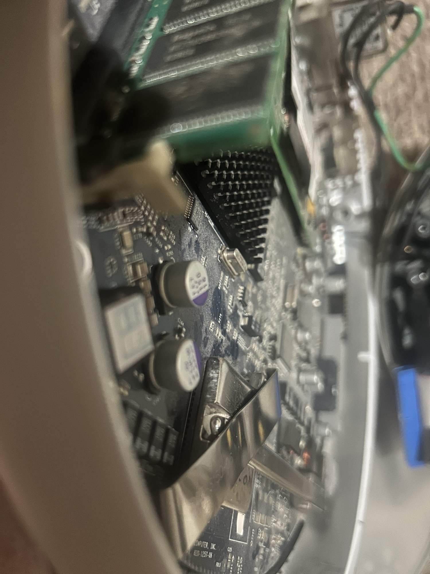

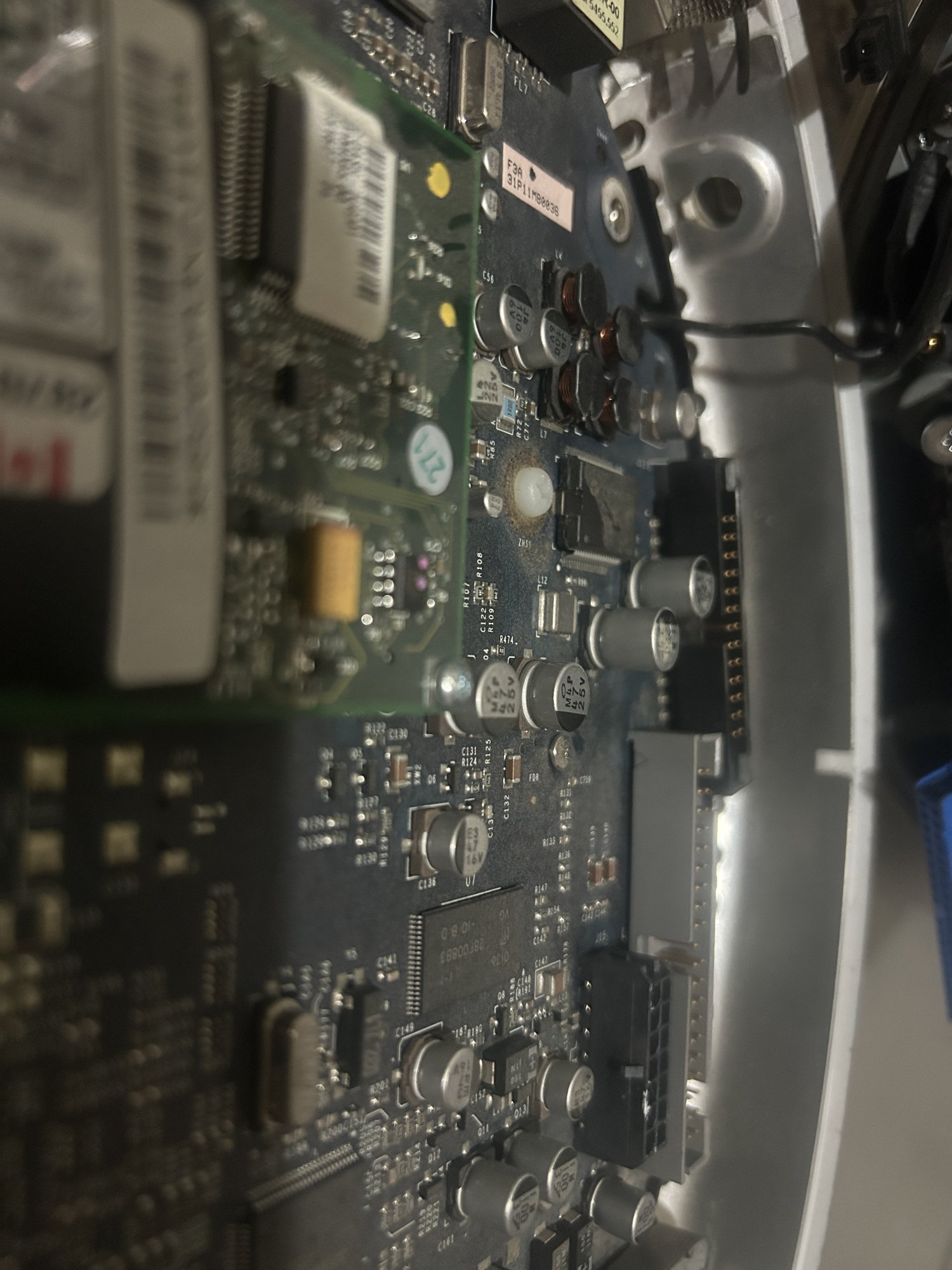

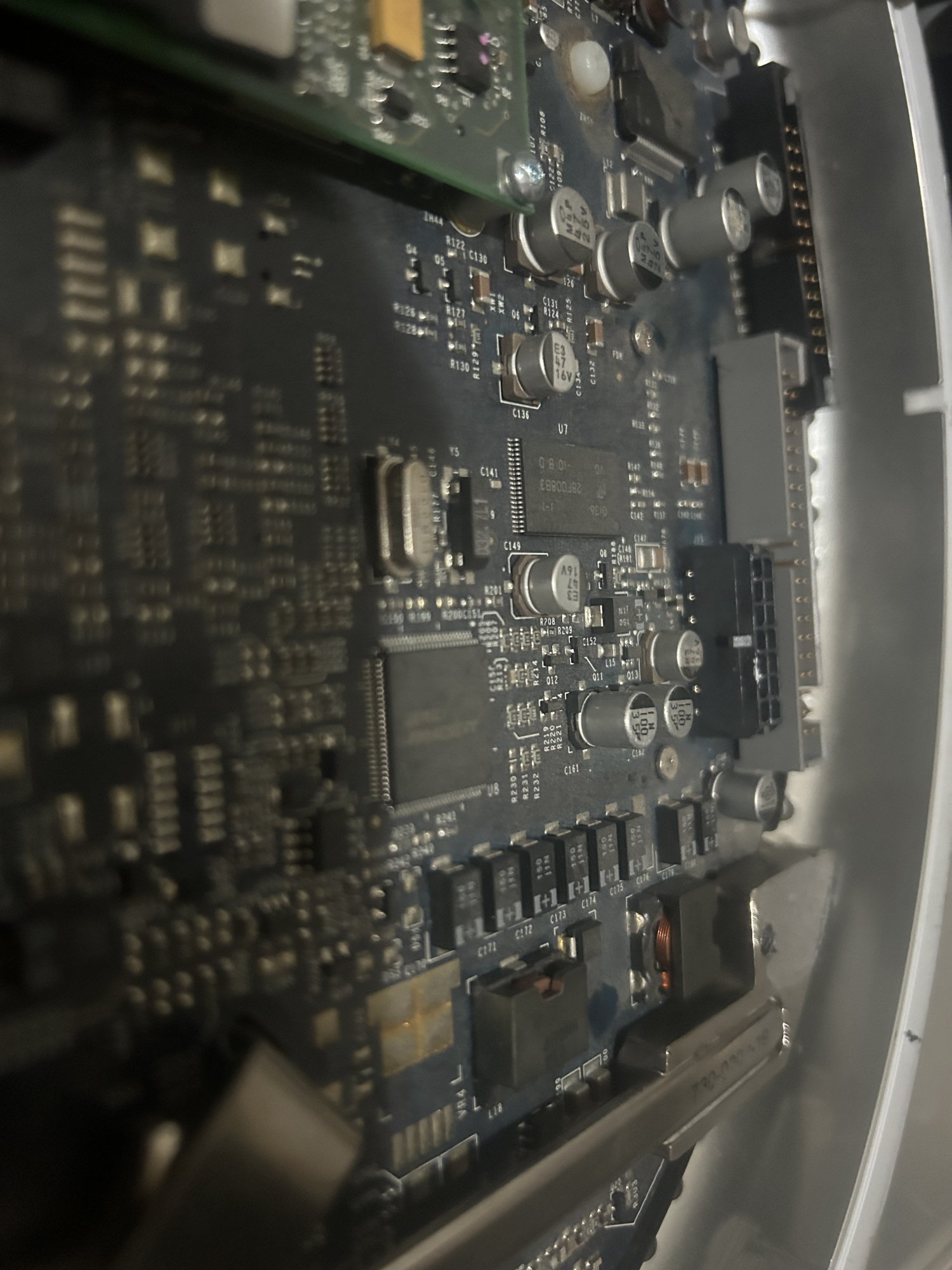

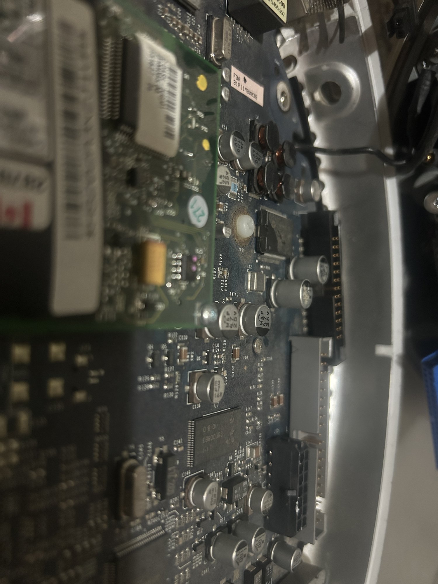

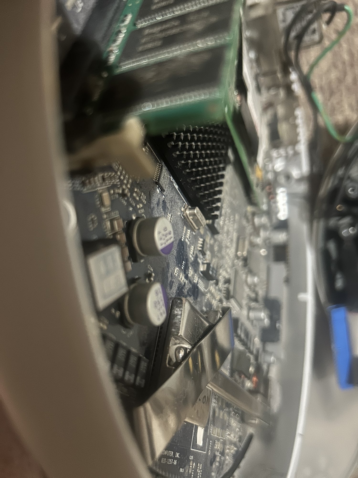

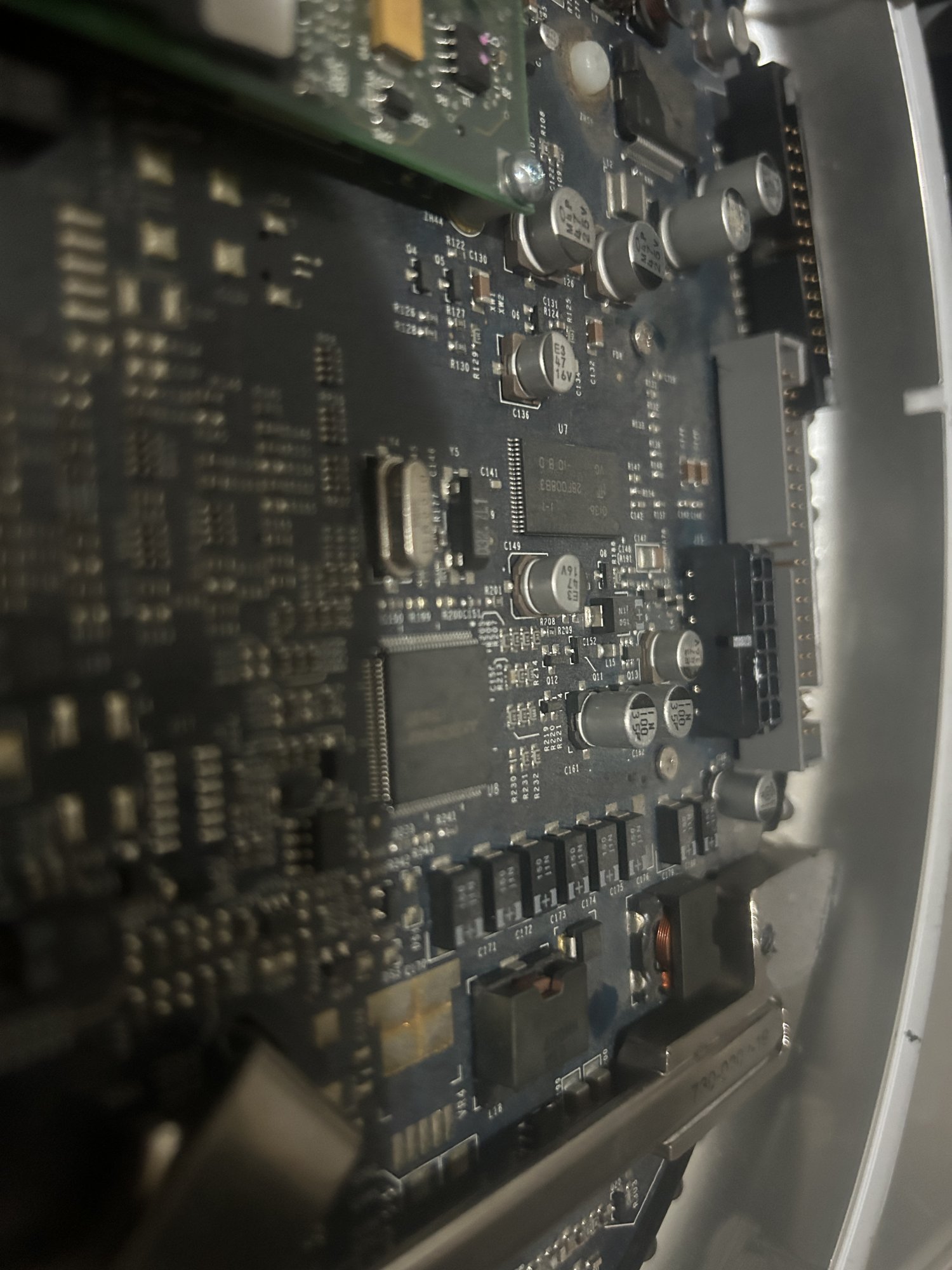

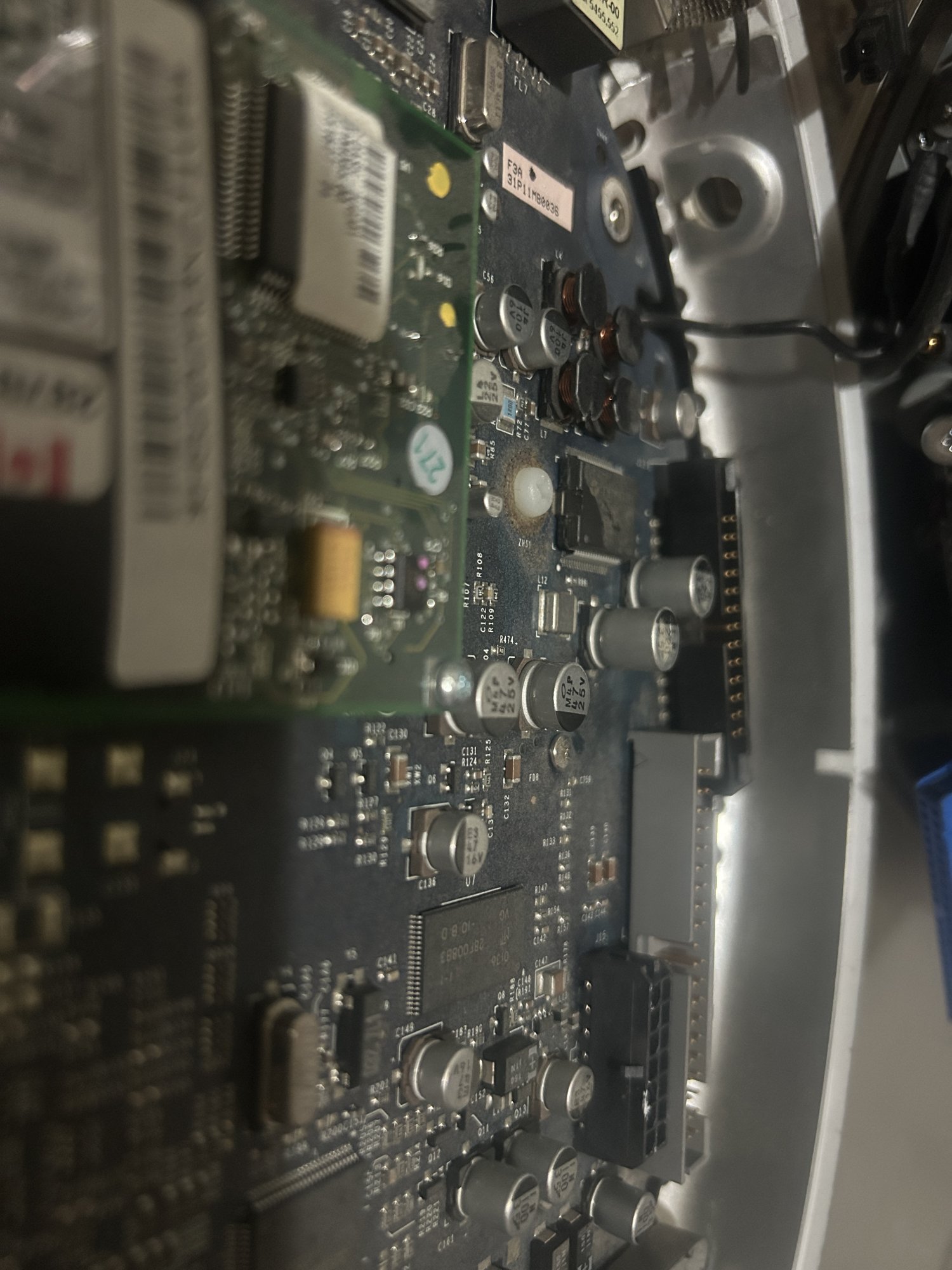

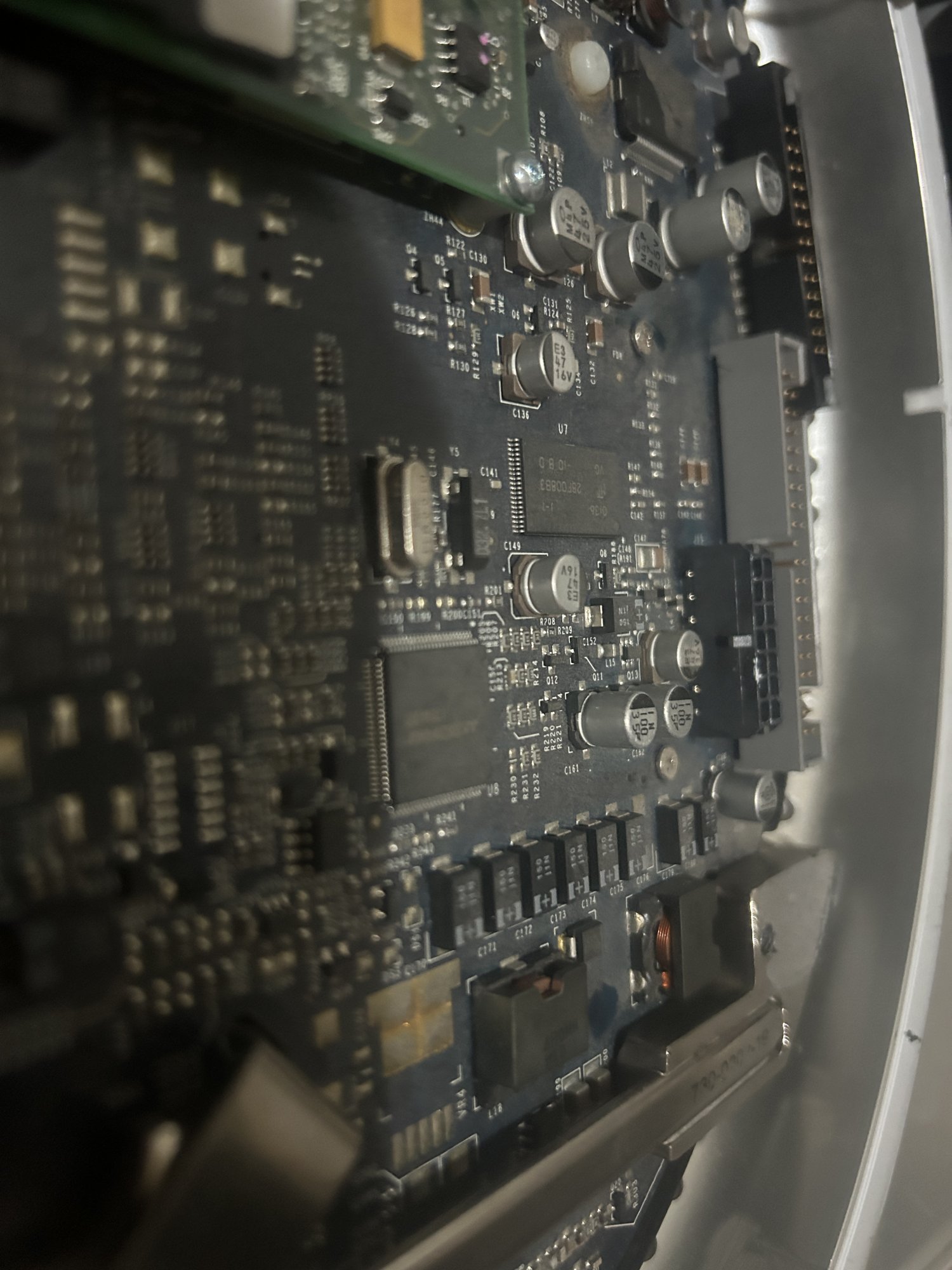

Nothing sticks out as suspicious on those logic board pictures.
You mentioned that you tried a power supply from your previous failed iMac. Is it possible that both power supplies are bad… what was the cause of death of your original iMac?
years ago, i would say close to 10 years, was the gpu on the original. it just died. i put the default psu back in this one and pressed the cuda button then power and nada.

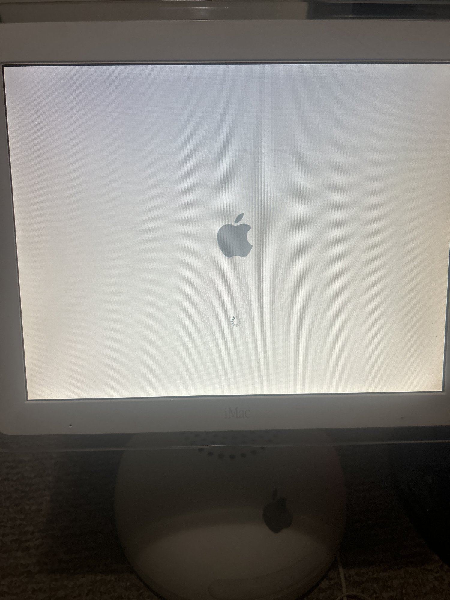

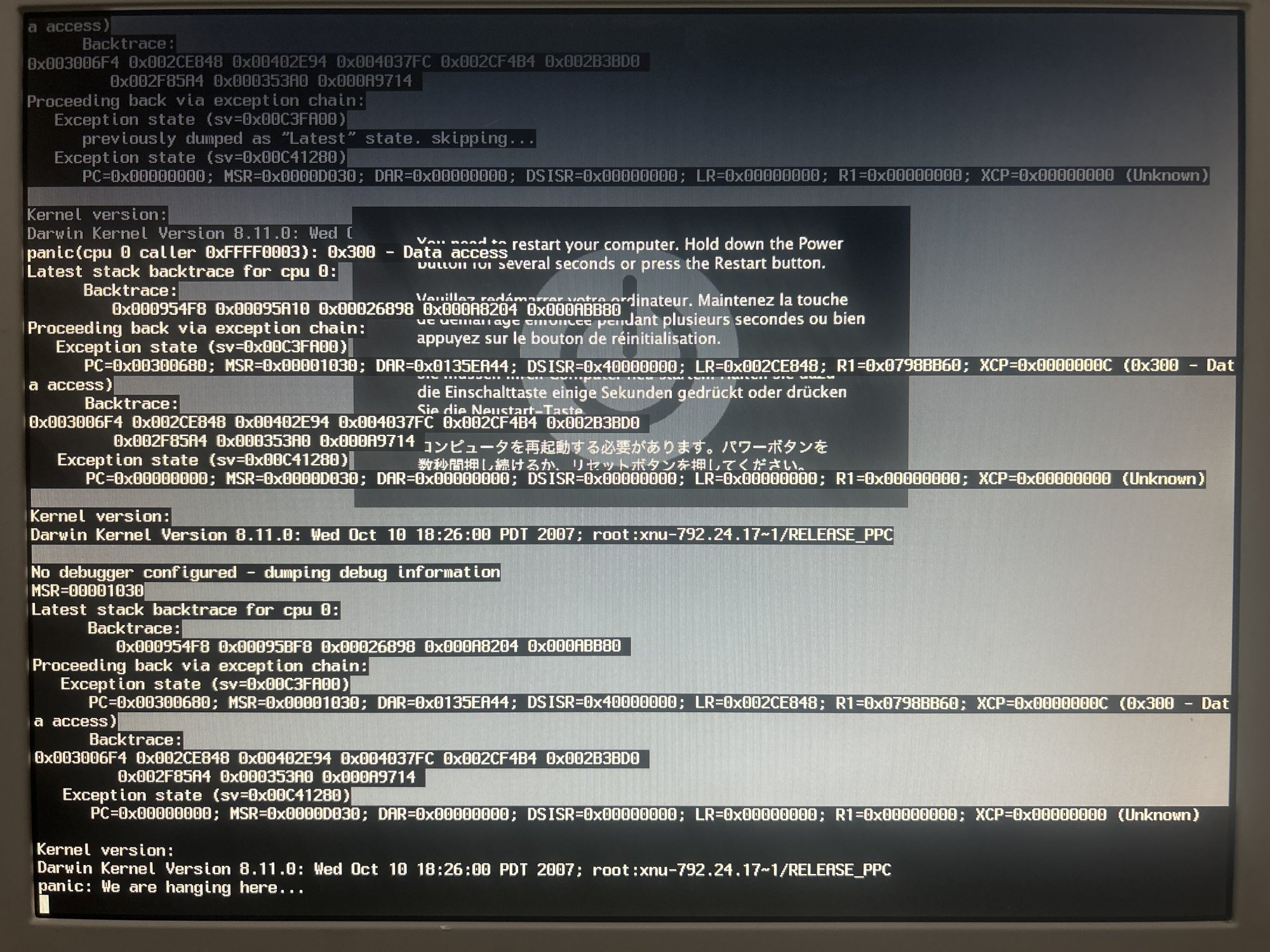

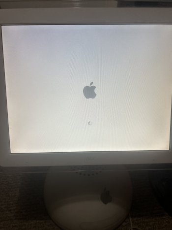

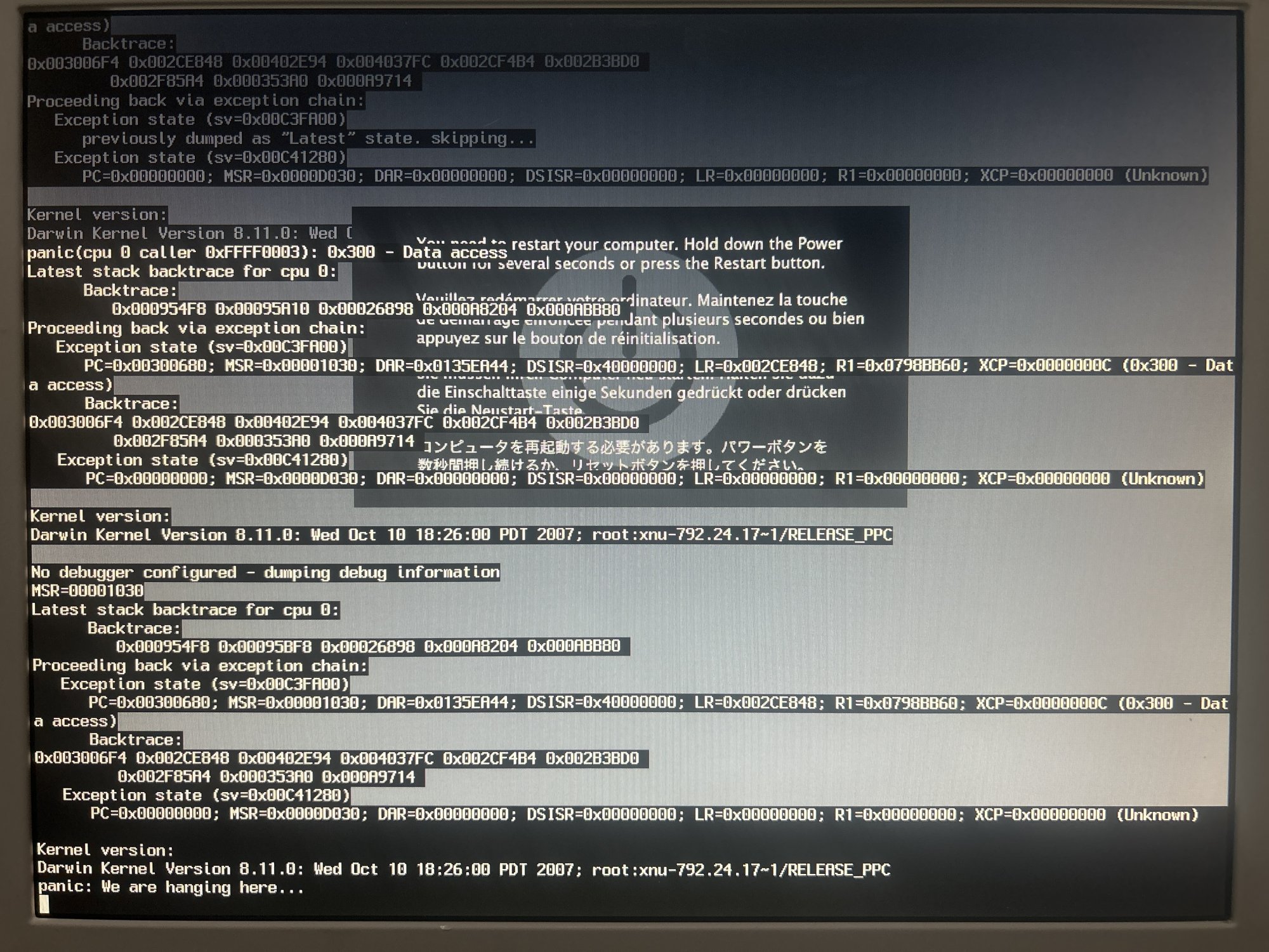

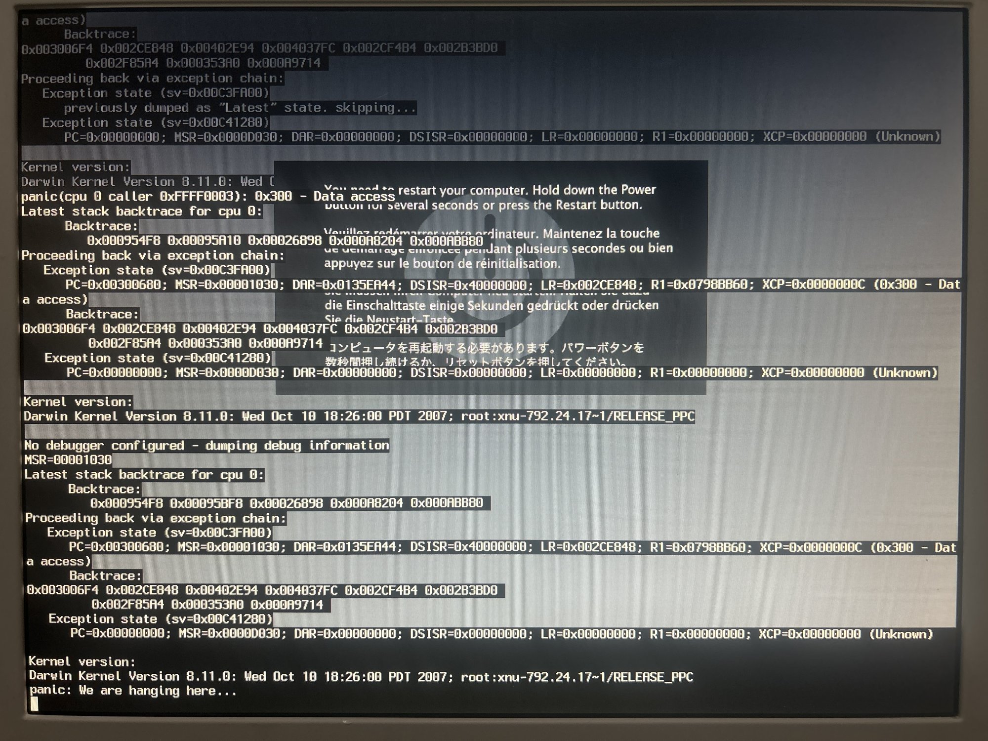

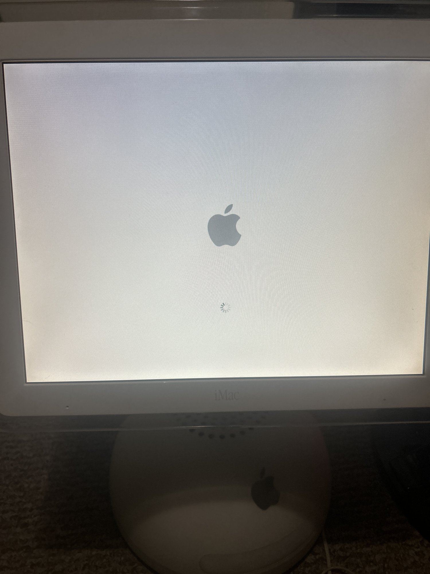

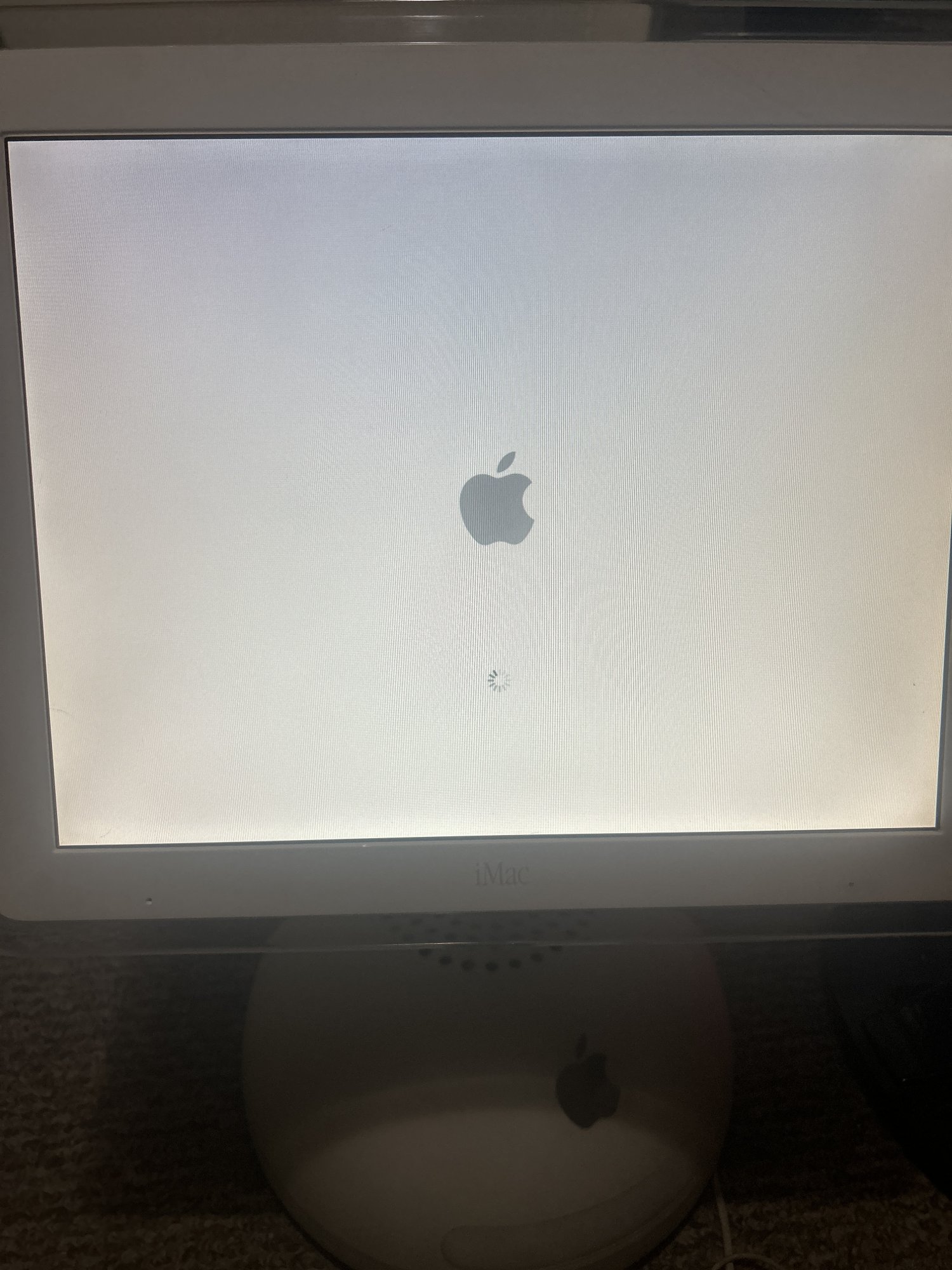

well i just pressed the power button again and now i have this...
ok, good news, i have now been able to do a proper pram reset, let it go for 3 chimes instead of it giving me 1 chime and continuing to boot on it's own, and was able to get into open firmware and reset that. it booted into osx and now as i am typing this is froze at the date and time screen
and back to square 1

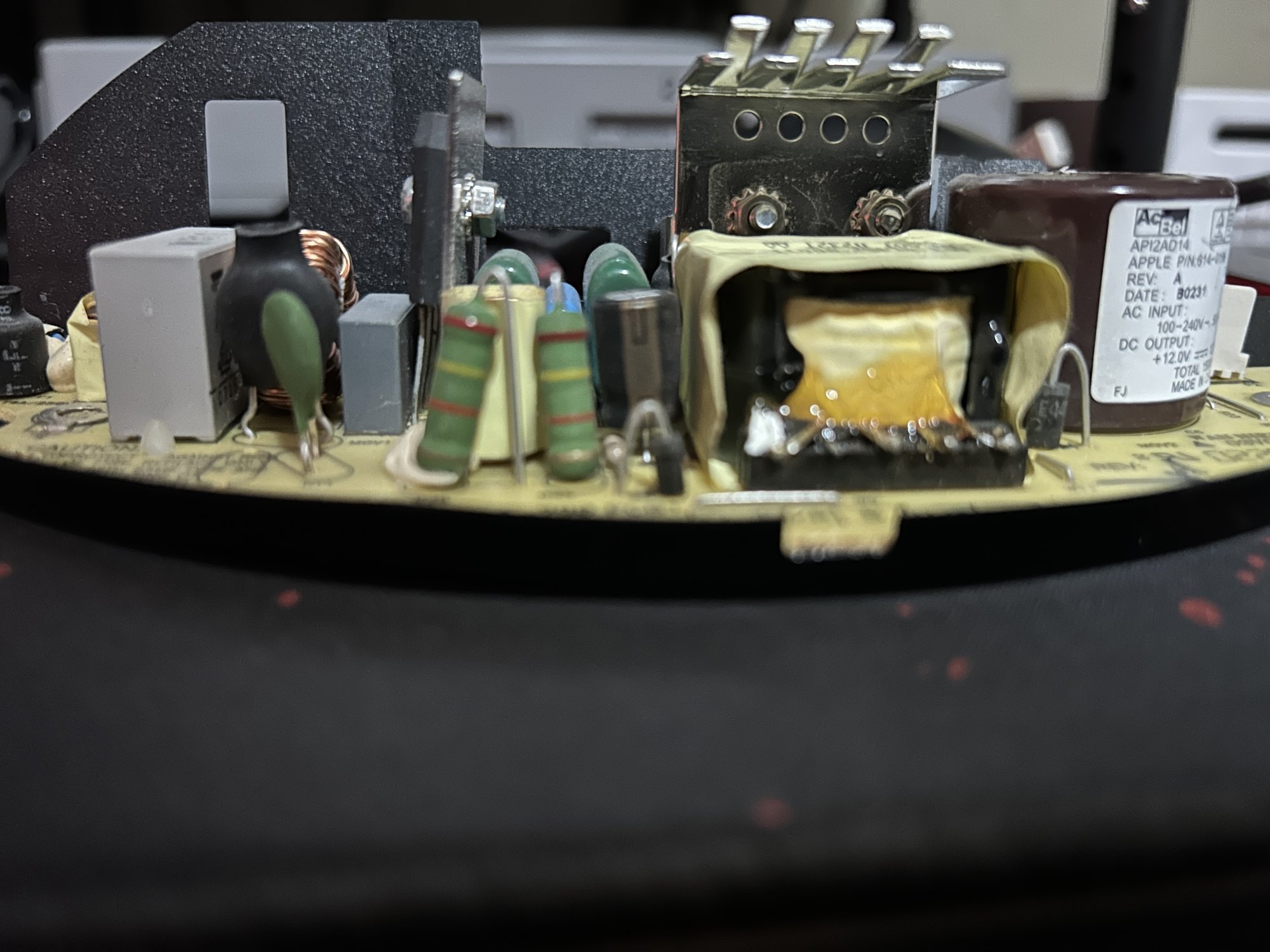

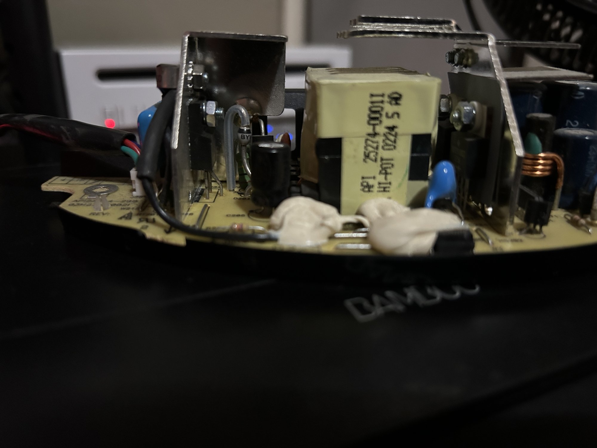

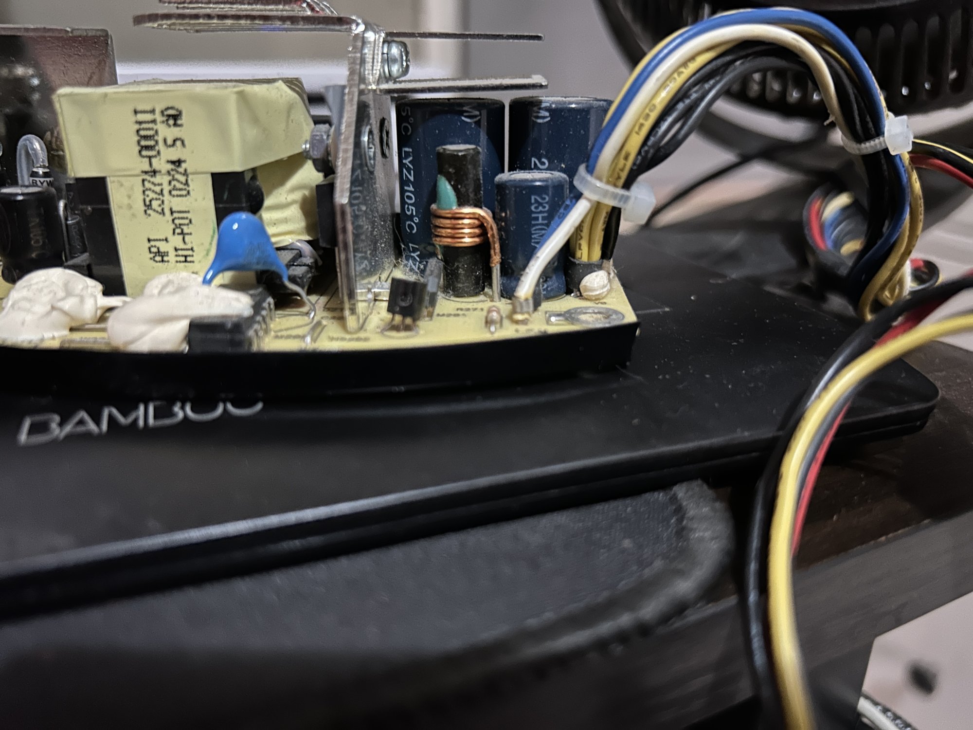

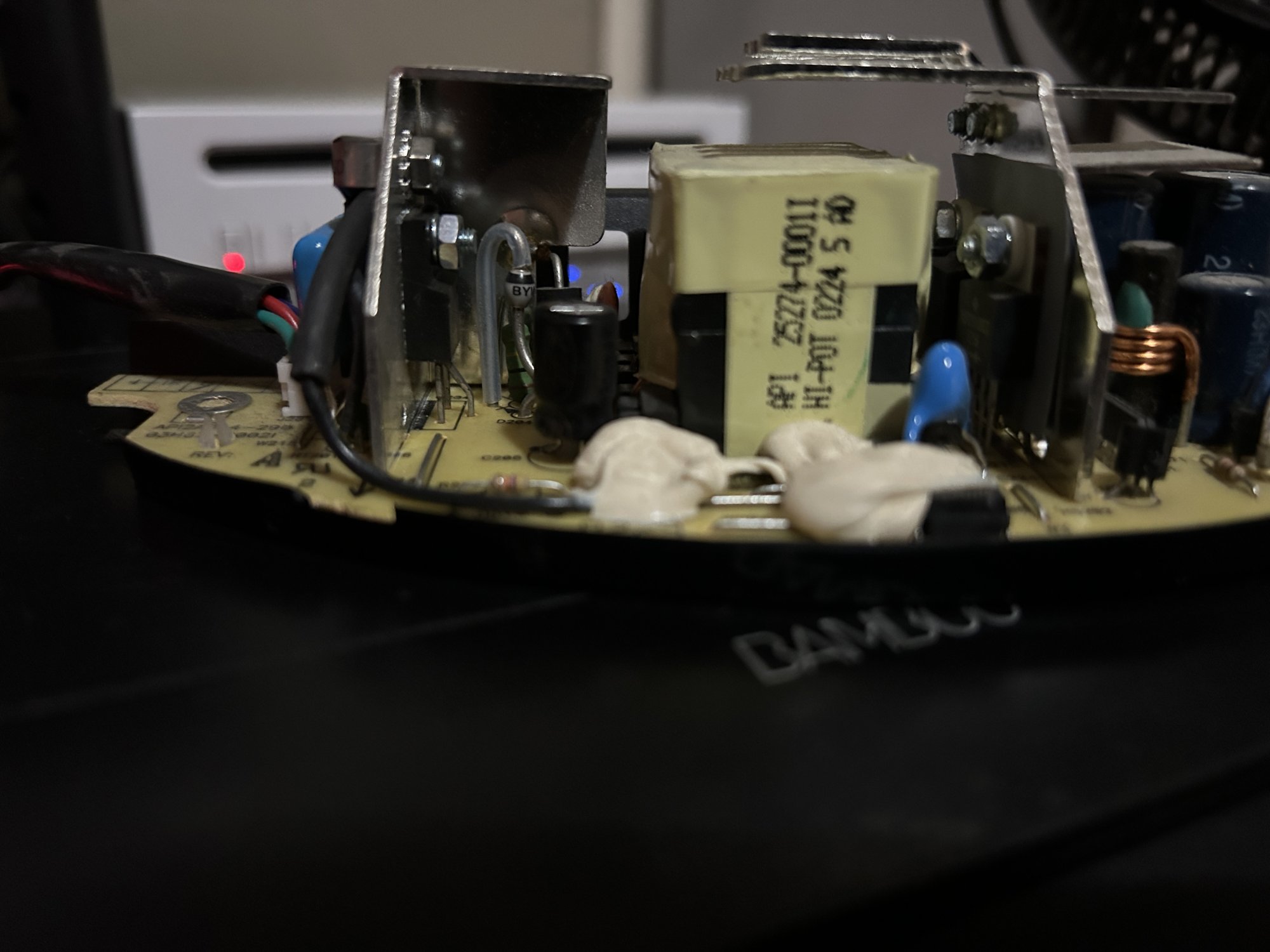

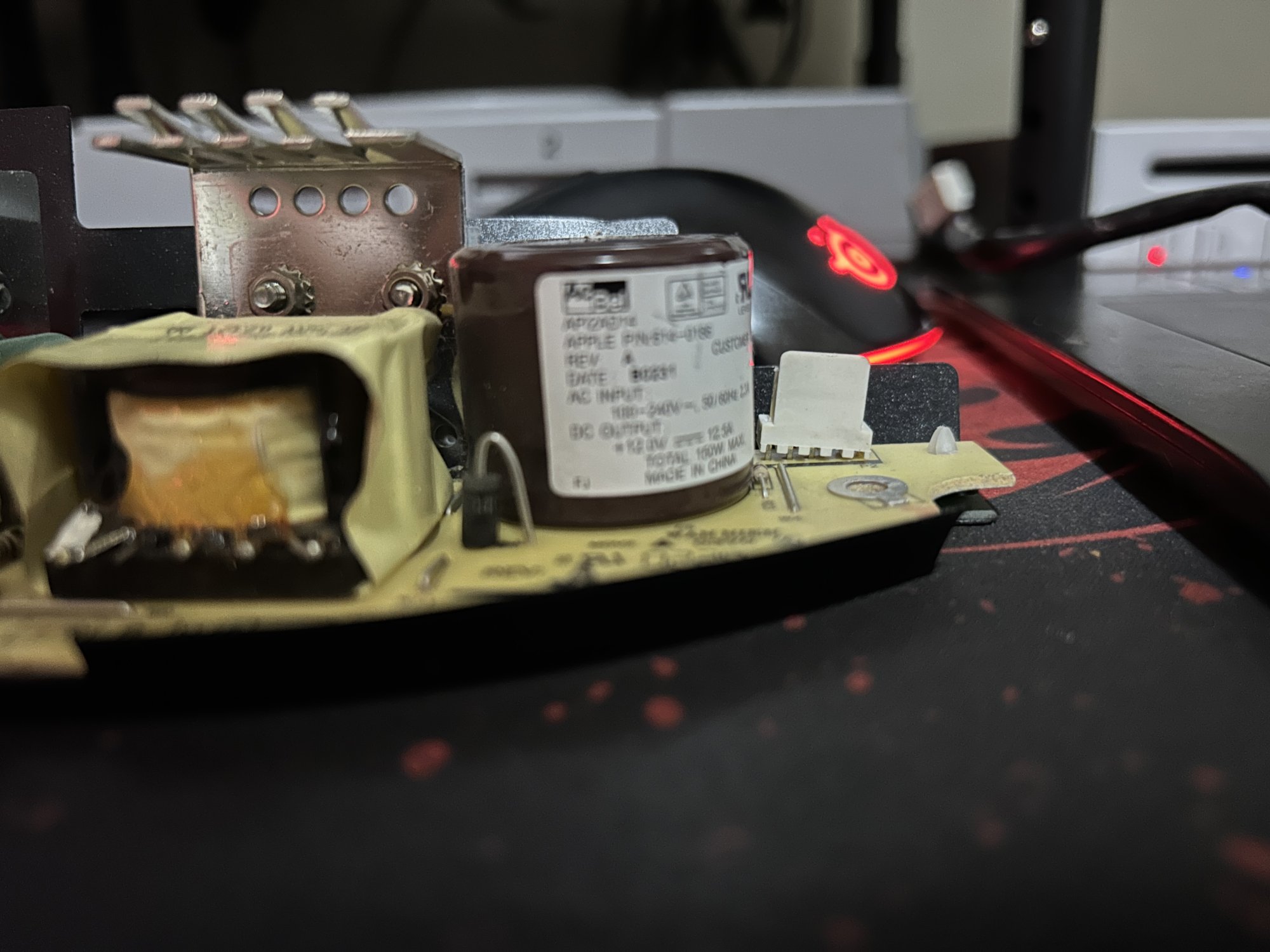

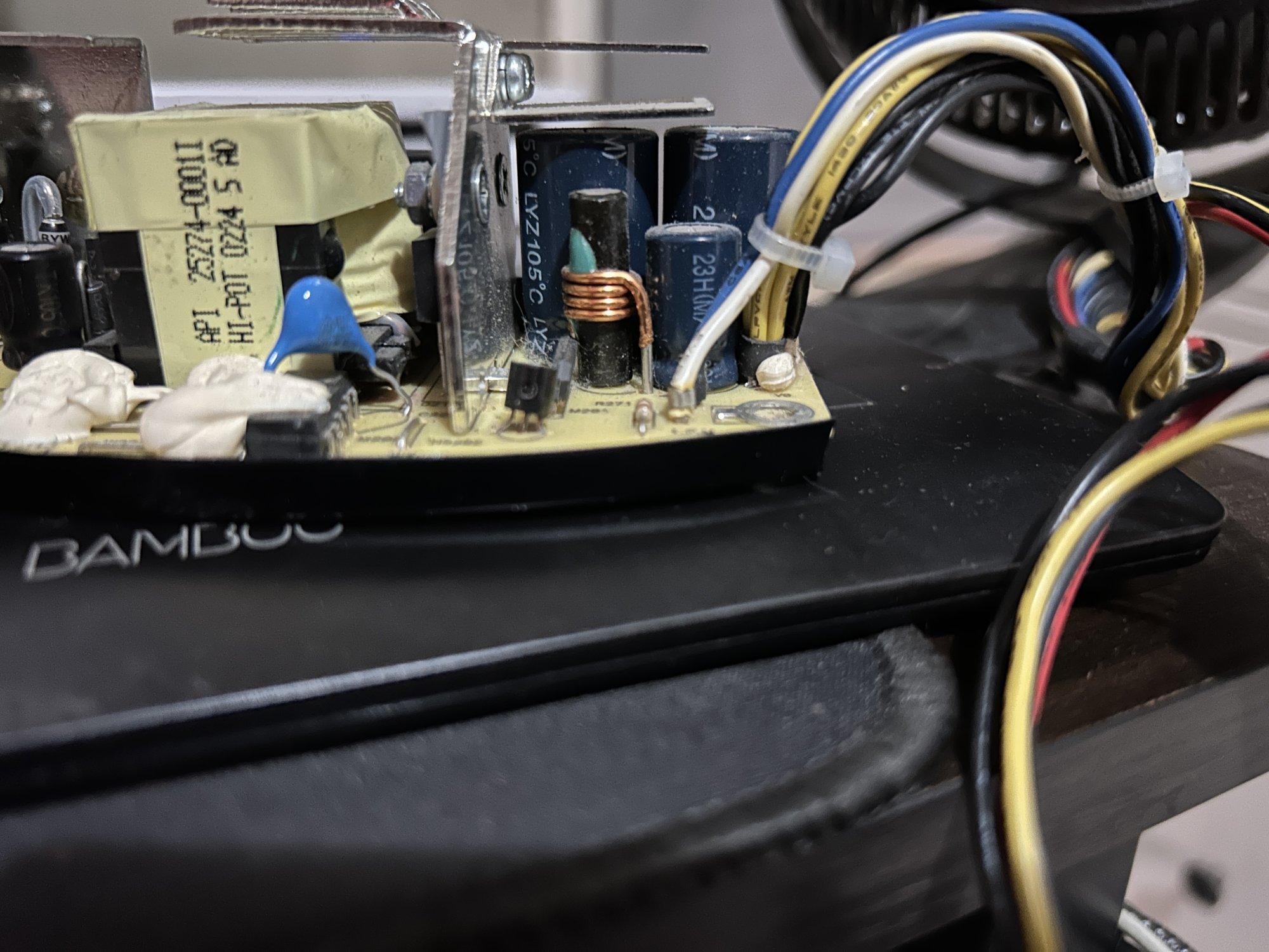

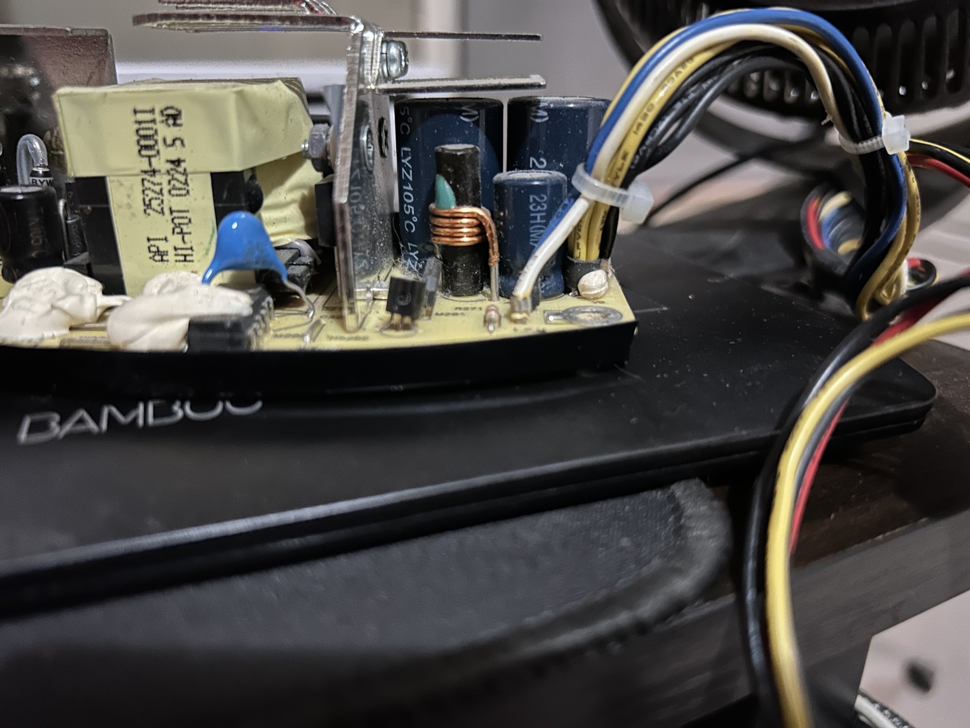

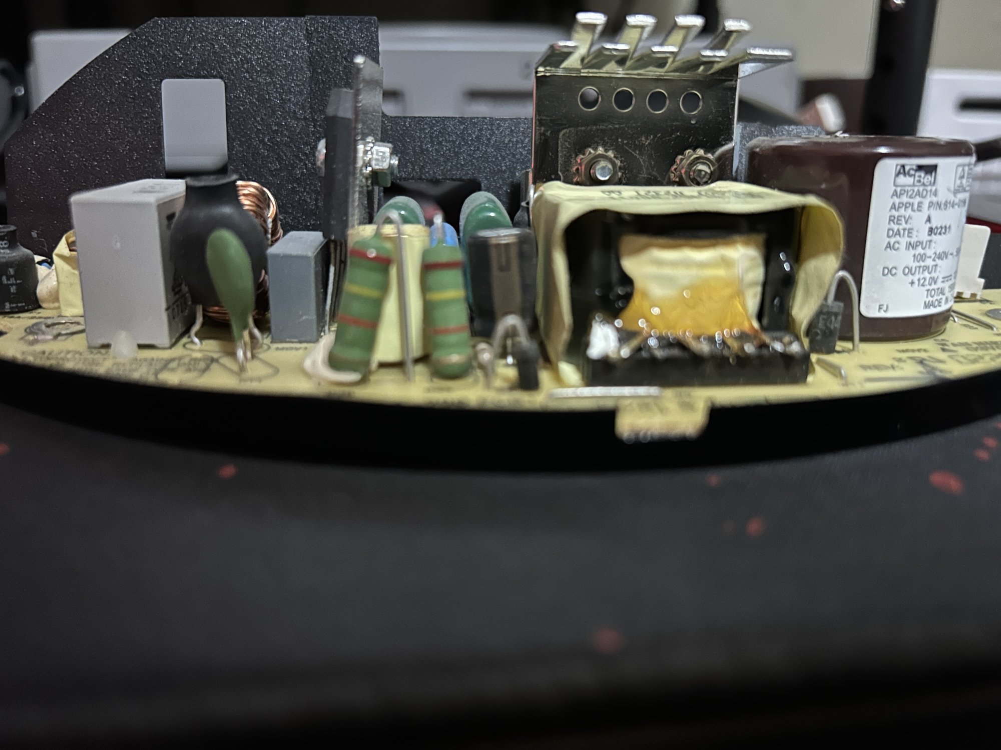

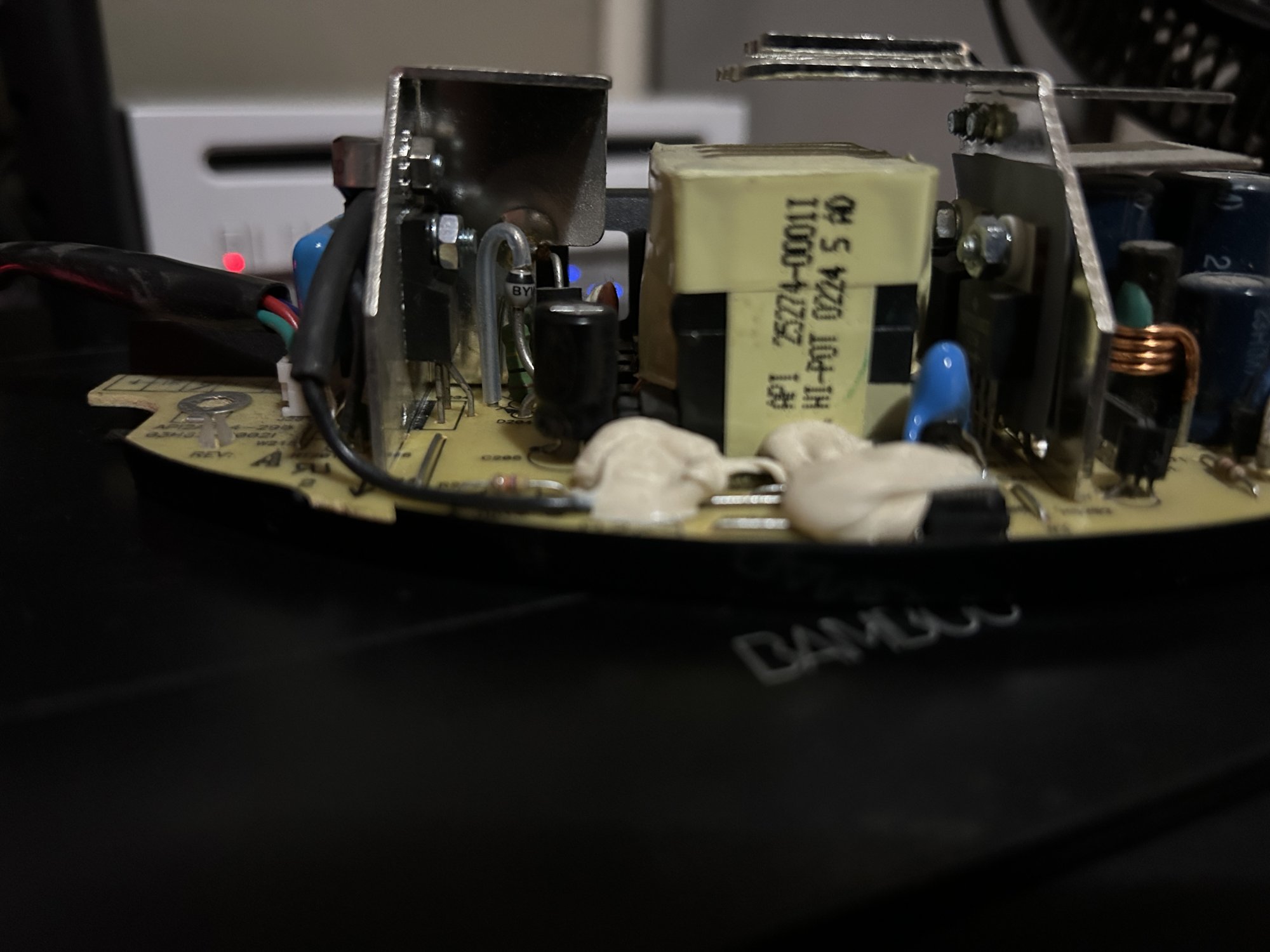

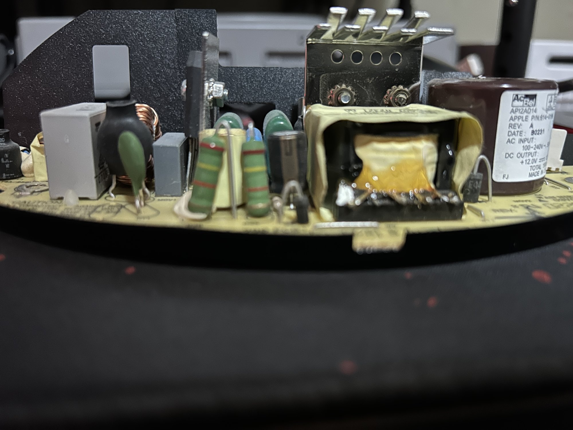

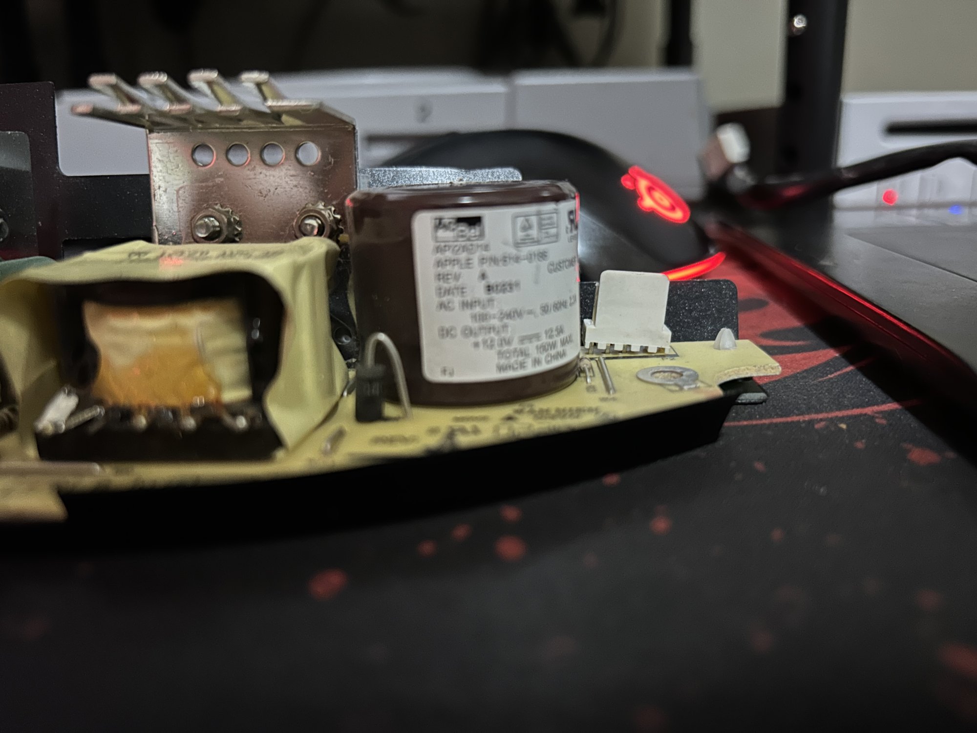

from what i am reading online from other imac owners of the 17" and 20" versions, they are explaining the exact same symptoms with their units too. they are saying it's a failed psu but when i look at the default and the original that i have, no caps are bulged, no leakiness of fluid, so i am thinking it's a bad controller chip on the psu boards
these are pics of the original from 10 years ago
