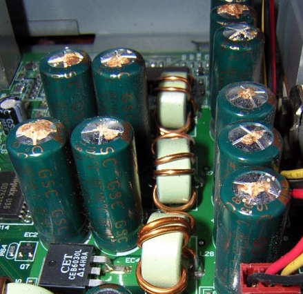

iMac g5s were notorious for bad caps. You can open it pretty easily. Have a look at the capacitors. Google for iMac g5 caps and you’ll see what they should and shouldn’t look like.

yes well known for the capacitors.It's a know problem. due to the high heat the processor goes. I did a mod for it, putting aa 12x12 noctua fan on the back which remove heat from everything including the part of the capacitors.
You should replace them quite all (which is expensive and not worth). I would do that by my own but capactiros are not so cheap (that ones).
well as always some can last all of the time, some others not...you cannot be sure...

I don’t think it was a heat problem, the iMac g5 caps were substandard knockoffs. This hit a bunch of computer companies at the same time. Some outfit stole an incomplete electrolytic formula… the counterfeit caps ended up in a lot of gadgets.
in the case of G5 mostly is heat. Try to see and touch one capacitor after 2.3 hours working time of G5...some ofthem are soooooo hot. Ususally the most they stay cool the most they go ok. ost of them are 85 degree caps, but often they can't go higher than 70 degree and a G5 processore goes 75-80 easily at max load...

Did you try connecting an external display? I bought an iMac G5 for about that same price awhile back, and it appeared to be the same - turned on, but nothing on screen. But when I connected an external display I found that it was indeed working, just the original panel had died. Bought a replacement panel for literally $1 plus shipping and I'm still using that machine today. :)

yes, they have bad caps almost all of the time. iSight models tend to suffer from bad chips, i had a 17 inch isight G5 and a couple days later it GAVE OUT. chipset was bad and it seemingly had a G5 CHECKSTOP-esque issue where the machine wouldn't chime and the fans would kick in on full blast after 20-30 seconds.
why is my luck terrible with these newer G5 macs??
the new world macs i remember that get bad caps are the earlier 2nd gen eMacs (USB2 and ATI), iMac G5s, and G4 MDD/G5 power supplies. i also had a 24" 2006 iMac at some point with a couple of bad caps. sadly, it's long gone and it's from the days when i first started soldering. (it was rather broken to begin with too...)
