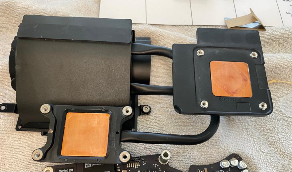

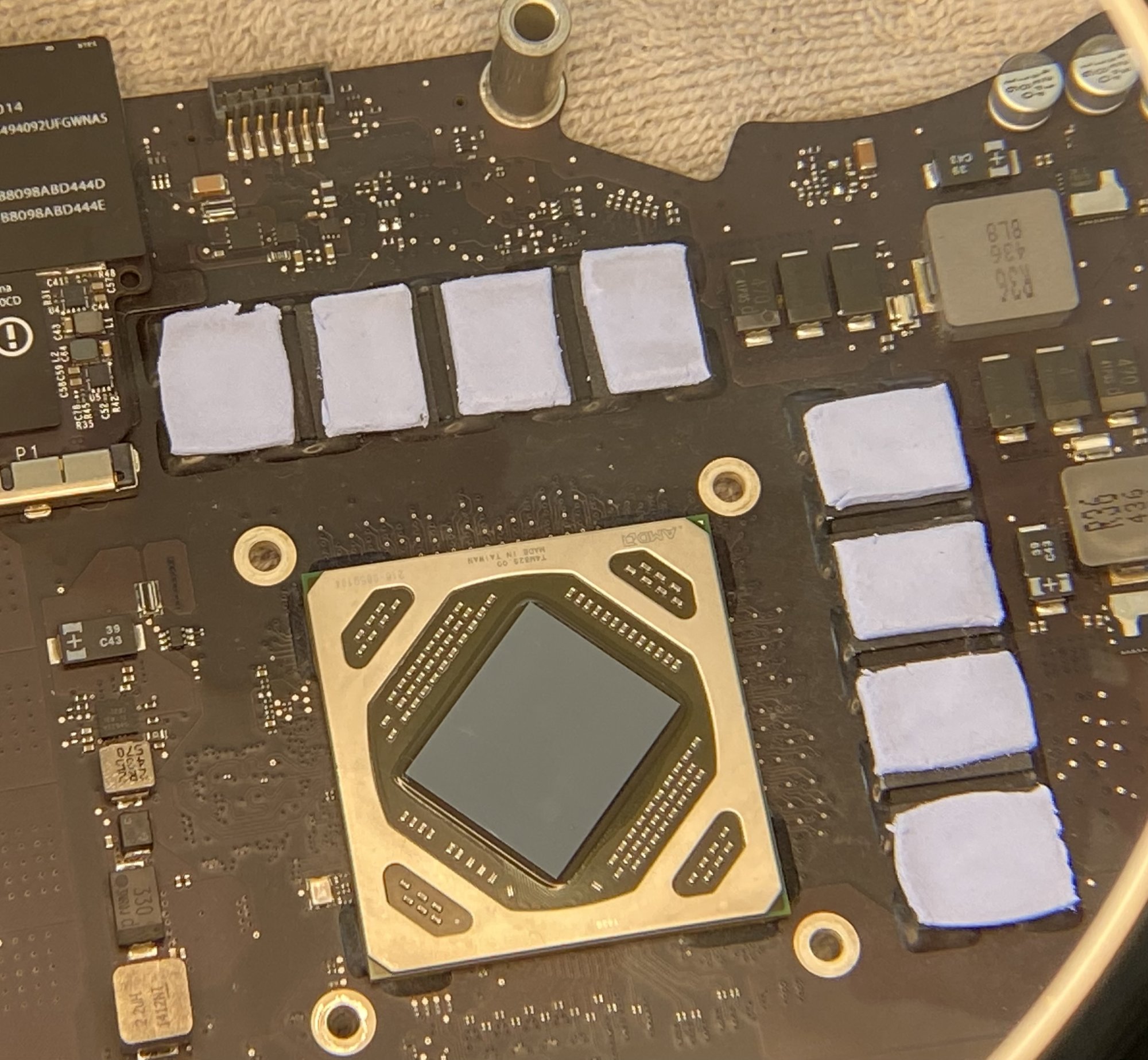

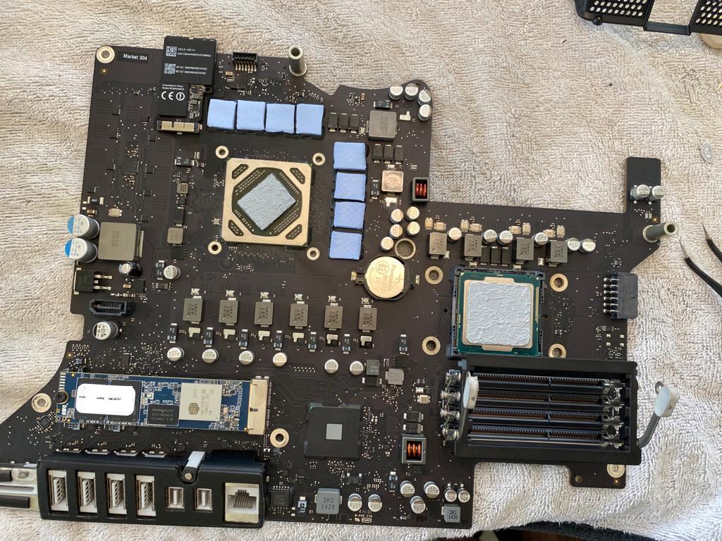

I did thermal paste replacement for CPU & GPU with " Noctua NT-H2. Which seems be doing great. But the thermal pad "ARCTIC TP-3 / 1.5mm "

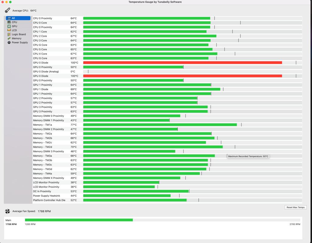

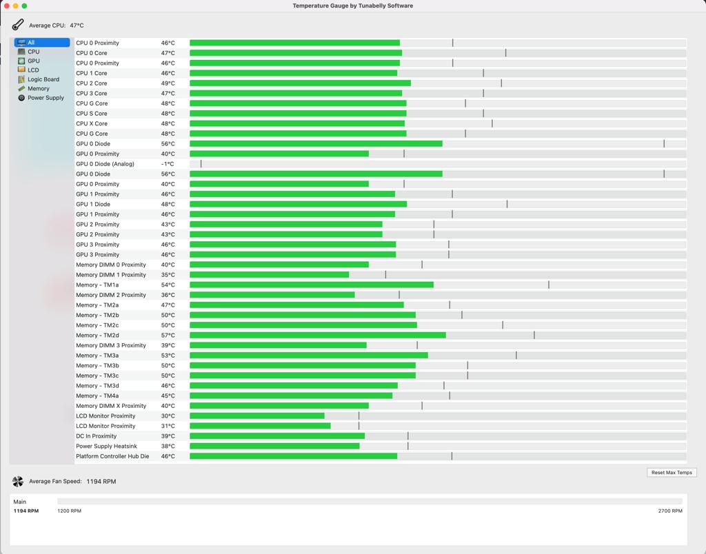

The System works fine till i start using " Youtube " only this one " Gpu 0 Diode " over heating like crazy and goes up to 109°C / 228.22°F" and as soon as i pause the video it drops quickly down. to normal temperature. While browsing i do not have any issues its completely normal temps. But is only this " Gpu 0 Diode " that does this.
" Apple iMac 27" A1419 5K Late 2014 Logic Board 820-5029-A w/ AMD R9 M295X 4GB " This is the board i think
