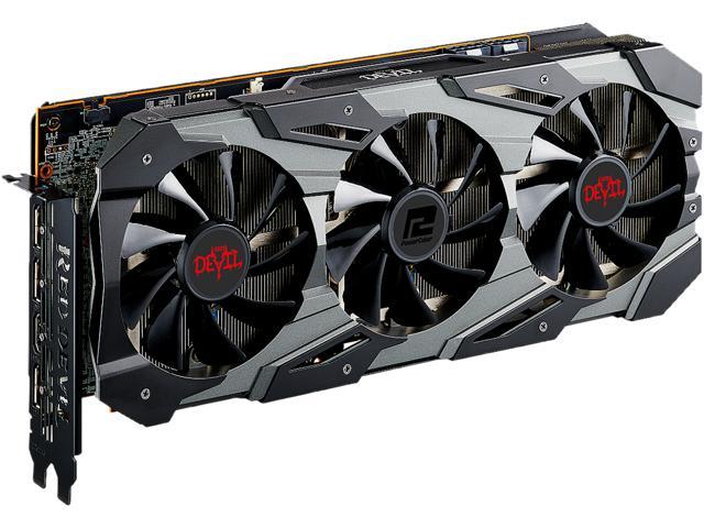

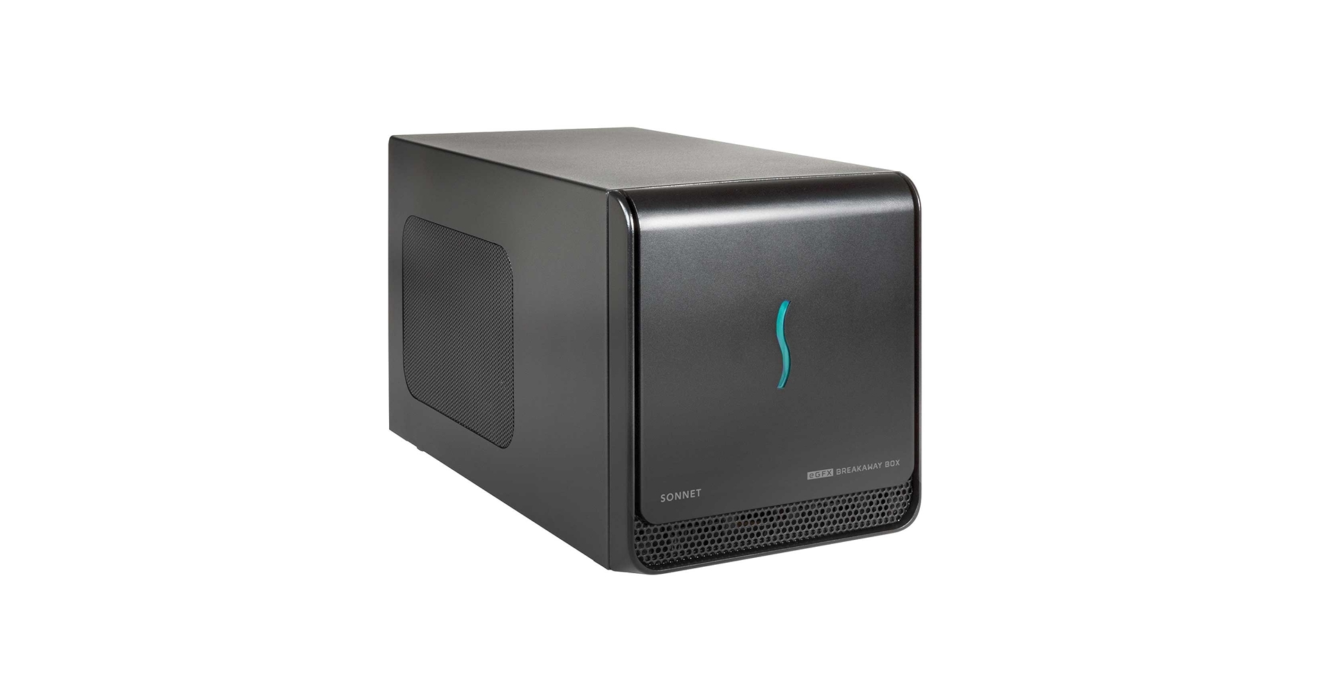

I've picked this GPU and this eGPU tentatively before I pull the trigger...
Main reason is that the Sonnet eGFX breakaway box is heavily supported by Apple, and it's not made by Razer (which I have a loathing of the quality of their products after years of use and lack of Mac support). As far as I can tell, this is the best AMD GPU for gaming. I'd like to be proven wrong by anyone here.

I love my sonnet. I have a 580 in it I believe. It's probably the only hardware that's flawlessly worked on my mac mini.
Yeah I'm looking for cards around 2015-2035 boost clock speed and 1800+ core clock speeds. This means it's an OC'd card with beefy cooling solutions on it, which is why I'm struggling to fit it into the sonnet. I could go with something else, but the sonnet has such a good reputation for flawlessly working that I'd rather stick with it and go with a slightly different card.

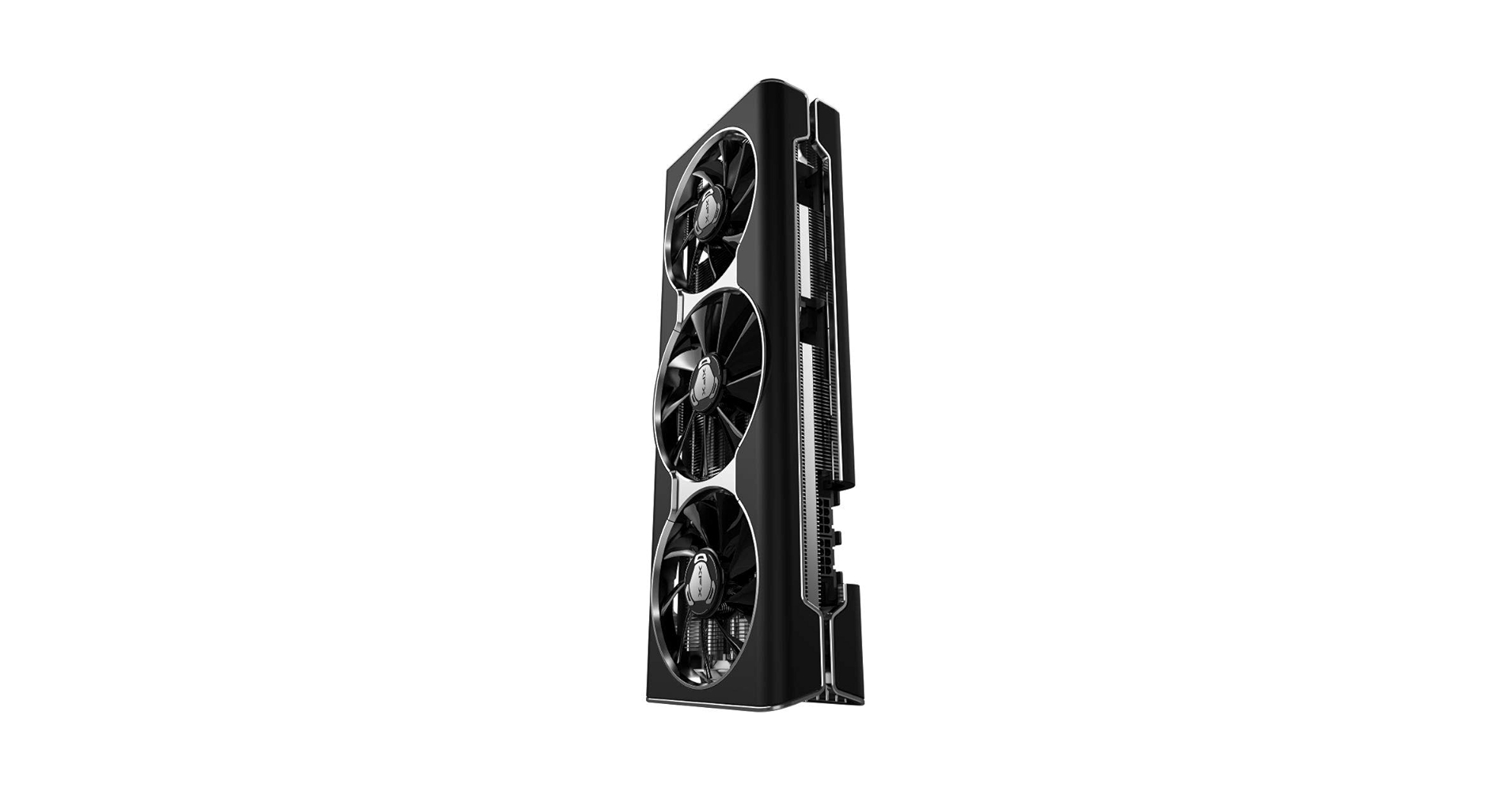

Decided to go with this card...
https://www.sapphiretech.com/en/consumer/nitro-radeon-rx-5700-xt-se-8g-gddr6
And the 650W Sonnet enclosure. Hopefully I will have it all here by next week to do some benchmark posting.

Because this card is heavily overclocked, it's performance matches the Vega 64 in my iMac Pro in almost every situation, but gives me the additional thermal headroom without my iMac Pro sounding like a leaf blower to get decent performance. I am very happy with the enclosure, despite the tight GPU fit.
The only situations where the performance does not match, is in older game engines that are not optimized or configured for eGPU usage. On those games performance tanks as low as half of the Vega 64. As time goes on, this situation will be less and less common. I expect that this enclosure will be my graphics upgrade avenue again in 3-4 years.
