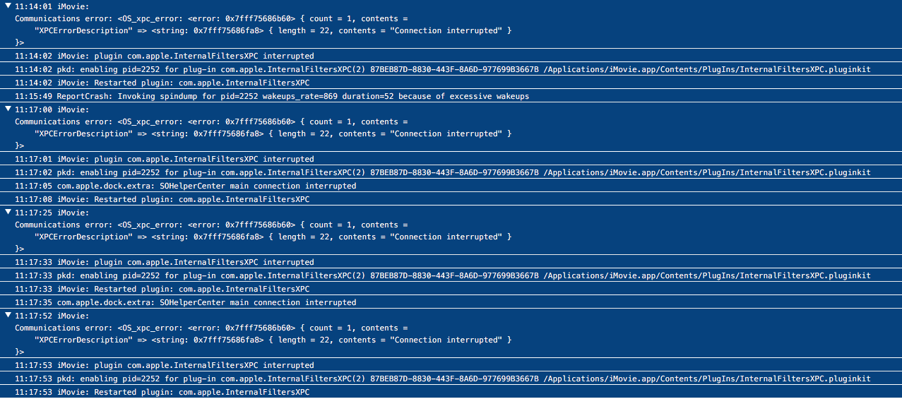

Hello,
I would like to export the video I created (1h 05 min total, expected final size 10 GB) using the share > file functionality. The original sources files are .MTS (H264 MPEG-4 AVC 1920x1080 50fps Audio AC3 (A52) 48KHz).
Export parameters used are:
  • Video and Audio
  • 1080p
  • Quality: high
  • Compression: best quality
I disabled the energy saving settings preventing my iMac to sleep.
I have tried to save it on the local HDD (with 700GB free) and on a network SMB share.
At the end I always receive the error "failed to share" and in the details there is just "rendering error 60" (of which I was not able to find any description on the internet).
I tried restarting iMovie and rebooting my iMac, nothing changes.
During the exporting process a .mp4 file is created and three other temporary files are created as well, but of the times at the end the .mp4 file is zero byte.
I also attach some logs related to iMovie that occurred during the exporting process.
Do you have any additional details on the error 60 or do you know how to solve the issue please?
Thank you
iMac (27-inch Mid 2011), OS X Yosemite (10.10.1), iMovie 10.1.1

thanks for the reply, yes I tried a local folder many times but always with the same results. Screen of logs are actually taken from one of my last try while saving on the local HDD.
Actually this is the first time with 1920x1080 files, I did longer movies with DV sources and I never had issues exporting (of course the exporting configuration was different I think it was maximum 720p I don't remember exactly now).
Any other ideas?

I also attach some logs related to iMovie that occurred during the exporting process.View attachment 616668
