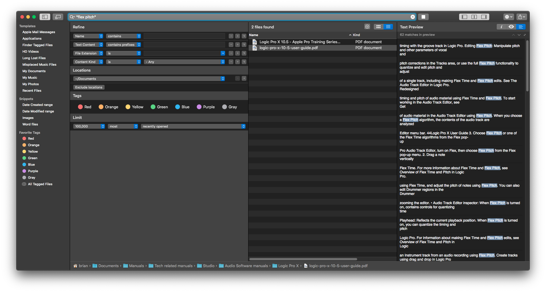

Further to my post about Houdaspot…I tried it out and the demo is fully functional. Searching my Documents folder for the phrase "Flex pitch" (a Logic Pro feature) it finds two documents and the context of each result is displayed. Looks pretty good:

I like the look of Houdaspot thanks BrianBaughn. I will investigate that next. Thanks to all who took time to reply.

HoudahSpot underlyingly uses the Spotlight index, same as using Spotlight from the Finder. Are you sure that you are searching the whole computer in Spotlight, and not just one folder?
The point of HoudahSpot is it combines the file searching capability of Spotlight with the internal, context-revealing searching of Preview.
Right, but if it can find a file on the computer containing "USB C", I'd expect Spotlight to do so too.
