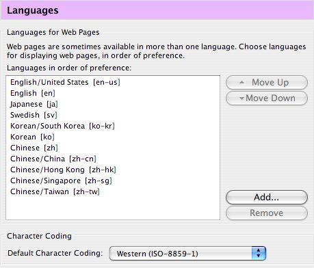

Below are my language settings in Mozilla. I'm not using Camino for now, but I suspect that it was working under similar assumptions.
[EDIT]
Panther has defaulted to romaji input despite my insistence to use U.S. English. It apparently knows that I need to get back to using Japanese more often.
[/EDIT]
