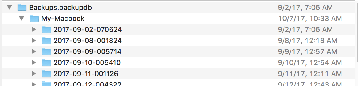

How can I can confirm/verify the most recent backup on my TimeMachine?
If you had a operating Mac, you could attach the backup drive and look in the backup like in my screenshot and see the last backup.
