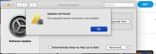

Can someone direct me to a viable link for Catalina please. Apple says the requested version is not available.
this link is no good. https://apps.apple.com/au/app/macos-catalina/id/1466841314?mt=12)
