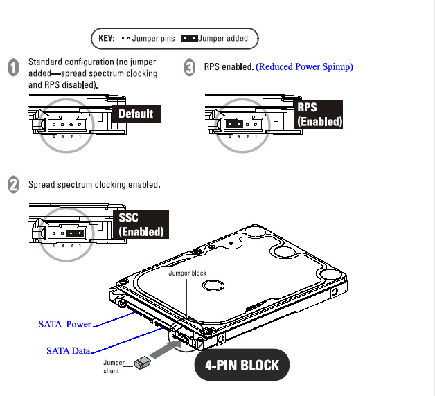

Something else to check - is your new hard drive the WD Scorpio Blue WD5000BEVT? This hard drive has a reduced power saving mode RPS and a spread spectrum clocking mode SSC. These modes are enabled with a jumper. If it is the WD Scorpio Blue, any chance it has the jumper installed? The default position is no-jumper. See link ..

No, here's the drive that I have.
http://www.seagate.com/ww/v/index.j...cb2d110VgnVCM100000f5ee0a0aRCRD&reqPage=Model
