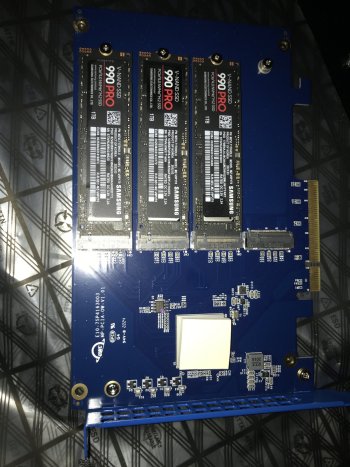

Mac Pro 5.1 2012 with BootRom 144 / installing Monterey / using OCLP to install.
Installed Mac OS Monterey 12 to a MvMe PCIe SSD and it will not boot , i get a gray screen with a circle and a line through the circle.
The PCIe is a OWC Accelsior 4M2 - PCIe M.2 NVMe SSD Adapter Card... there are 3 blades installed. one has the OS...
Might it be SSD related?
Please advise.

That is the prohiibited boot sign - OCLP should be handling things for you. I would ask questions in the OCLP discord channel.
What it means it your OS is not compatible with your mac - this is what hybridization is supposed to fix so my guess is something is wrong with your OC configuration.
Can you boot a supported operating system like Mojave?

on OCLP discord not much help with MvMe's
i can boot from a SSD Sata drive in Mojave, High Sierra, Monterey OCLP.
can't boot from MvMe Card using the samsung 990pro ...
Looks like the SSD is not compatible.
You have to bless your new drive, using the command "bless". Or the bootloader can't locate your Opencore EFI partition to boot up.
Sorry that I missed this - 990 has compatibility issues. Given everything else you report that seems to be the problem
i believe the 990 will not work booting.
i am trying a OWC OWC 1TB Aura Pro IV PCIe 4.0 NVMe M.2
monterey installs using oclp 1.01 - but still does not boot
from power on it goes the the boot picker then tries to load the OS, then blanks , then back to the boot picker,
this takes place a few times , then MP powers off
how exactly do you bless a MvMe SSD?
