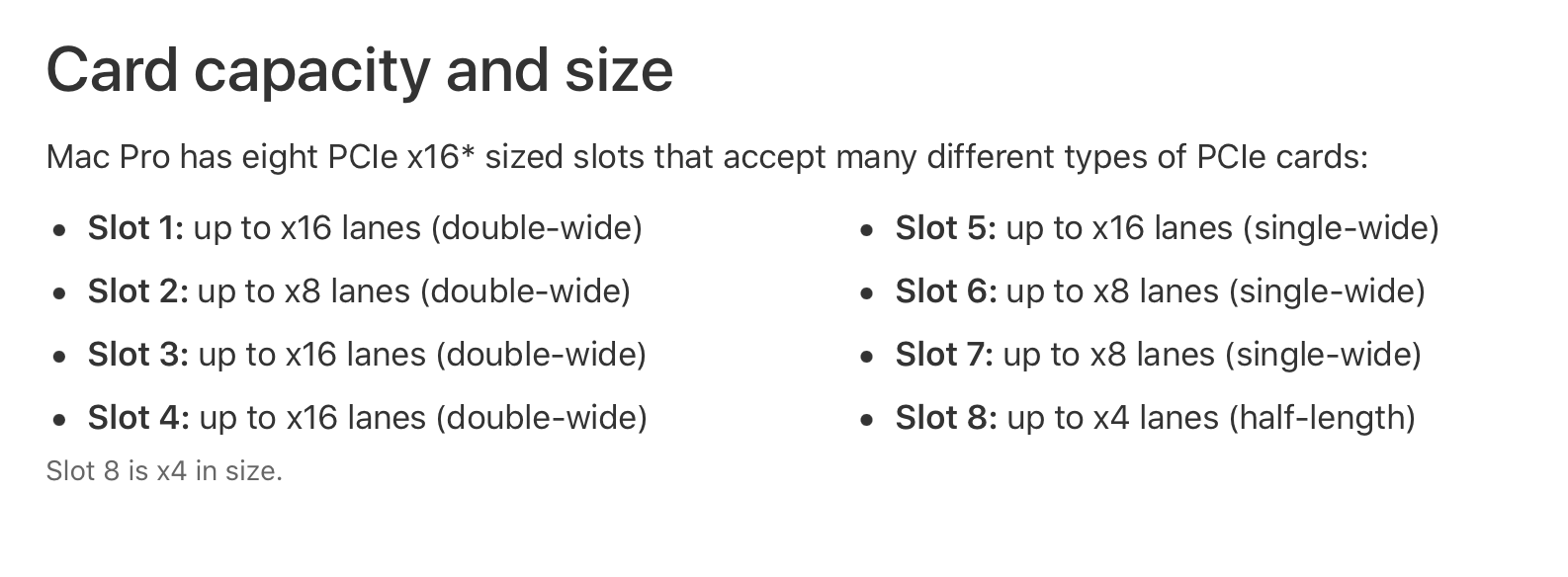

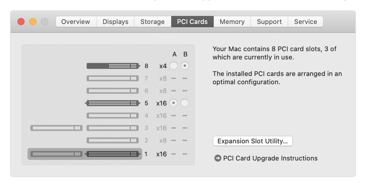

Nope, it has no bifurcation, as indicated above, is needed in multiple SSD applications. Your Mac has eight PCIe slots. Two are in use in a bare machine - the X4 slot one with your USB card and a X16 double wide slot one with the GPU. The slots vary lanes (4, 8 or 16. and width (double wide or single wide) For maximum speed you want a X16 card in a X16 slot. A double wide slot would make for better cooling, but other than those two considerations, an SSD card would fit in any slot.
TinyGrab Screen Shot 11-21-21, 12.27.14 PM.pngTinyGrab Screen Shot 11-21-21, 12.27.57 PM.png
Lou
