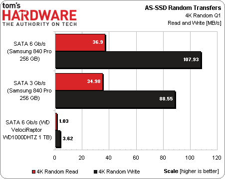

4K random read is a very good reference for "OS operation" performance (e.g. boot time). So, a SSD can be ~30x faster than a HDD regardless the connection type. PCIe (both ACHI, NVMe), SATA 2, SATA 3, USB 3.0, Thunderbolt.... doesn't really matter. Unless you use something like USB 2.0 which only provide little bit buffer over the 4K random read speed, the OS operating speed generally won't be limited by the connection type (USB 3.0 is definitely fine).
