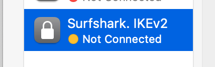

I had the same problem happening. Seemed all-tough my VPN was off still the IKEv2 driver was started. After turning that off from auto starting my problems were gone.
ca$hman, Can you say more about how you turned off IKEv2 from auto starting? I also have Surfshark installed (though generally not used from my home network), and also see the following in my Network settings:

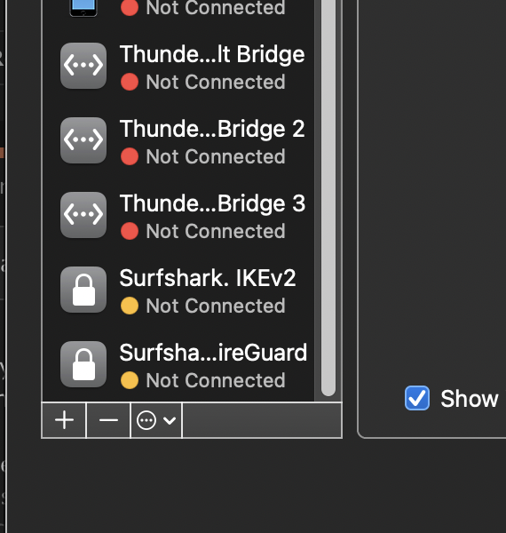

In your reply are you showing how this driver appeared after you kept it from auto starting, or is this display, with it visible in the Network entries but "Not Connected" how it appears when it has auto started?
I don't see anything in the Surfshark app settings, or in my user account Login Items that I can turn off. Any more help you could offer would be great.

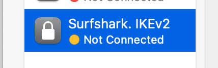

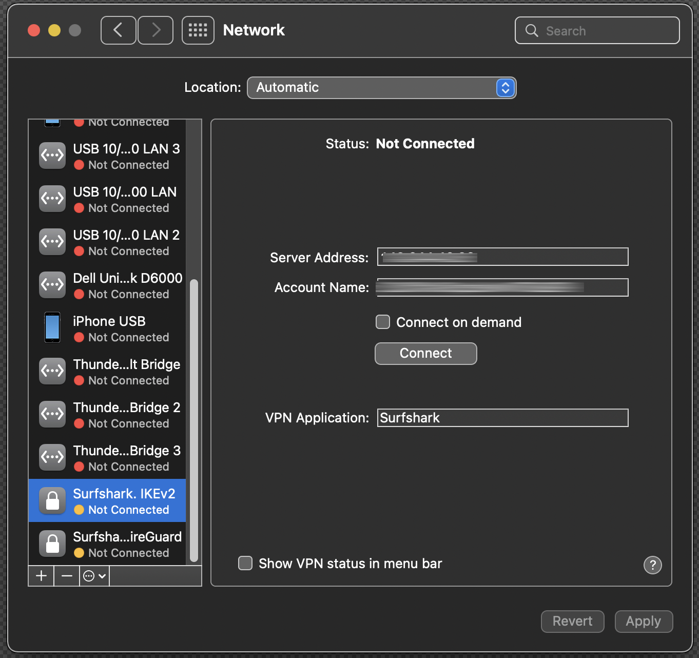

Trying really hard to recall my exact actions... I believe it was in this settings. But Honestly cannot recall exactly.
Thanks for trying to remember. I'm afraid that already matches the settings I have on the same screen, and as far as I know the problem persists, or has recently. I'll check in to this particular network settings screen if/when the next network freeze occurs. Thanks.

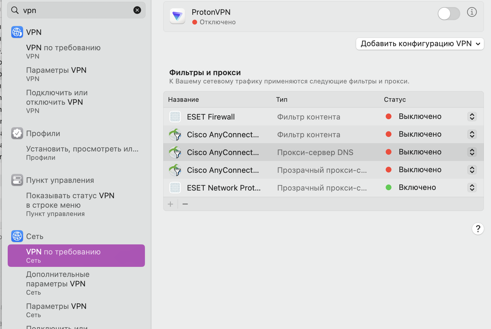

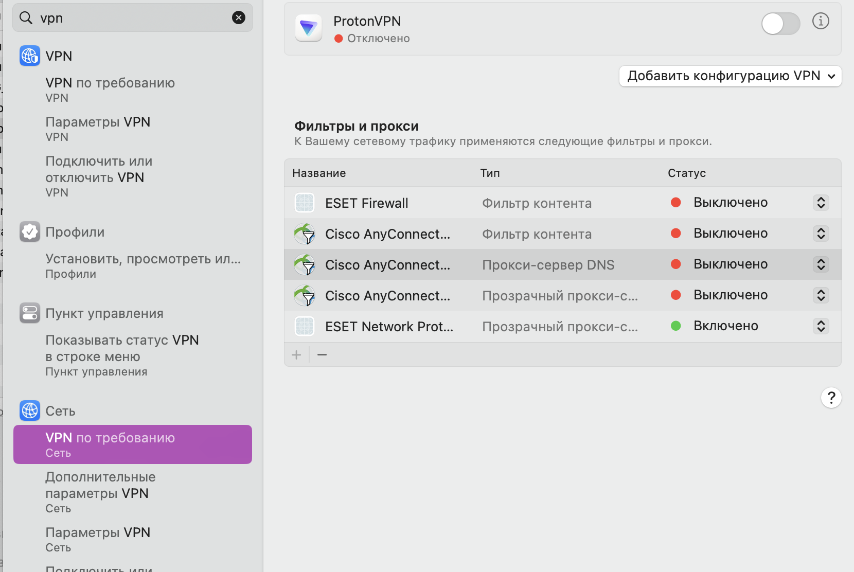

What worked for me was:
Going Network -> VPN and filters -> and stop ESET Firewall. You can try to stop any firewall you have and see what you got.

I had the same problem, and this discussion led me to the solution. In my case it was not the Cisco VPN software but Microsoft Defender. Both install network filters and uninstalling MDE restored my Internet. Thanks guys.
