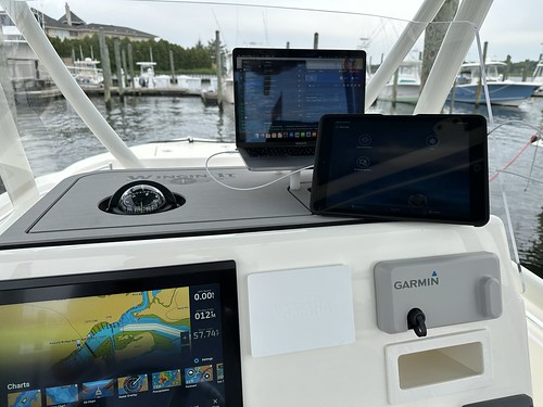

I have an 8th gen wifi only iPad that is transferring data over its wifi connection to another non-apple device. While it's doing this, I would like the ipad to have internet connectivity. But because the wifi is in use to another machine that is not connected to the internet, its Wi-Fi radio is already in use, thus no internet connectivity.
I have an iPhone 14 available and a MacBook available.
Is there a way I can tether my iPhone to the iPad with a wire, a lighting to lighting wire, so my iPhone could send internet to the iPad?
I tried connecting my Macbook to my iPhone Wi-Fi hotspot, then plugging a USB-C to Lighting cable from my MacBook to the iPad, but that did not provide internet to the ipad. I even checked to make sure internet sharing was turned on at the mac.
Can a mac share internet over Bluetooth only?
Is this even possible?
Unfortunately the location is semi-remote, I only have cellular data available, there is no Ethernet cable nearby. The only way to connect to the 3rd party machine is over Wi-Fi using the iPad, so it's not like I can connect to it with a wire or iphone (it's a marine chart plotter). Trying to avoid buying a cellular iPad for this single use.

The plotter can only talk to the iPad, and the only connection available between them is over Wi-Fi. Due to a software bug the plotter cannot talk to latest generation iPhones (Garmin Active Captain). A cellular iPad would do the trick, but I’m trying to avoid going that route for this single use.
I wonder if I had internet sharing set up wrong on the mac. Maybe I should try again with USB C to lightning cable to iPad while the mac is hotspotted to iPhone 14. I noticed in internet sharing there are some additional settings in that MacBook settings that I did not check last time.
If there was a way to wire in internet to the ipads lighting port, from my iPhone or mac I’ll be in good shape.
I believe that you should be able to connect the iPad to the Mac via Lighting/USB, connect the Mac to the phone’s hotspot, then share the connection from Wi-Fi to “ipad usb” (or however it shows up in there). Let us know.

I no longer have a Lightning iPad, so I used my second iPhone with airplane mode turned on. I connected it to my Mac with Lightning cable, “trusted” it, and made sure that the phone could not access the internet. Then I shared my Mac’s connection to the USB iPhone connection and it worked fine.

but have good news as an update. I used a USB-C to Lighting cable, that connects macbook to the ipad. Hotspotted the phone to the mac, internet sharing turned on at the mac (share from mac wifi then to "ipad usb" under internet sharing options). Now the ipad has internet and it stays connected to the plotter. So much easier to sync the plotter with a live internet connection rather than connecting and disconnecting the ipad constantly.
