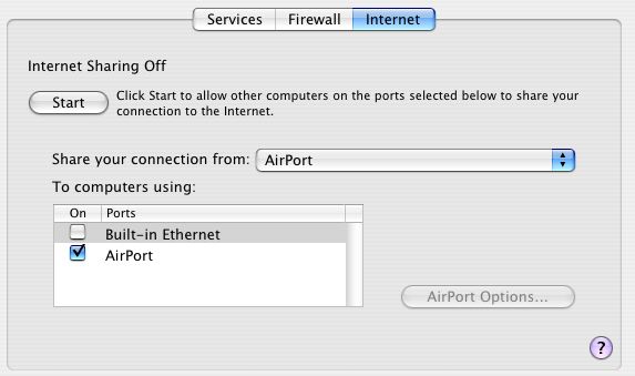

Go to your prefs and make sure Internet sharing is on and shared over the Airport. See screen grab below (would need to click start).
