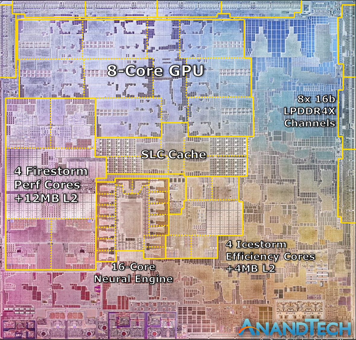

No, I think this is the first mention of it. It will be interesting to see how the next batch of Apple Silicon Macs will handle larger memory. There's only so much room within the Apple SoC package.
Anandtech writers mentioned it on Twitter before. As to next gen Macs, they will use more RAM chips, possibly stacking them, while using a wider interface.
He probably meant LPDDR4X, since that's more advanced than LPDDR4; 3733MHz LPDDR4X is what's used in the 13" Intel MPB. The 16" Intel MBP uses the higher-performing, but more energetically costly, DDR4.
DDR4 is not higher-performing, it has lower transfer rate. Assuming Apple uses LPDDR4X 4267 with a 128-bit interface, it has about 60% more bandwidth than the DDR4 2666 used in the 16" MBP

DDR4 has higher densities (this is what allows 64GB on the 16"), not to mention that if I remember correctly 14-nm Intel CPUs don't support LPDDR4X. And of course, cost and availability.
With Apple moving to on-package high-bandwidth memory configurations, I am curios to know where are they going to get all those premium RAM chips...
They may move to off chip RAM on the mid-range and high-end SoCs, and make up with the performance loss with even wider data busses. They obviously can't stack 256GB and higher RAM capacities for the higher end machines. And while they will probably end up using denser and denser RAM chips when they are avaiallable, those are on longer development cycles than the AS SoCs appear to be on.

The RAM in the M1 SoC package is already on a separate die:
While that is likely the case, upgrading RAM in a stacked SoC package isn't realistically something that the end user can do and may likely be beyond what an Apple authorized service provider can accomplish.
A socketed SoC might allow for an upgrade path but my guess is that the SoC on the new Apple Silicon Macs are soldered to the motherboard effectively making this discussion moot.
Apple has pushed an increasing importance on system integrity and security. With the on-die Secure Enclave, it is unrealistic to think that Apple would use a chip socket for the M-series SoC.
More chips. If you look at the M1 is has two chips on the right next to the SoC. They probably did this for small size and low power. They could theoretically have 4x as much memory by just putting it on all 4 sides. DDR5 is on the horizon which will increase capacity per chip too.
Can you stack DDR RAM? I know you can stack HBM but I wasn’t sure about other types of memory. If you look at a GDDR GPU it’s surrounded by a lot of chips compared to an HBM GPU which has two or two small stacks of memory. If so that will free up a lot of space.
