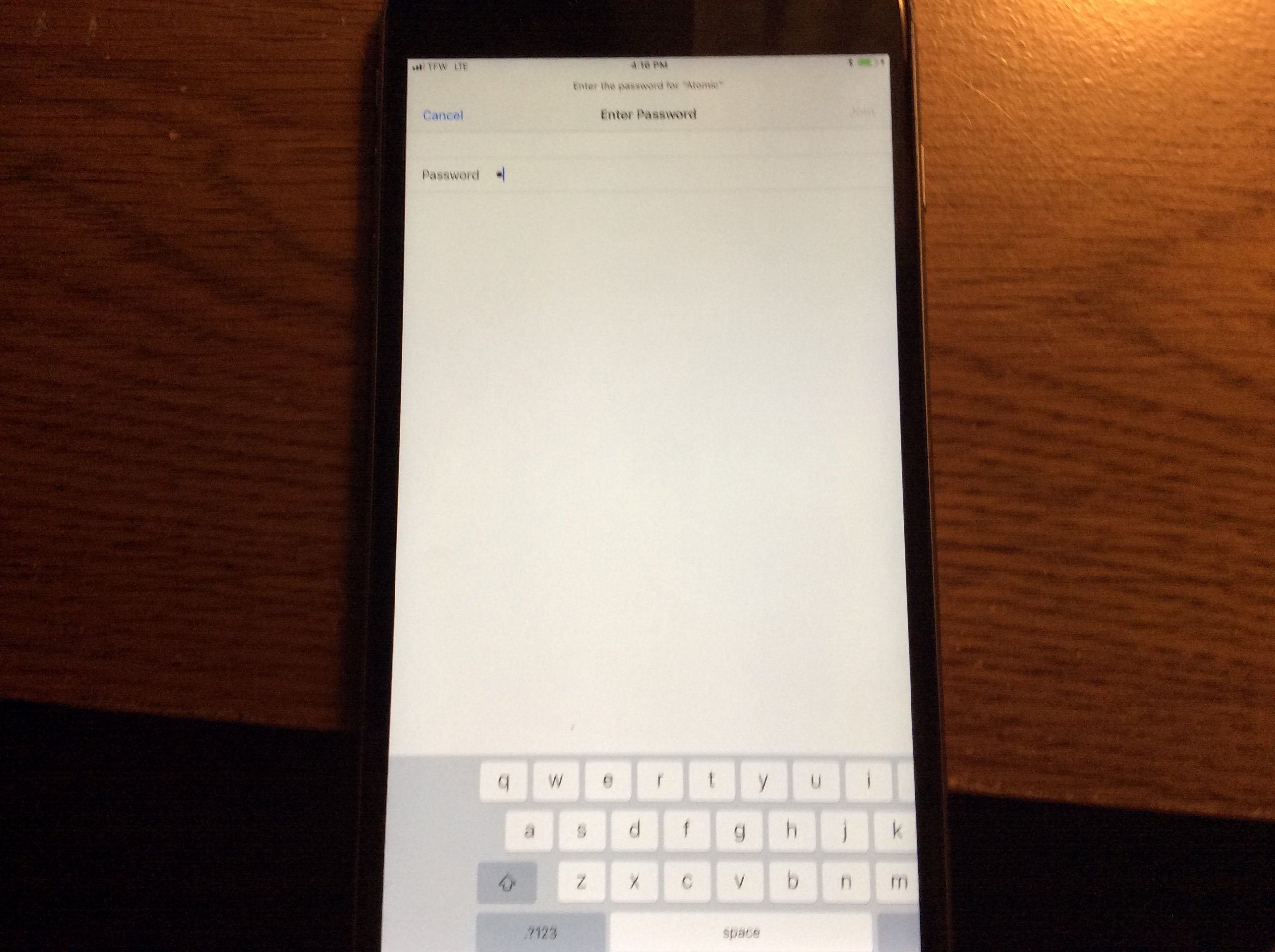

I decided to do this again but install an older version of iOS and see if it resolved the problem. After 4 attempts I finally got a screen back on the phone but it looked strange. The phone was restored as a new device and wanting me to walk through the setup which I was glad to do. The problem was that the icons where VERY tiny on the screen and the keyboard was shifted to the right and half was off the screen. Things were very strange. I was able to get the keyboard back on screen by hitting the "ENTER" button and then walk through the setup.

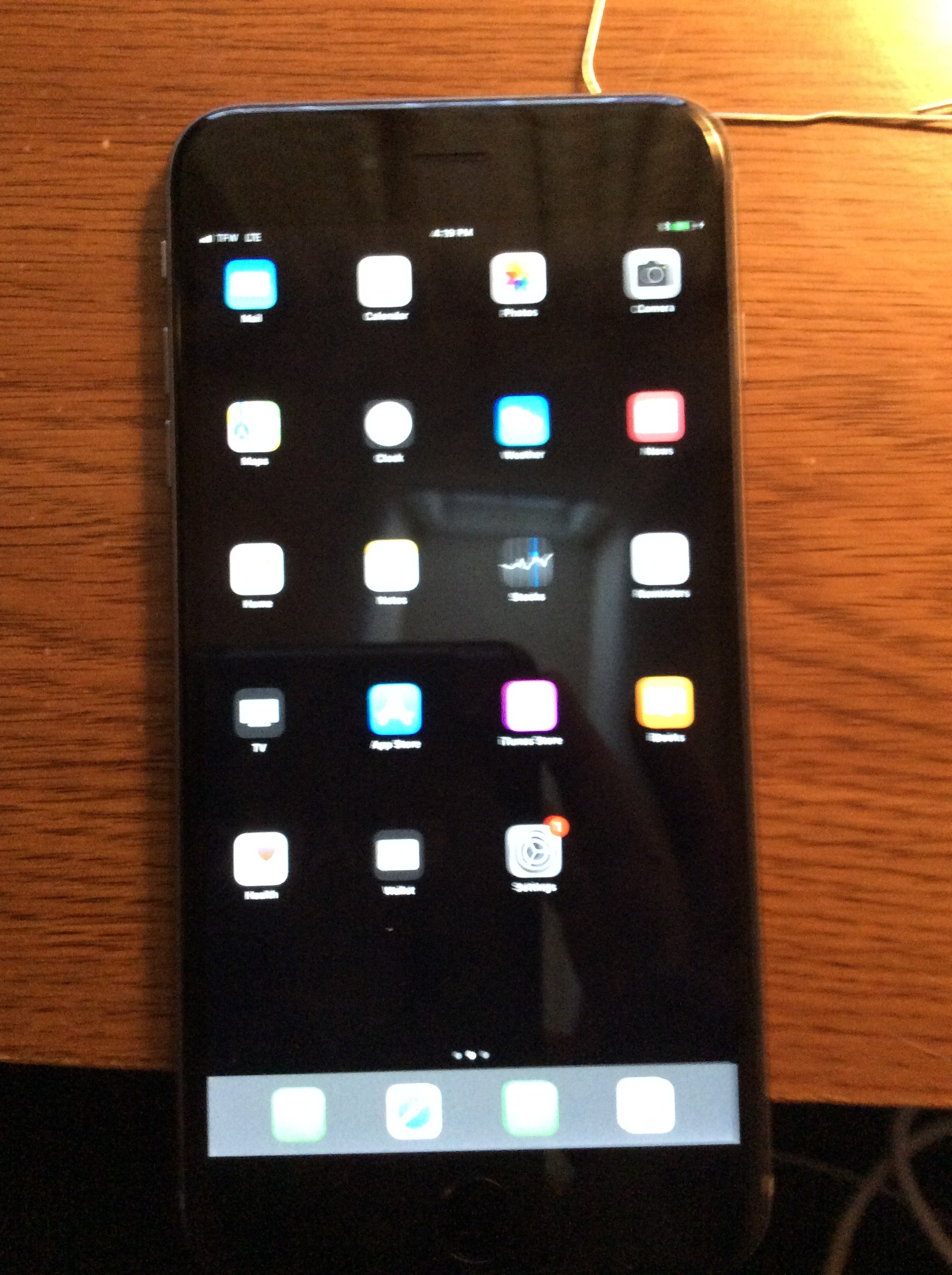

Once I was at the home screen, things were very strange. All my HOME screen icons were tiny.

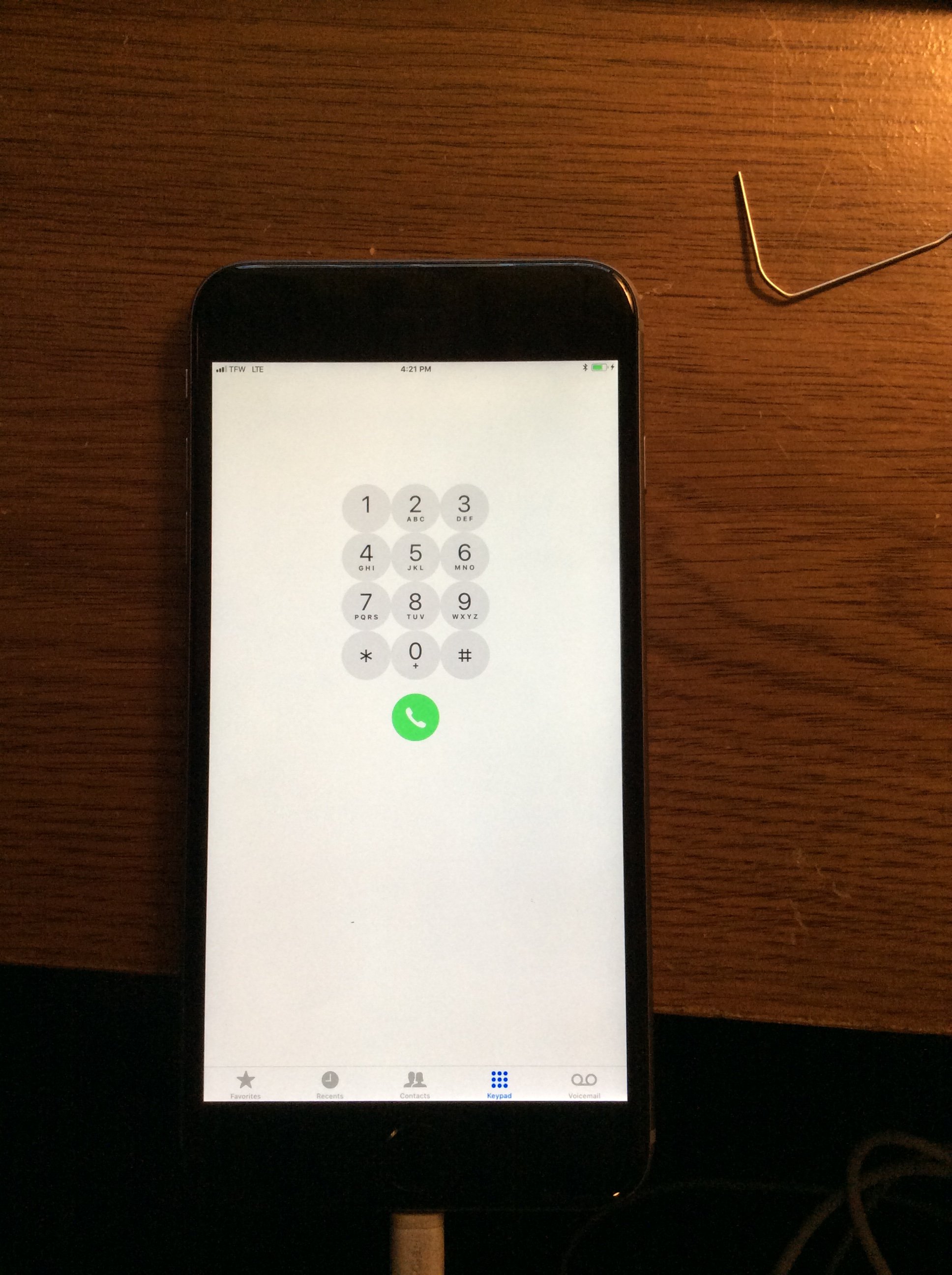

This screenshot is of the phone app....
I soon found that after opening a few apps, I was unable to close them in the normal fashion of just swiping them up off the screen. They would simply bounce back down into place. Instead I had to hold my finger on each app and a minus symbol would appear on the upper left of each open app and I could touch it and they would they fly up and away. Very strange indeed.
