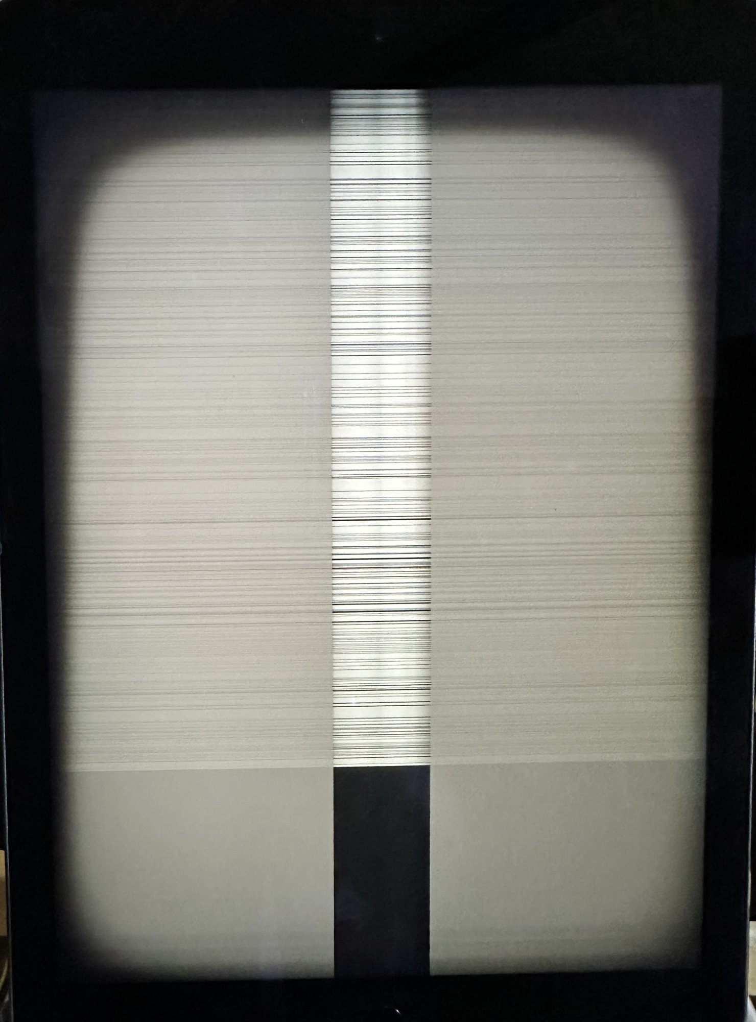

Really liked the iFixit kit. Had everything right there. 5 stars! They said it was difficult, but I'd rate it as darn near impossible.
I worked at it for over 3 hours, and had a few hiccups, but nothing earth shaking. I thought...

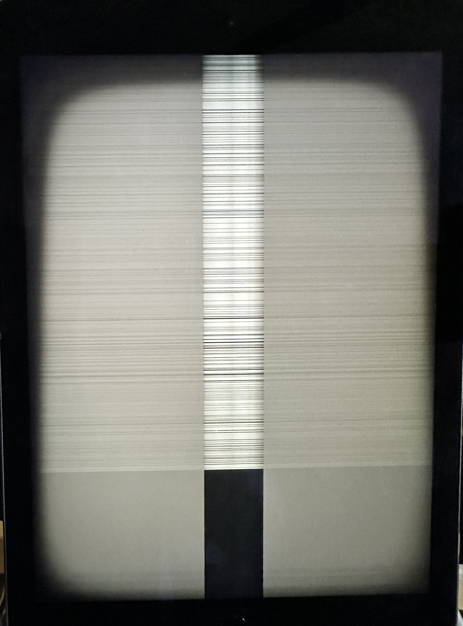

This is what I have left. *Something* didn't go right, and the whole thing is toast. Well, or at least the display is. I don't know what happened, but it's totally unusable at this point. *sigh*
Is it worth a replacement screen, or just cut my losses?
I *think* I must have snagged something on the back of the display. The instructions do not say 'go deep towards the back, under the screen with the picks'. Had I known, or had they said to do that, I could have been warned. All of their pictures show the picks parallel with the face, not at any angle. Tip to people *dumb* enough to try this themselves: GO DEEP!! (I think they mentioned it, but they could have stressed it during the written instructions. I DO read instructions)
Sad...

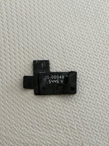

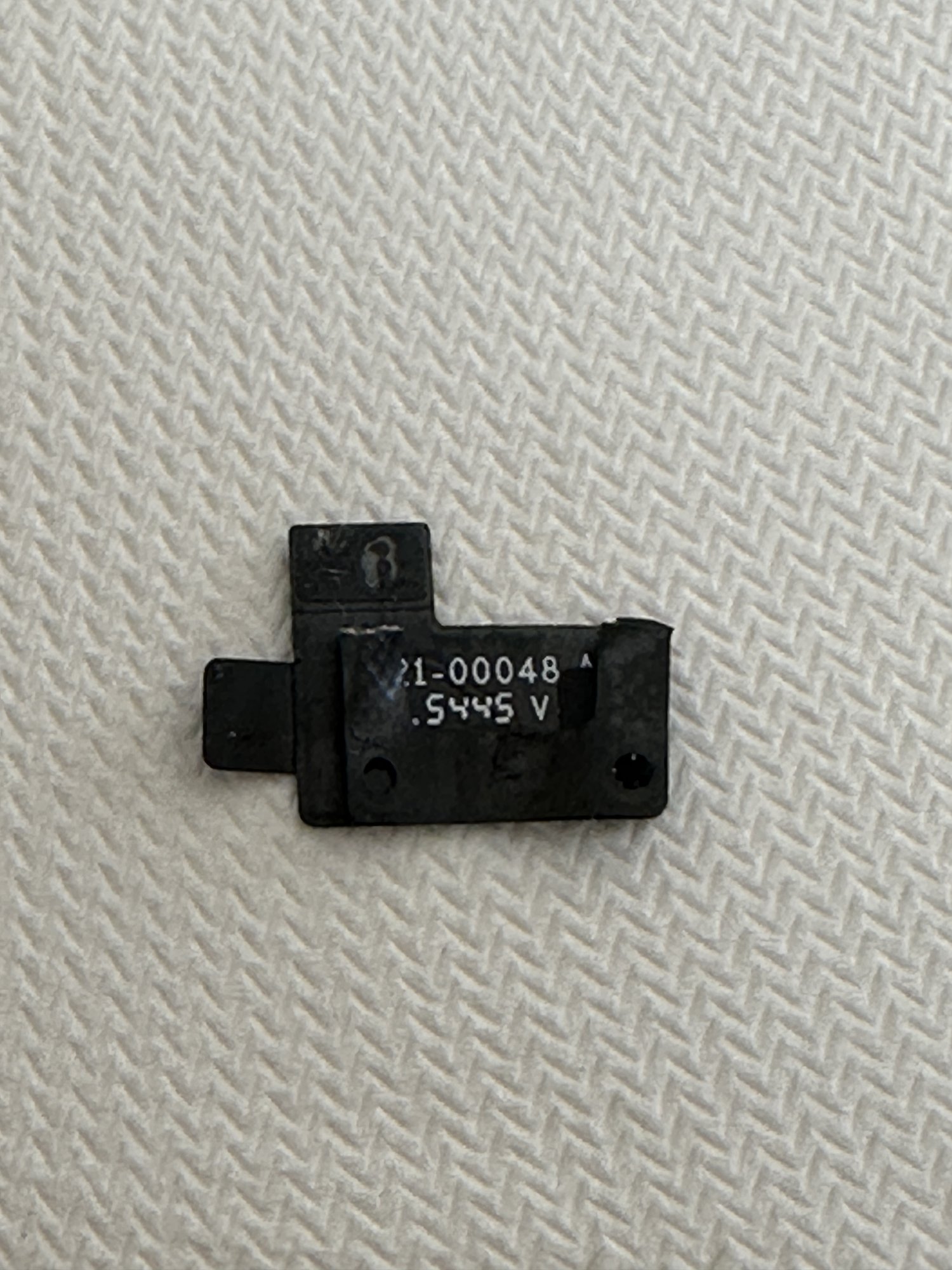

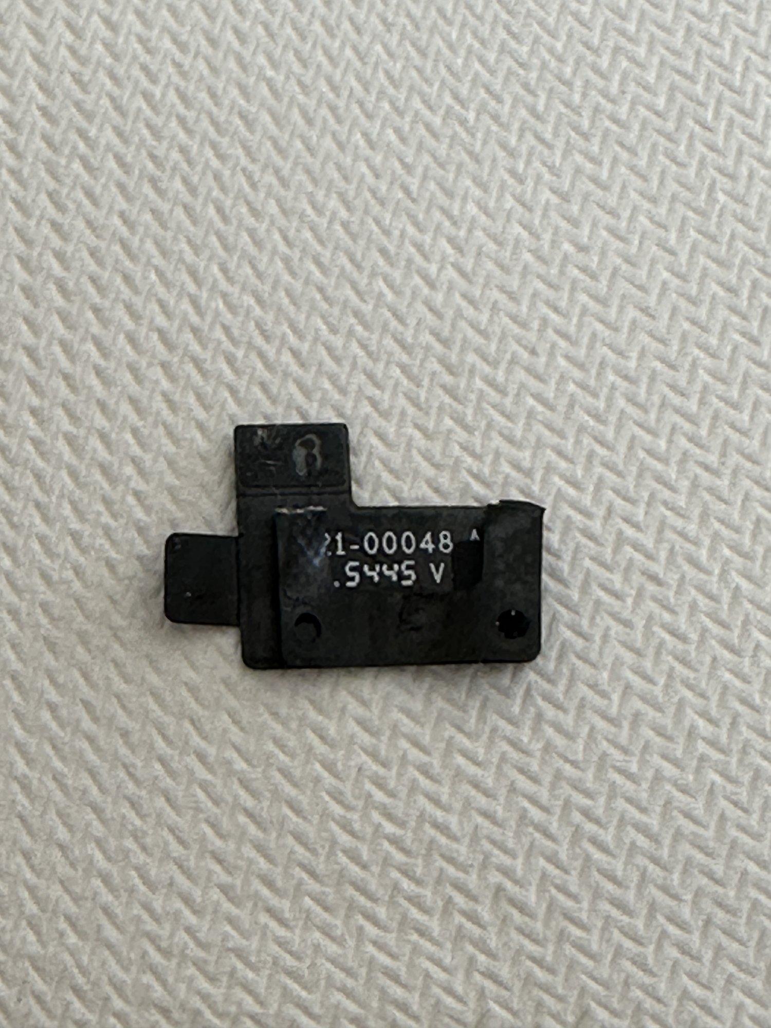

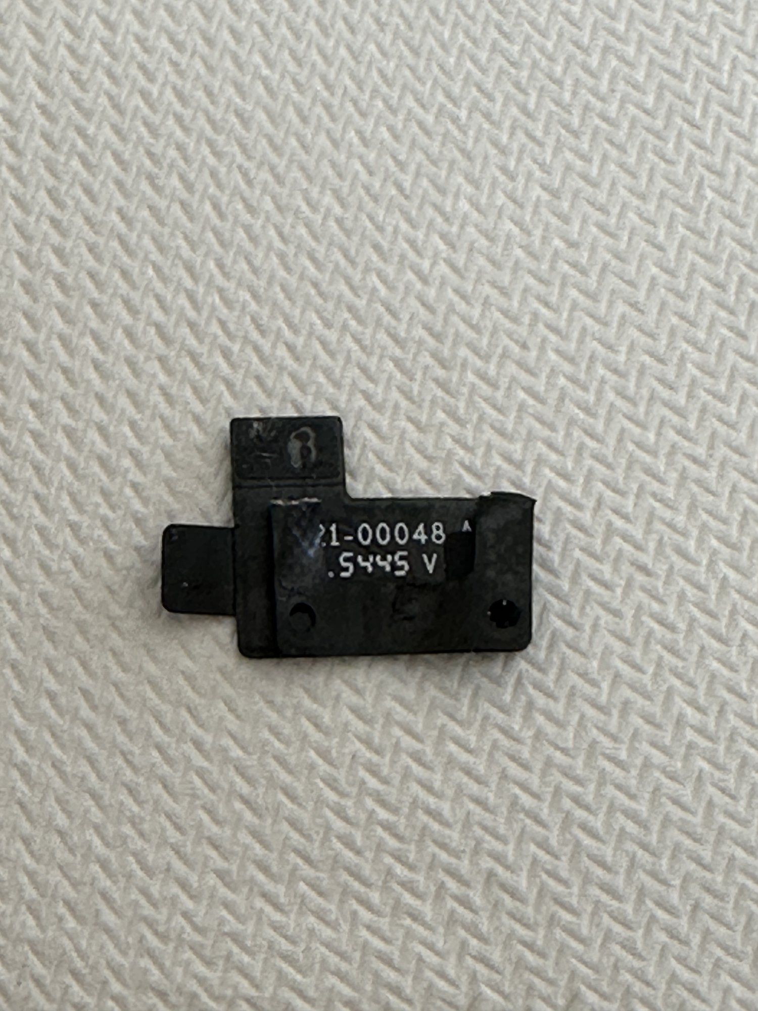

🥹 Found this small piece on the floor. Bummer. Just that little piece. Crap...
But I have a new iPad Air 2 battery. (Always look on the bright side of life?)
After looking at the screen, I don't see where it might have come from. It could be from almost anywhere at this point. It's a small discrete board with a small chip on it, and looks like a couple resistors.
Proof that just because we have the 'right to repair', that not all repairs are going to go well. 'It' happens... 🥹

Yeah, it's a hot mess. The LCD part of the screen nestles down in the chassis, so if you go straight in, you can actually separate the LCD from the touch screen overlay. AND, after thinking my 'go deep' comment, if you go too deep in certain areas, you might snag important parts (more than the provided document says). I think that the part I tore off was actually on either the frame, or the mainboard. They show the picks penetrating the side for quite a distance, but the adhesive is only around an eighth of an inch wide, so actually going deep isn't quite necessary, oops. The document they sent was in error, it seemed to show a deeper penetration under the screen assembly then was at all necessary.
I mean, NOW I see the issues. Until I can do an effective postmortem on the system, I won't know what parts I might need. In the meantime I have an iPad Mini4, and it's damned weird how slow it is doing some functions, and others it's really quite quick at. Is Apple really throttling the system, making certain operations take longer than others? It seems so 'odd'.
But the iPad Air 2 is likely gone. Lessons learned. *shrug*

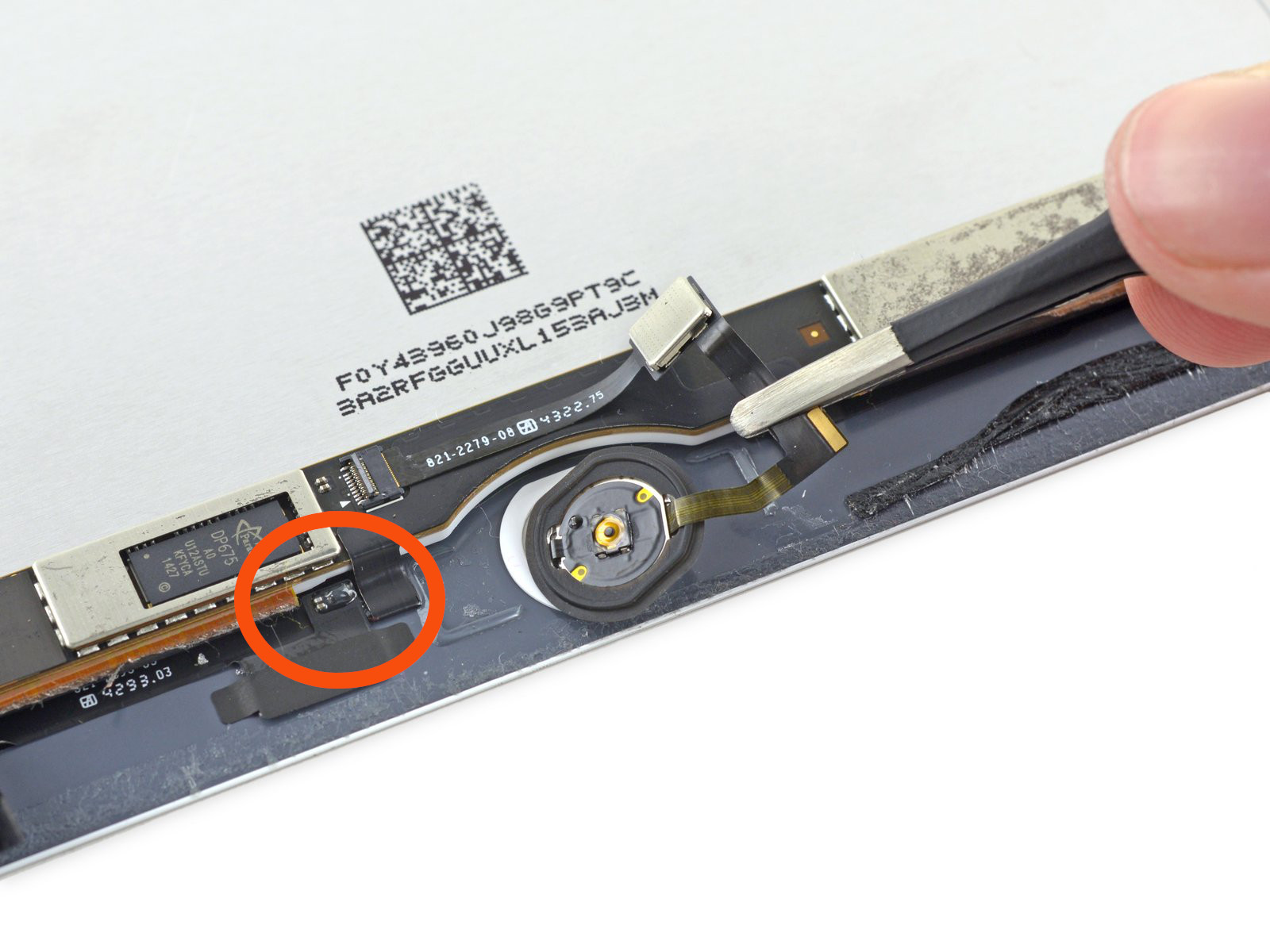

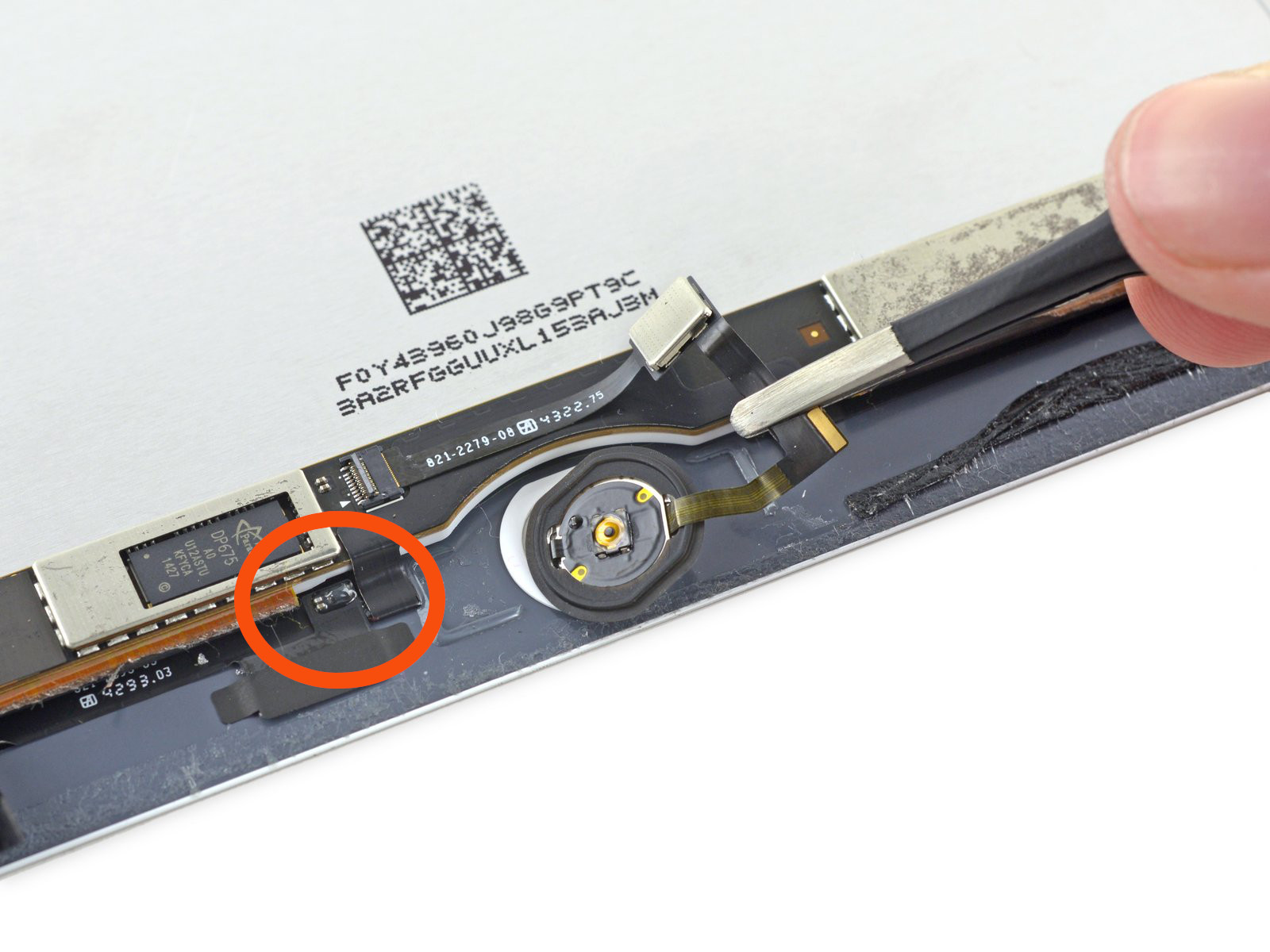

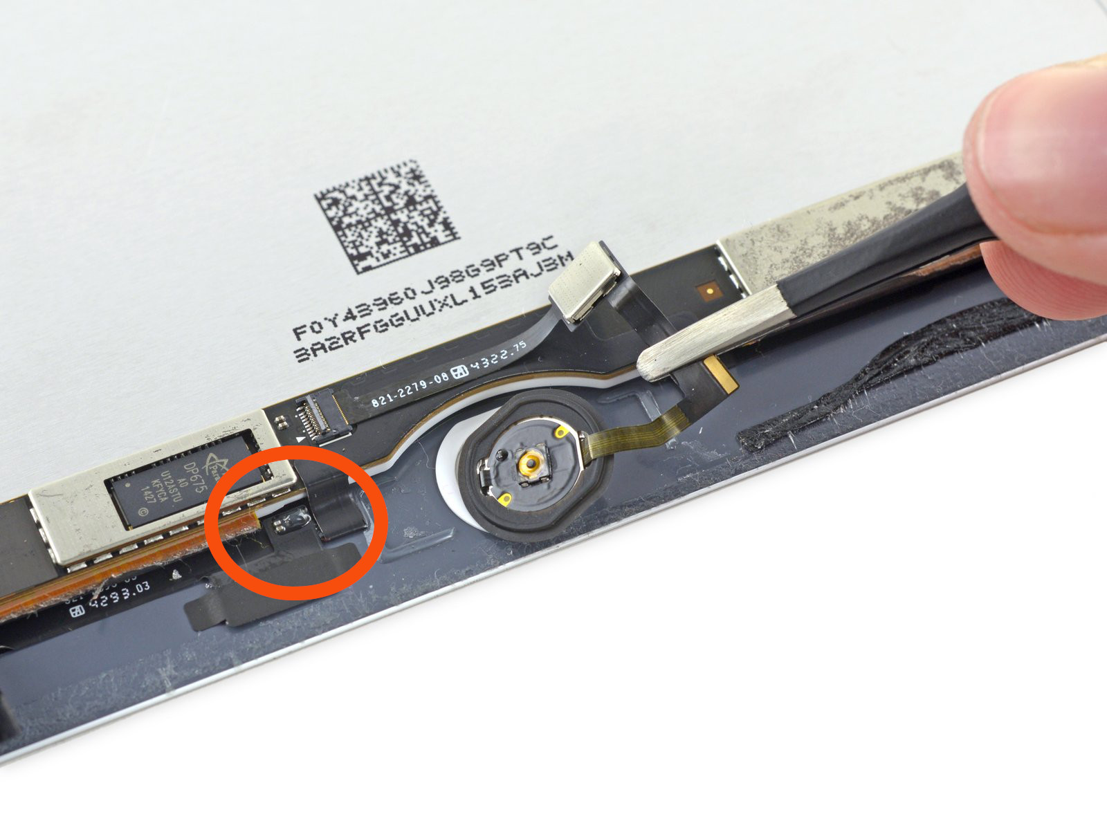

Found where the part came from. (I wish iFixit used cellular models to tear down too) And it's beyond toast...
Now wondering how I save the Home button for use in a new screen.

I will likely put a new screen on it because it's got a new battery, so... IF I can get the home button removed without ripping the flat cable(s). They are sure stuck on there very well. The 'IOpener' heating tube didn't seem to loosen the stuckum as much as I would think ideal. That's part of the reason why I went deeper, because the picks weren't staying in, and the tip was flexing a bit. Next time, I'll get someone else to do it. Once bitten...
Oh, and it is really easy to separate the touch surface from the LCD back if people go too deep on the sides. It's not for brute forcing...
They are made for being assembled, not disassembled, sadly...
