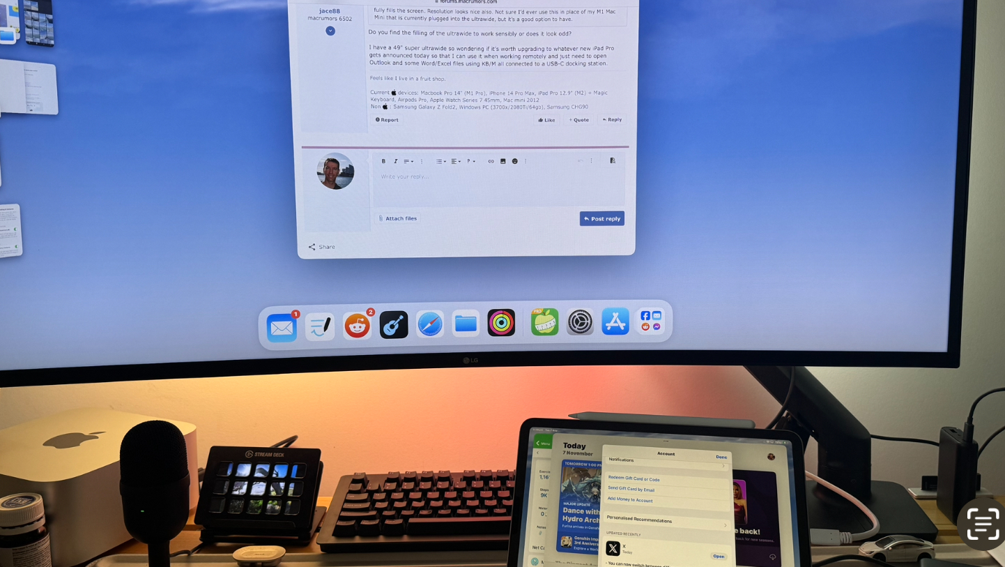

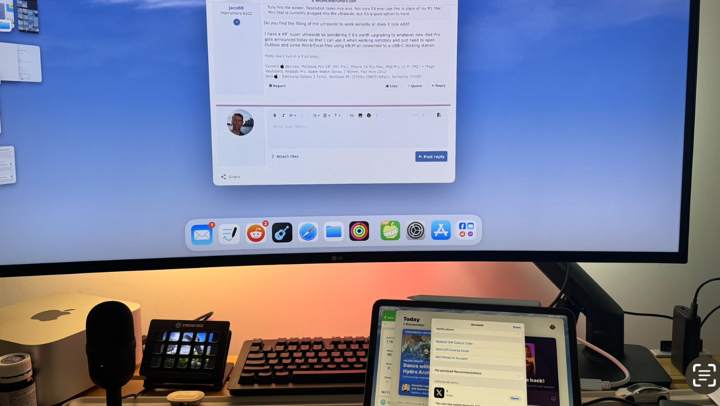

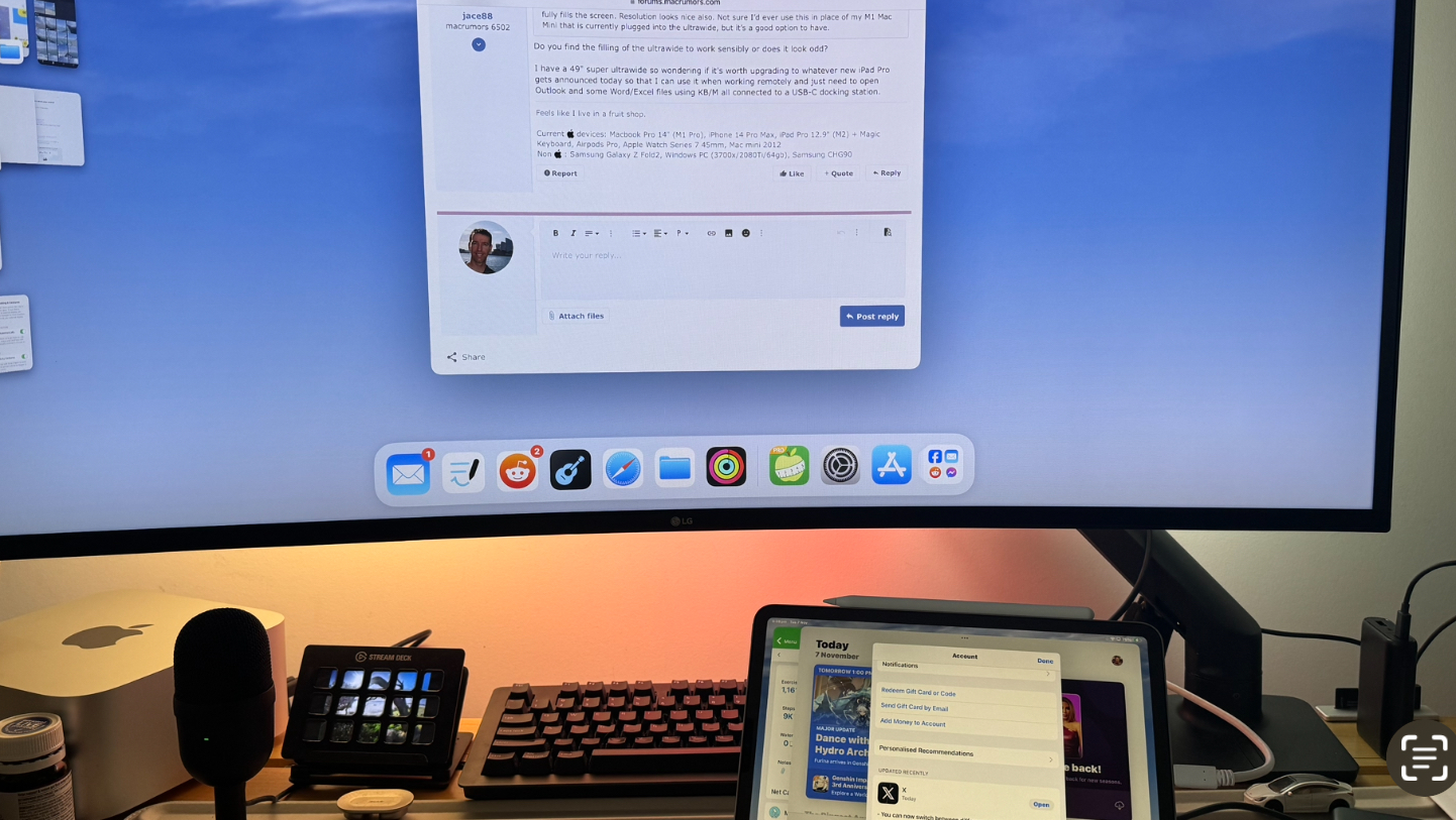

IpadOS 17.2 Ultra Wide via Thunderbolt is working here , although the big screen has it a little chunky, I tried it also on my LG ultra fine 21" it looked spectacular on that display. IMG_0846.jpeg
