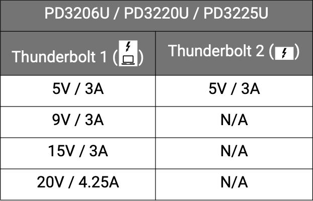

Thanks @yonz1138 for clarifying that the two USB-C ports are both Thunderbolt. The manual refers to both USB-C ports as either "Thunderbolt" or "USB-C" depending on which model you have, which confused me. But as you said, it still doesn't answer why the 'main' port with the display icon causes the iPad to shut off when fully charged.
I found the part in the manual you're referring to regarding the power delivery, and yeah it seems that second port has lower power delivery and can only do 15W. As a side note, BenQ needs to do a better job of conveying that "Thunderbolt 1" and "Thunderbolt 2" in the screenshot below are "Thunderbolt 3" ports, but in this case they're referring to the physical port number (which is represented by the brackets). So confusing!
Regarding low power sources, any iPad will admit power sources lower than 20W. Even the older 5W chargers Apple used to include with iPhones charges the iPad - it just takes several hours to get a full charge. I plugged one into my M4 iPad Pro and the battery icon turned green. So at least that makes sense as to why the second Thunderbolt port is able to charge the iPad!
