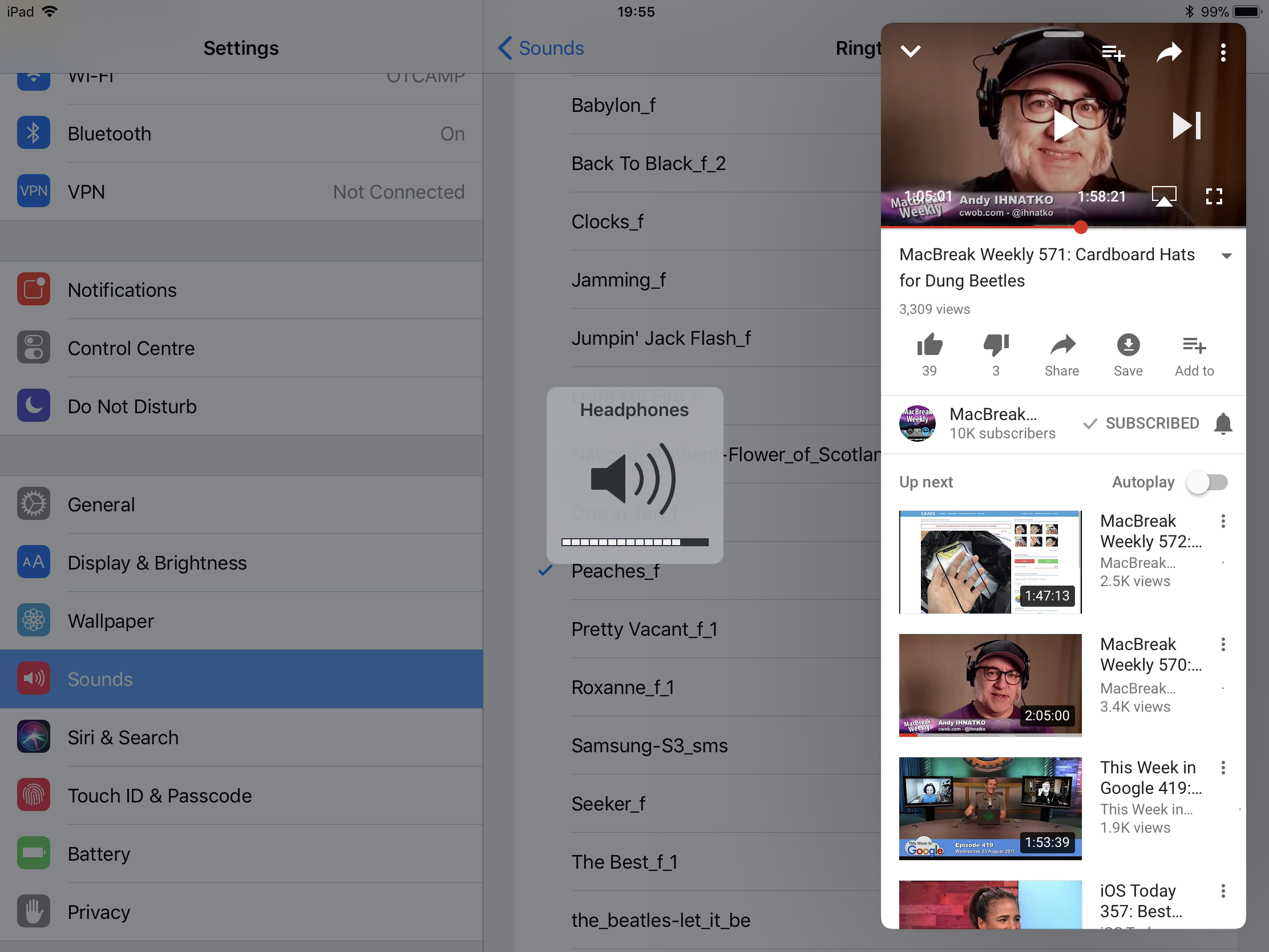

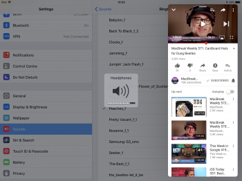

my ipad pro 10.5 is stuck on headphone mode since PB 5
i can use blue tooth headphones(airpods) but cannot use external built in speakers
when testing the sounds the speakers work, for example ringtone, and messages
however once back to home screen the volume indicator is Headphones.
it only happened since PB5
the ipad has never had a wired headphone connected prior as i have Airpods
any suggestions, is it ios 11 related, or has something gone wrong with the hardware headphone jack?

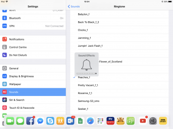

When I select a ringtone the speakers kick in?
Then multi task back to headphones
I think it’s software
