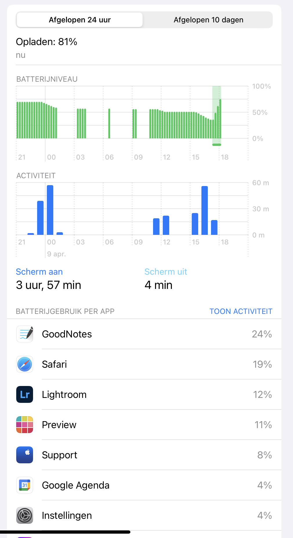

Hi all, my iPad Pro m2, 11 inch, that is 3 months old now, has battery drain since I’ve updated to 16.4 when it came out. With battery drain I mean that it is draining 20% an hour while I am for example only using it to read a book, let alone while I edit photographs in Lightroom.. It’s not draining on standby.

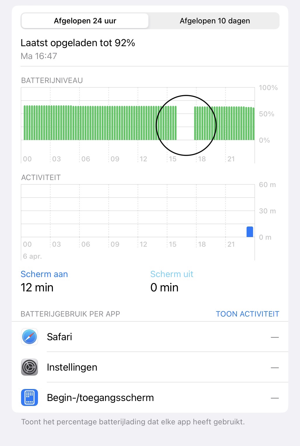

But the weirdest part is that it’s also having gaps in the battery stats. I’ve added a screenshot where you can see one such gap. My iPad was not rebooting, it just was on, and the gap is 2 or 3 hours ( I think?).
The battery usage stats are also not listing which apps I’ve used. Not listing correctly how long the screen was on. For example it says my screen was on for 12 minutes between 11 and midnight. But it was on for the last 45 minutes. (Between 11.00 and 12.00/ midnight).
It makes me a little bit nervous, because my old iPhone 7 had the same behaviour regarding the battery and battery stats. Also after two new batteries. And the batteries from the iPhone 7 I had, had problems (acknowledged and replaced under warranty by Apple). So now I see the same symptoms on my iPad Pro; battery drain and gaps in the battery stats etc., and I’m slightly worried I’m having a bad battery again? Or is this just a bug in the new iPadOS? prior to updating to the latest OS I haven’t noticed this behaviour. So I guess I’m leaning towards a bug. Or maybe it’s wishful thinking :)
On my old iPad (6th gen.) I have never had this problem and on my iPhone 11 I’m not seeing this behaviour either.
Does someone know if I have to be worried? There’s no Apple Store nearby, it’s a very long drive. Or do more people experience this since iPadOS 16.4? It’s just so weird I’m seeing these gaps every day in my stats and that the battery usage is not listed right, since updating the OS. Thanks!
