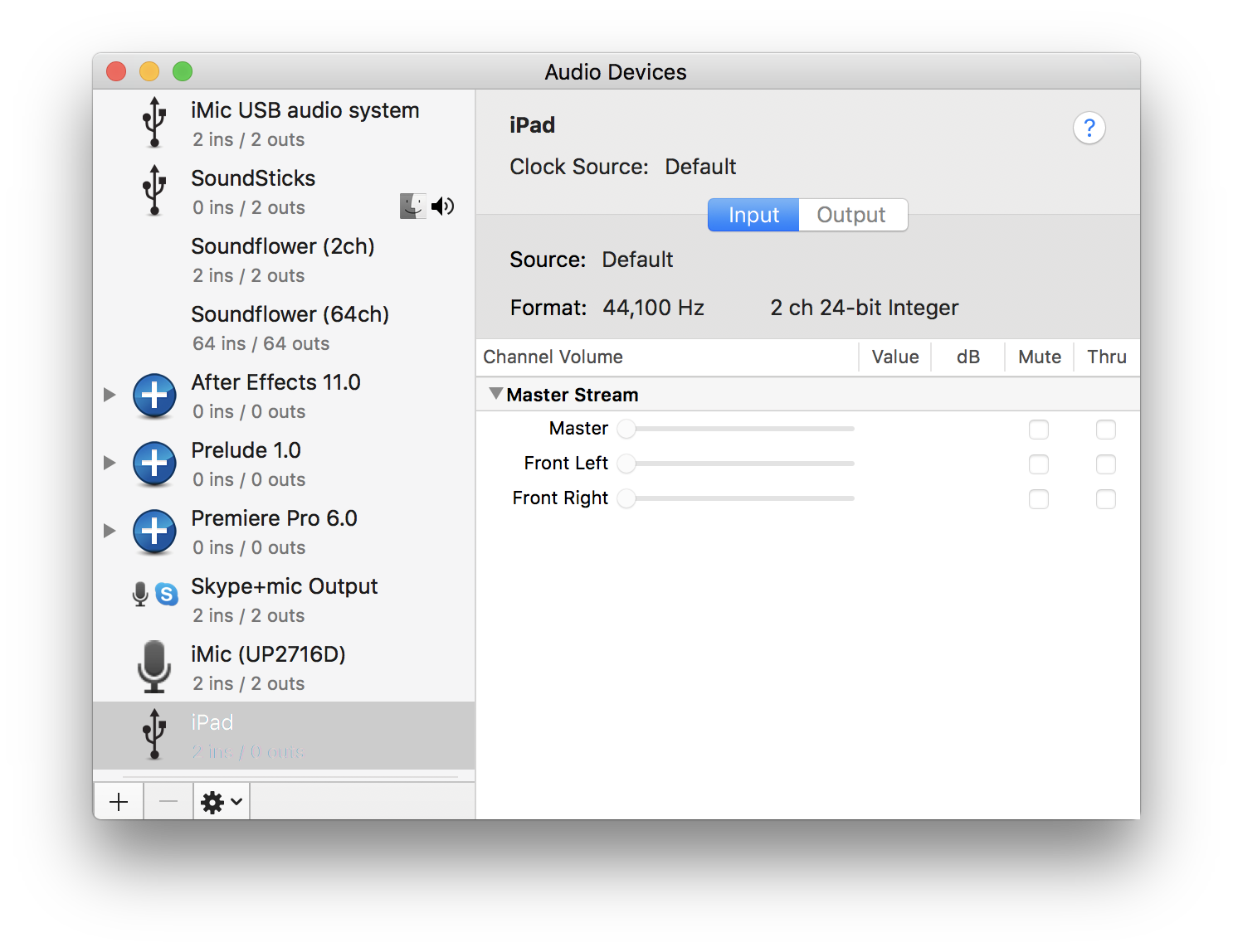

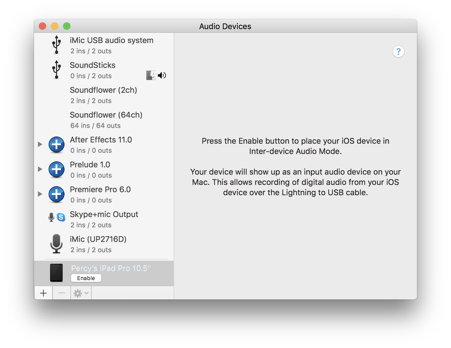

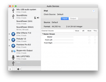

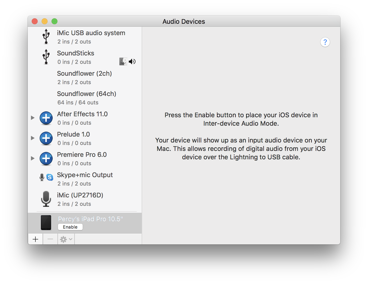

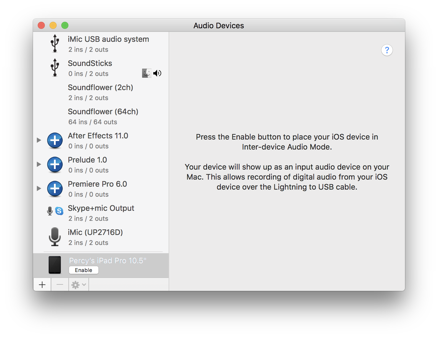

Thanks for the pointer. Wow, I have used iPhones/iPads since day one and never realized they have added this functionality. You are correct, both my iPad Pro 10.5" and iPhone X can act as an IDAM device when connected to an iMac (via Lightning to USB-C) and an MBP (via Lightning to USB-A) respectively. They show up as input devices through Audio MIDI, once enabled they can be routed/used as 44.1kHz 24bit input for any macOS audio apps that access CoreAudio.
Screen Shot 2019-04-10 at 11.04.34 .png Screen Shot 2019-04-10 at 11.05.13 .png
View attachment 831466 View attachment 831465
