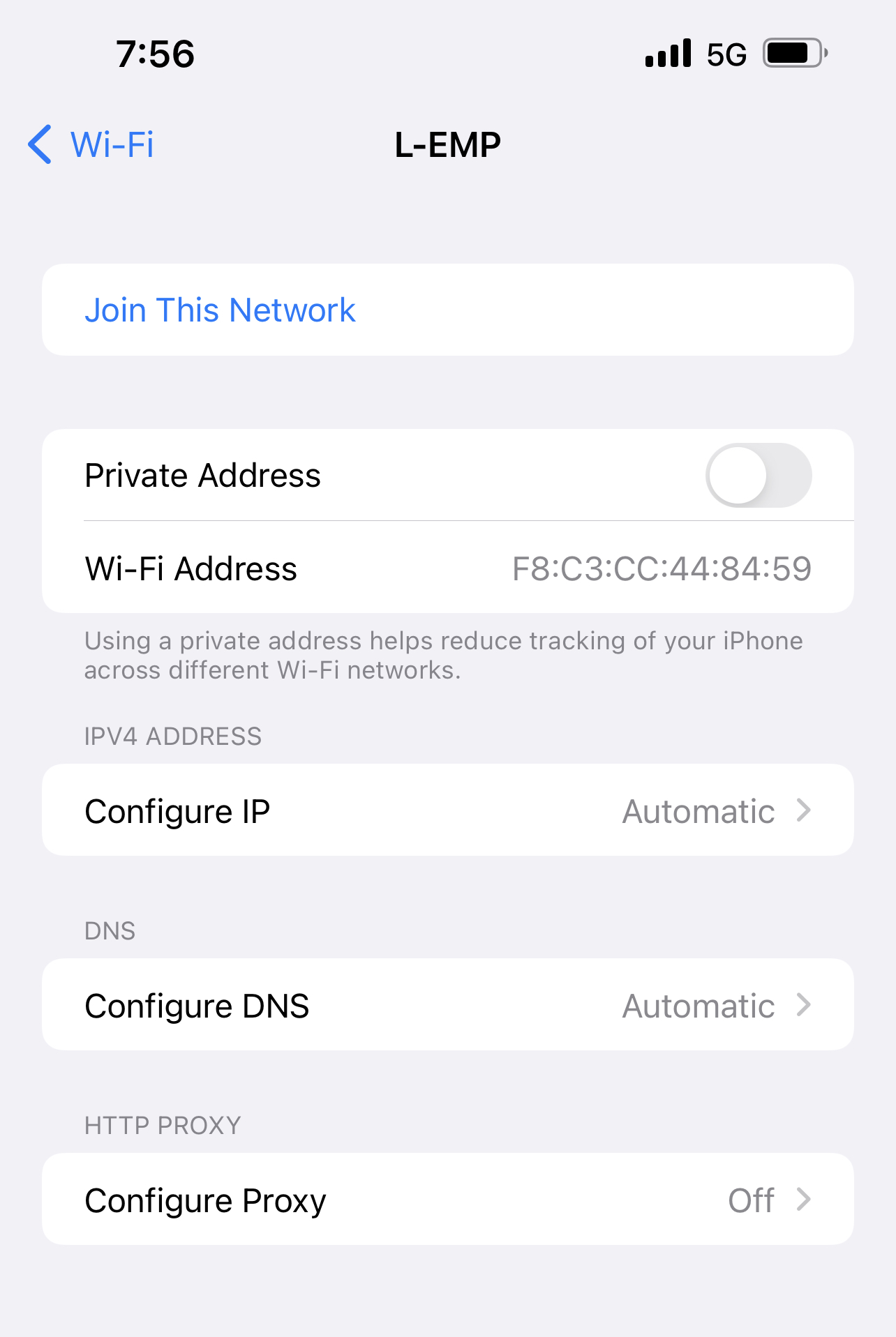

I noticed that turning off Private address fixed my issues
Reactions: now i see it
