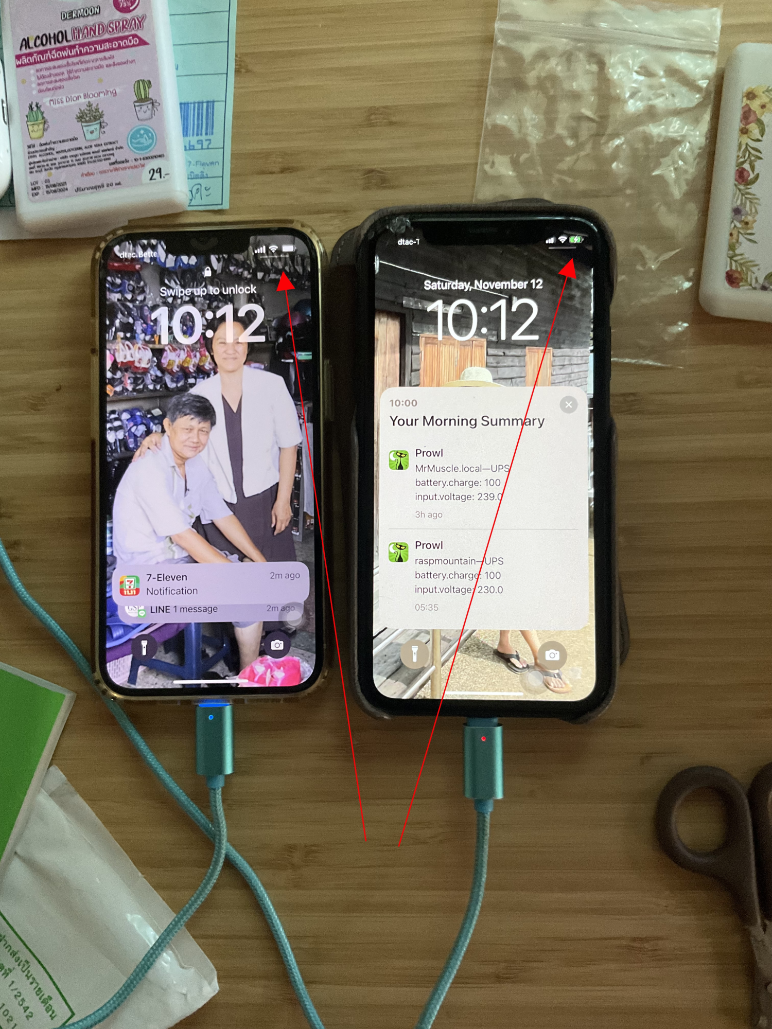

We have a multitude of charging stations and cables in our home, car, condo and travel kits. All of this stuff continues to work with every device we have including my XR, a couple of AirPod Pros, an iPad mini 5, Magic Keyboard and Mouse, etc. Suddenly, my wife's iPhone 13 stopped working with all the cables we have except for Apple branded cables and one UGreen that I bought years ago. Even Anker MFi certified cables don't work anymore with the 13.
I've checked and cleaned the lightning port on the phone, but that didn't help.

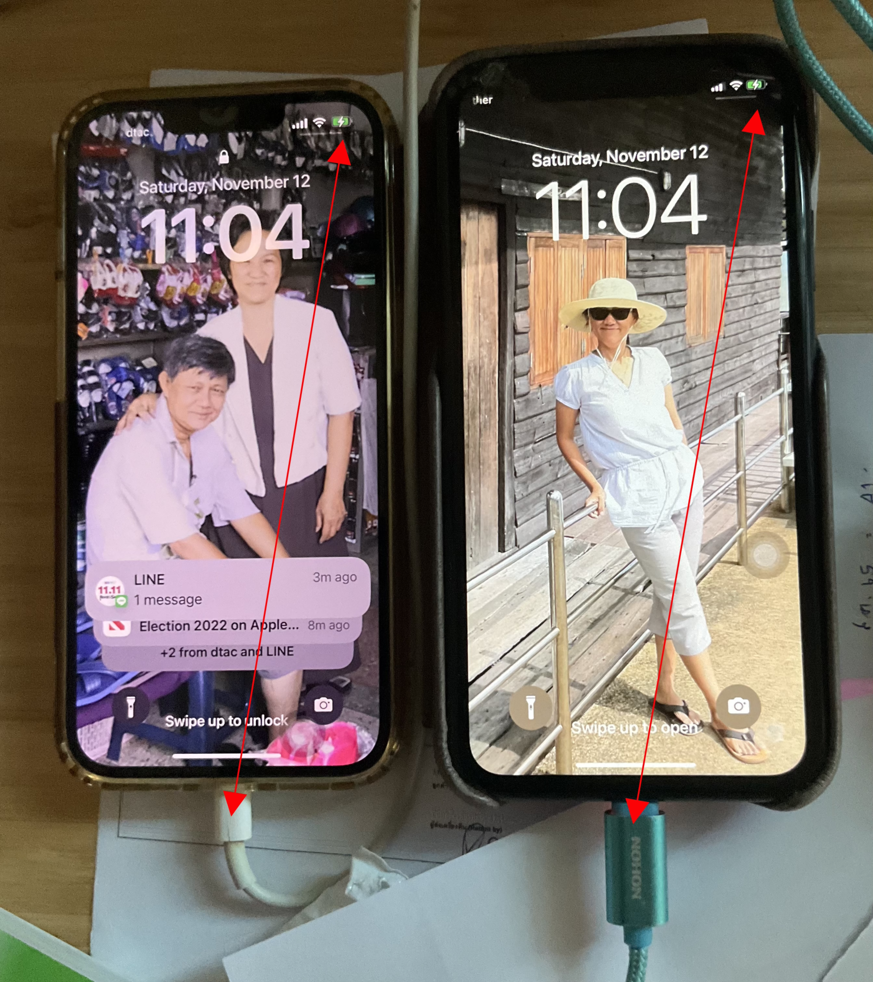

There's no message on the 13. I know it's not the charging bricks because every other device works fine with the brick/cable combination. As soon as I plug an Apple cable in the brick or USB A port, it works fine with the 13. I've tried this with an Apple brick, two Anker bricks, the USB A port on my old iMac, the charger in our car, etc. They all work with my iPhone XR, but not with my wife's.
Identical charging cables plugged in to the same charging brick. Swapping the two cables makes no difference. XR charges, 13 doesn't.

Here's how I discovered this situation: A few days ago my wife came home from work and asked me to check the cable in the car because she couldn't charge her phone on it. I took my phone out and it worked fine. Her's didn't. I took an Apple cable to the car and it worked fine on her phone.
Then I went through the long process of swapping cables and devices on the handful of charging bricks we have in the house. What I discovered was the every single cable we have, including in my box of temporary discards, works fine with my iPhone XR. The only cables the work with her iPhone 13 are the Apple branded cables (including some really ancient ones) and the one UGreen cable.
I have now cleaned her Lightning port twice. It didn't help.
None of this makes any sense to either of us. Plus it means going through our house, condo and travel kits to replace every cable with an Apple branded cable. What a mess.
