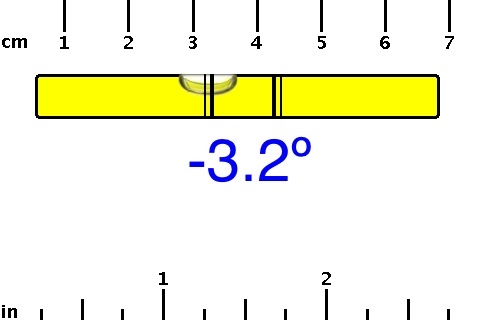

Just recently I downloaded A free bubble level from the app store and noticed that my accelerometer was off tilting to the left when putting it flush on a straight table (and other flat surfaces). I thought it was just the app but I noticed all of my apps that use the acc were doing the same thing. My wifes iphone interestingly performed a bit better than mine (-2.0 degrees) but was still off a little hanging to the left. One of the reasons this peaks my interest is that all of the reviews for this app claimed that it was reading accurately.
What kind of results are you getting with your iphone acc?
http://pathtracks.com/help/bubble_level
Its called "a free level" in the itunes store if you care to experiment.(Dont know how to link to the itunes store)

if you have a real ruler with the leveling bubble in it see if its the same on the same table.
Well, even if that is the case it doesnt explain why my wifes phone would read different than mine.
