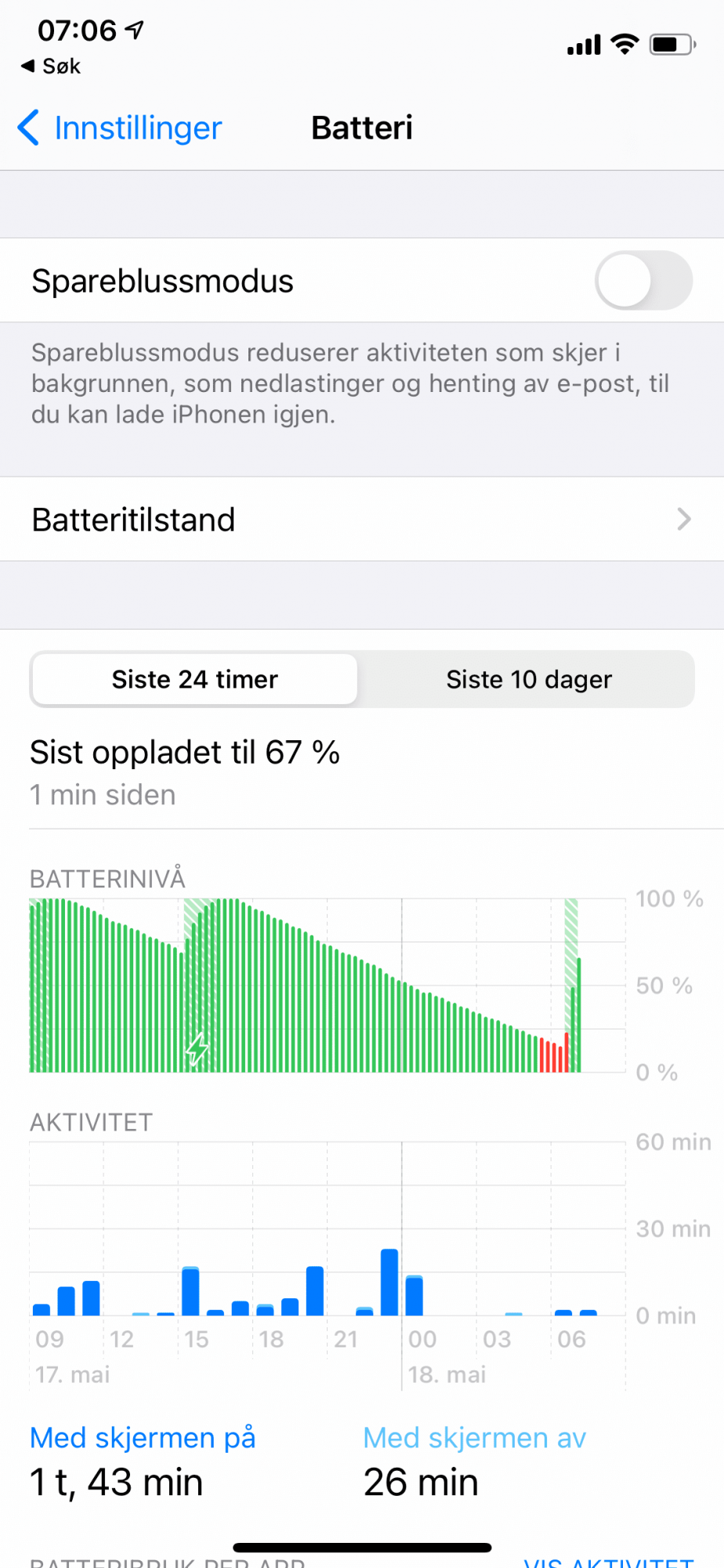

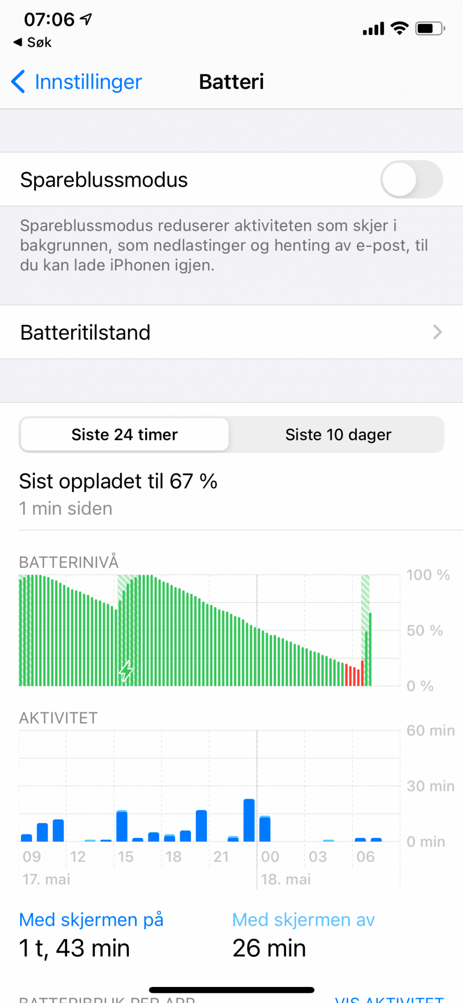

Repeatedly, but not consistently, my phone has been draining from almost full at bedtime to almost empty in the morning. Usually it only use a little, say ~5-10%.
The maximum capacity of this XS is currently 93%. Looking at foreground or background battery use I don't see anything that would explain this. It is as if data is missing, which leads me to suspect a system service.
The phone is not warm. I don't think I have seen it before 14.5, possibly 14.5.1. My usage patterns haven't changed. What would you suggest to troubleshoot this?

I have rebooted the phone every time I have noticed this pattern, and that seems to resolve it—for a while. It works fine for several days, then comes back. Noticed it again today, when it drained from ~80% to ~25% during one with only sporadic use. It usually lasts all day.
I don't use many apps. Occasionally play the Simon's Cat game from Apple Arcade.

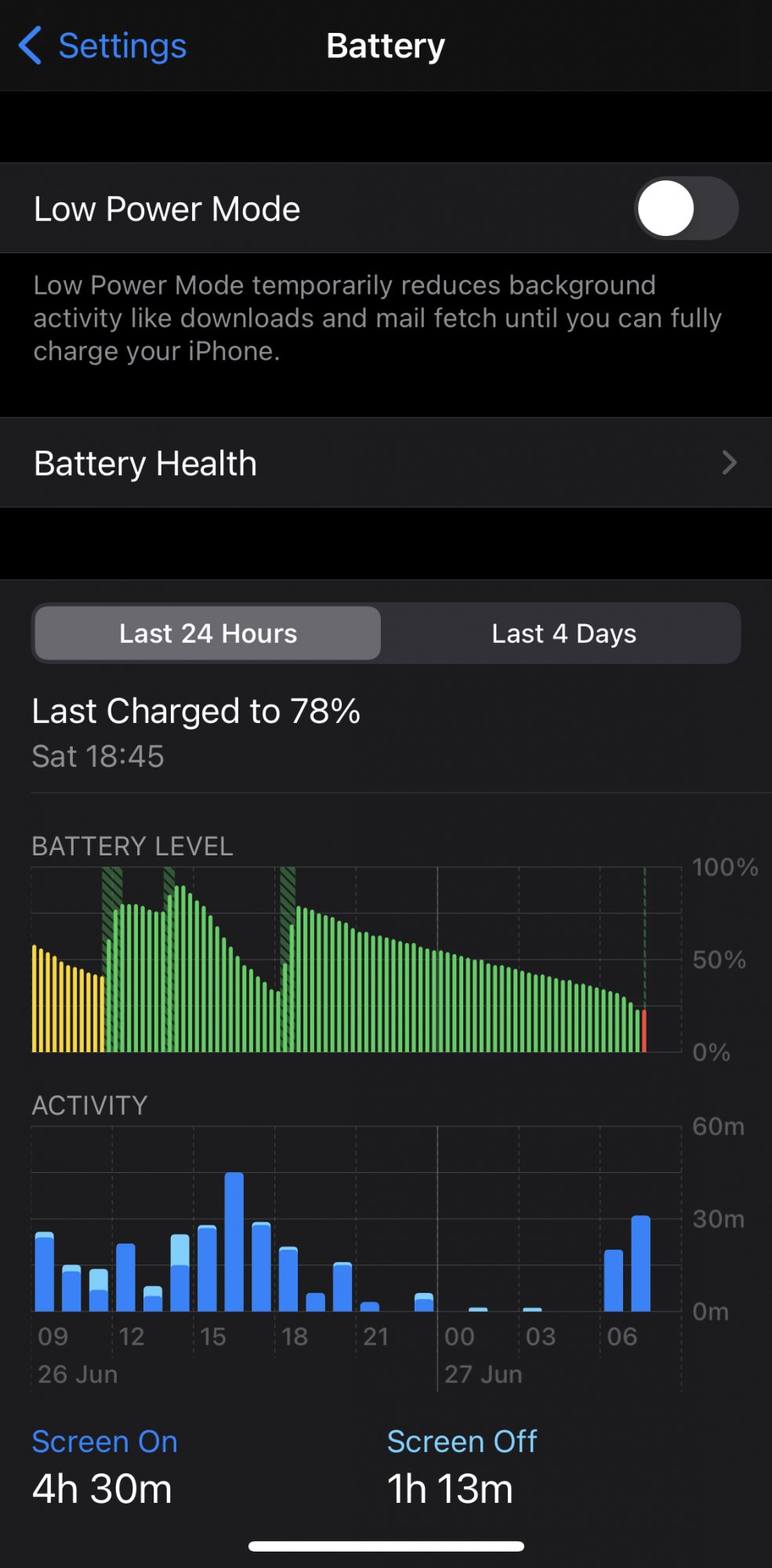

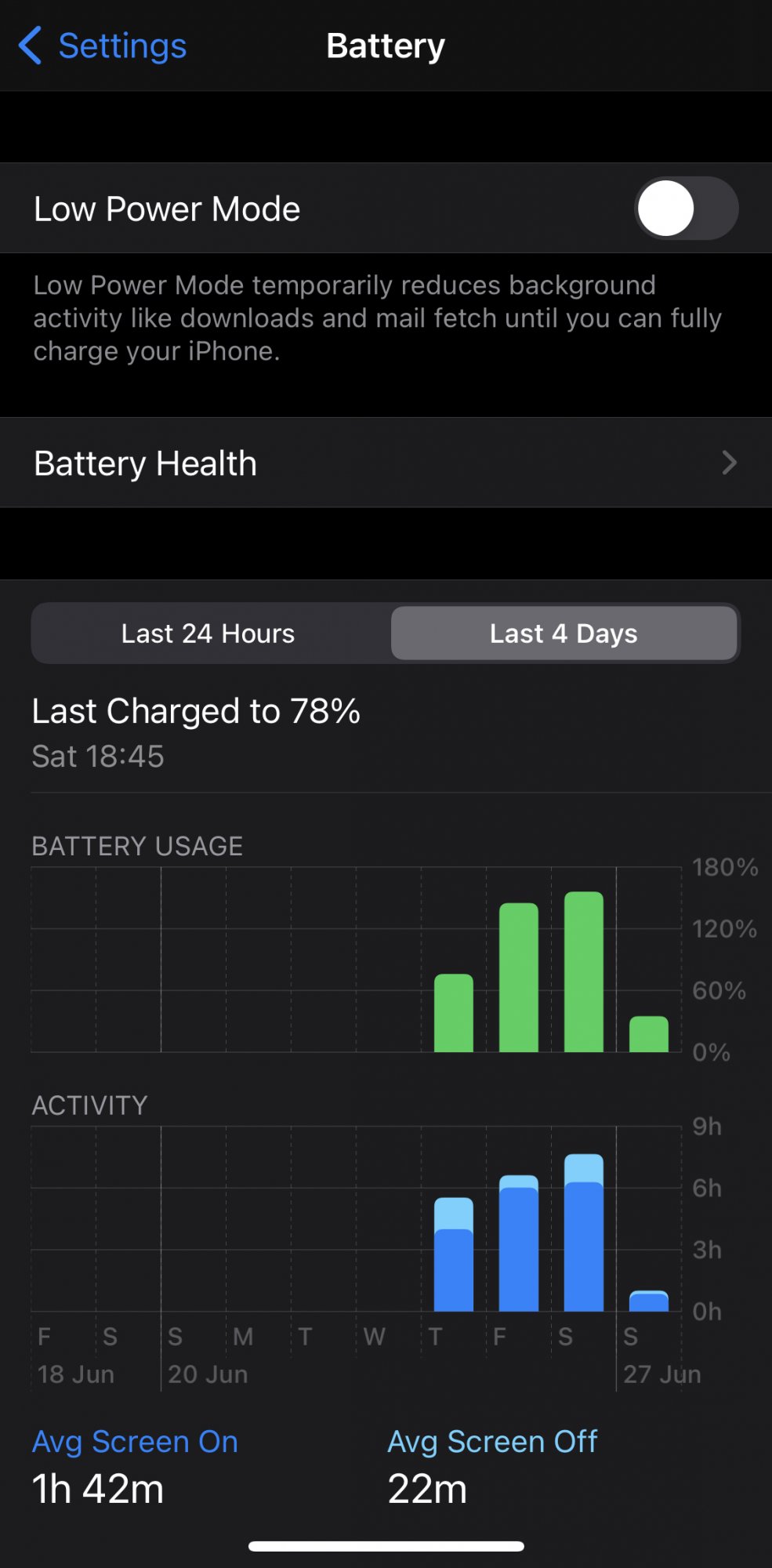

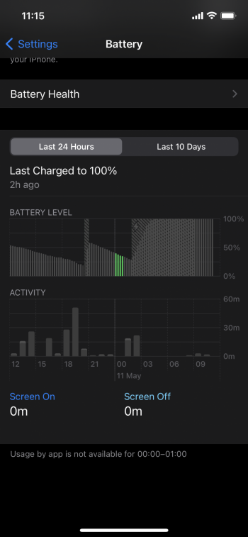

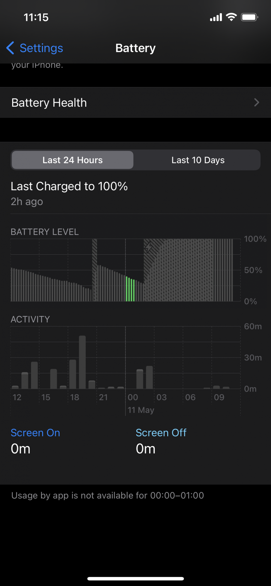

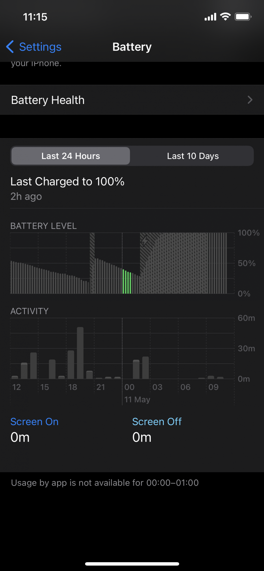

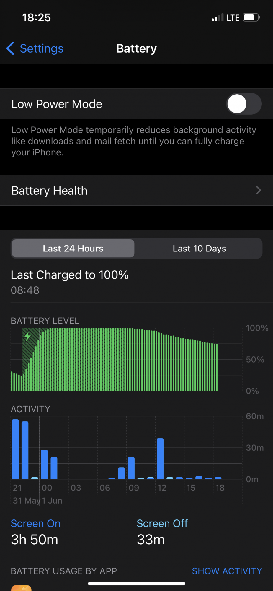

Here are some screenshots.

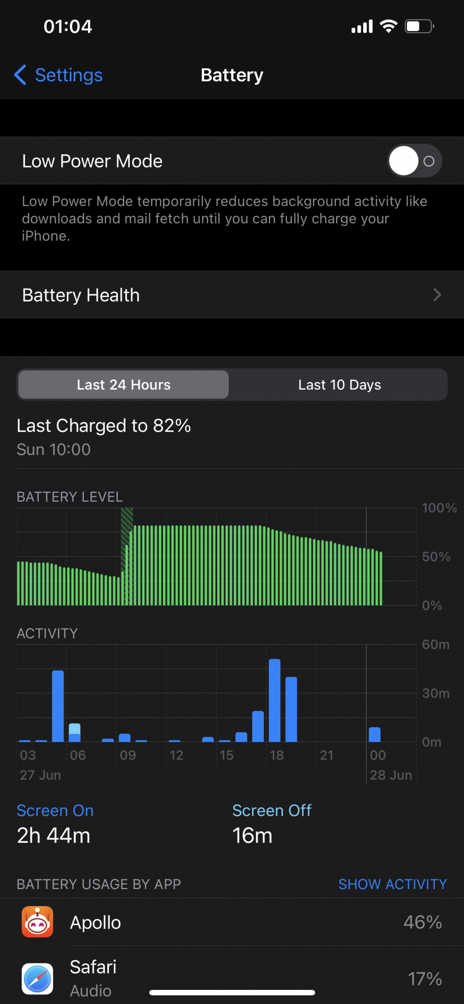

This one was taken yesterday with iOS 14.6. The drop to 90% is plausible, I used the phone for one hour. But the drop afterwards to 75% is absolutely unexplainable and I don't get such drops by not using the phone on other days. The phone was next to my work desk the whole time with the wifi router five feet away.
Here is another from a few weeks ago when it all began. The battery drained from 12 a.m. to 3 a.m. regardless of usage. I've even marked the one hour section after midnight which shows zero minutes of even touching the phone but it dropped from around 40 to 30% in this time. I charged the phone through the night and the next day the drain stopped, coming back some days later.
It's quite weird and I can't explain why this happens on some days but not on others. My phone doesn't get hot at all - actually I've never experienced even the slightest heat from my phone in the past six months, but I also don't game. It only gets lukewarm when updating for a few minutes, that's all.

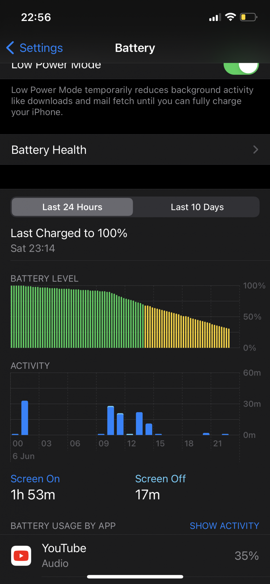

Okay, nothing changed for me and even low power mode and a restart didn‘t help. I‘m gonna reset the phone and do basic stuff for a week to see if things are getting better.

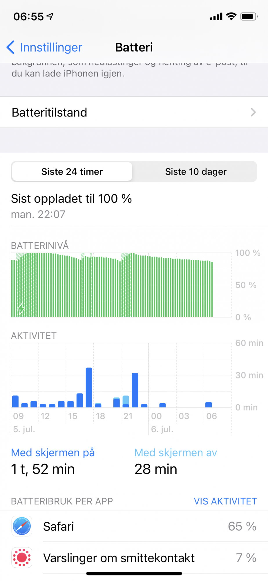

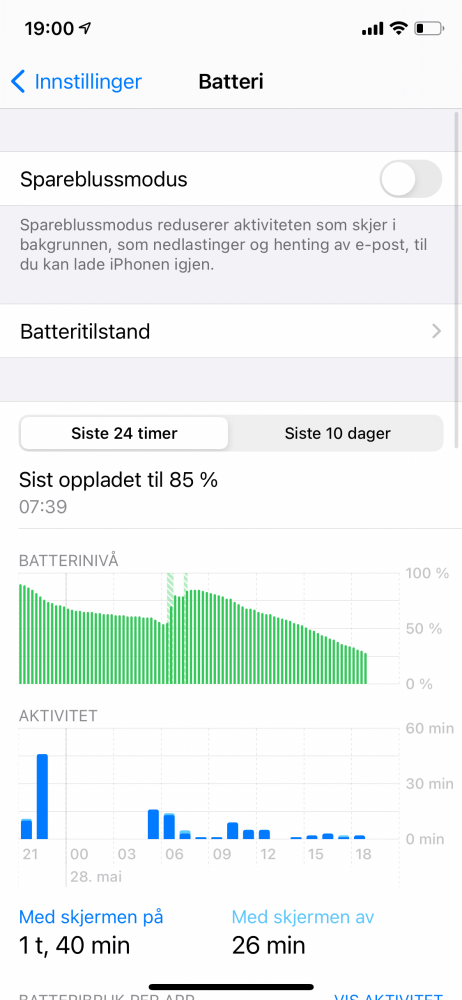

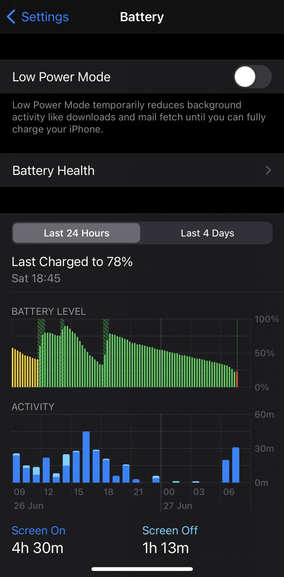

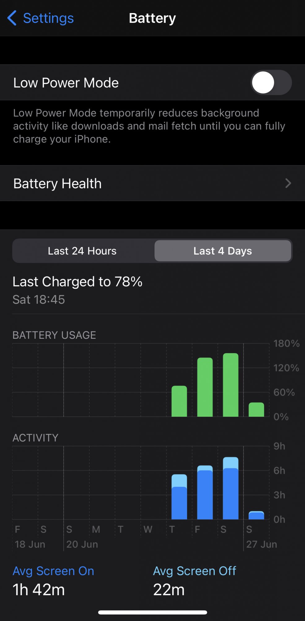

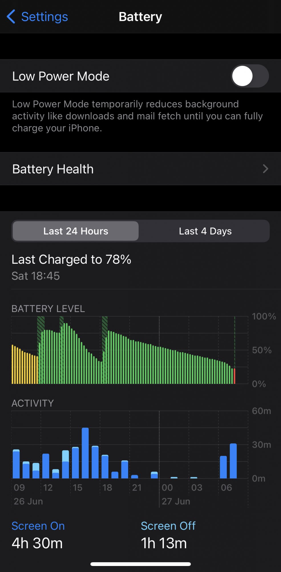

My graph looks the same for last night. Low power mode and zero usage while sleeping, yet steady decline. Do you by chance use an Apple Watch? I got a new watch last year. Other common bluetooth accessories are the original AirPods and AirPod Max. The latter has a bit of a temperament when it comes to bluetooth. I am also enrolled in the Norwegian COVID tracker.
Wonder what the common denominator might be...

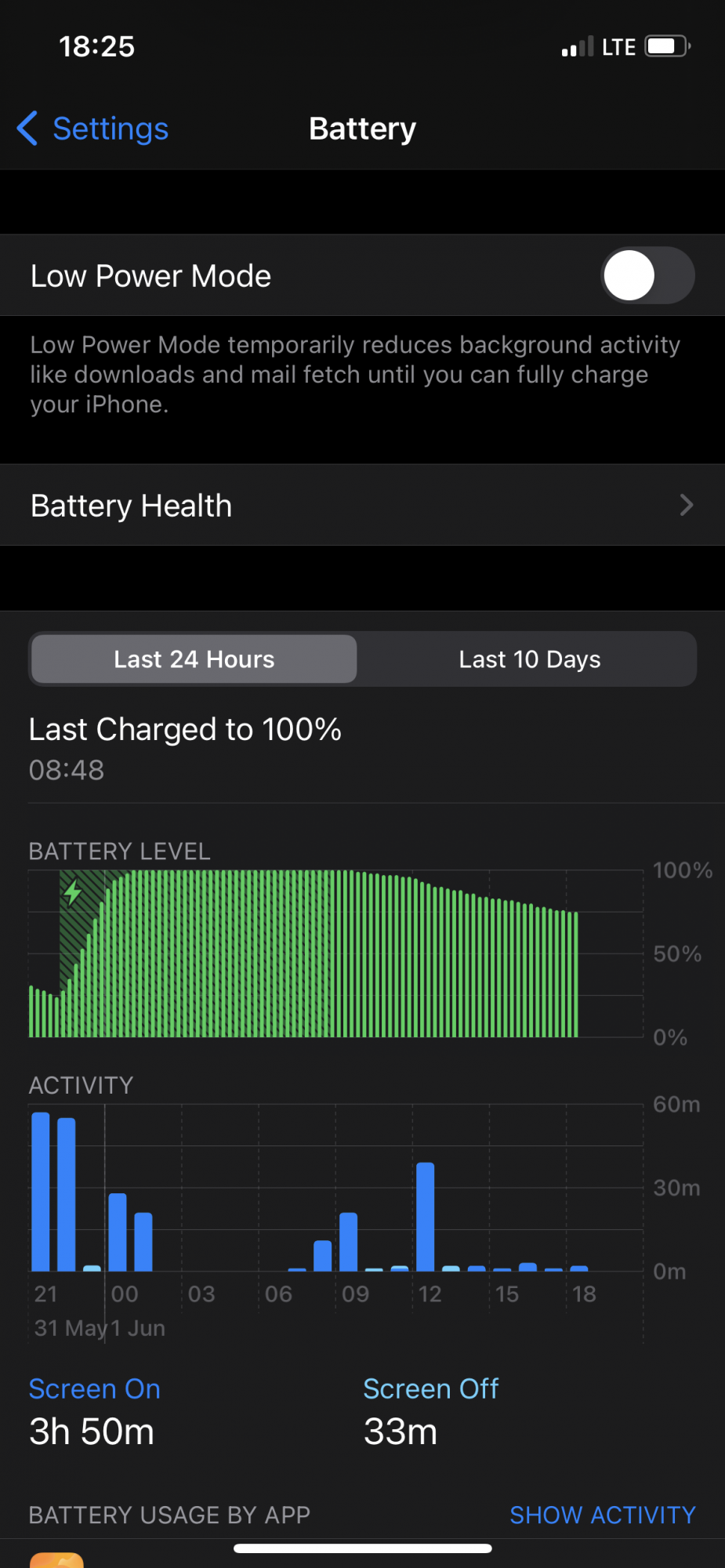

I'm having the same issue and just can't pinpoint it. 14.6, Email.app was running constantly and draining this down overnight - 20-30% drain. I was able to shut that down. Improvement.
But some nights I have 0-3% drain, others I'll have 15-18%. No rhyme or reason...it's just random - nothing shows apps are running in the background draining it.
