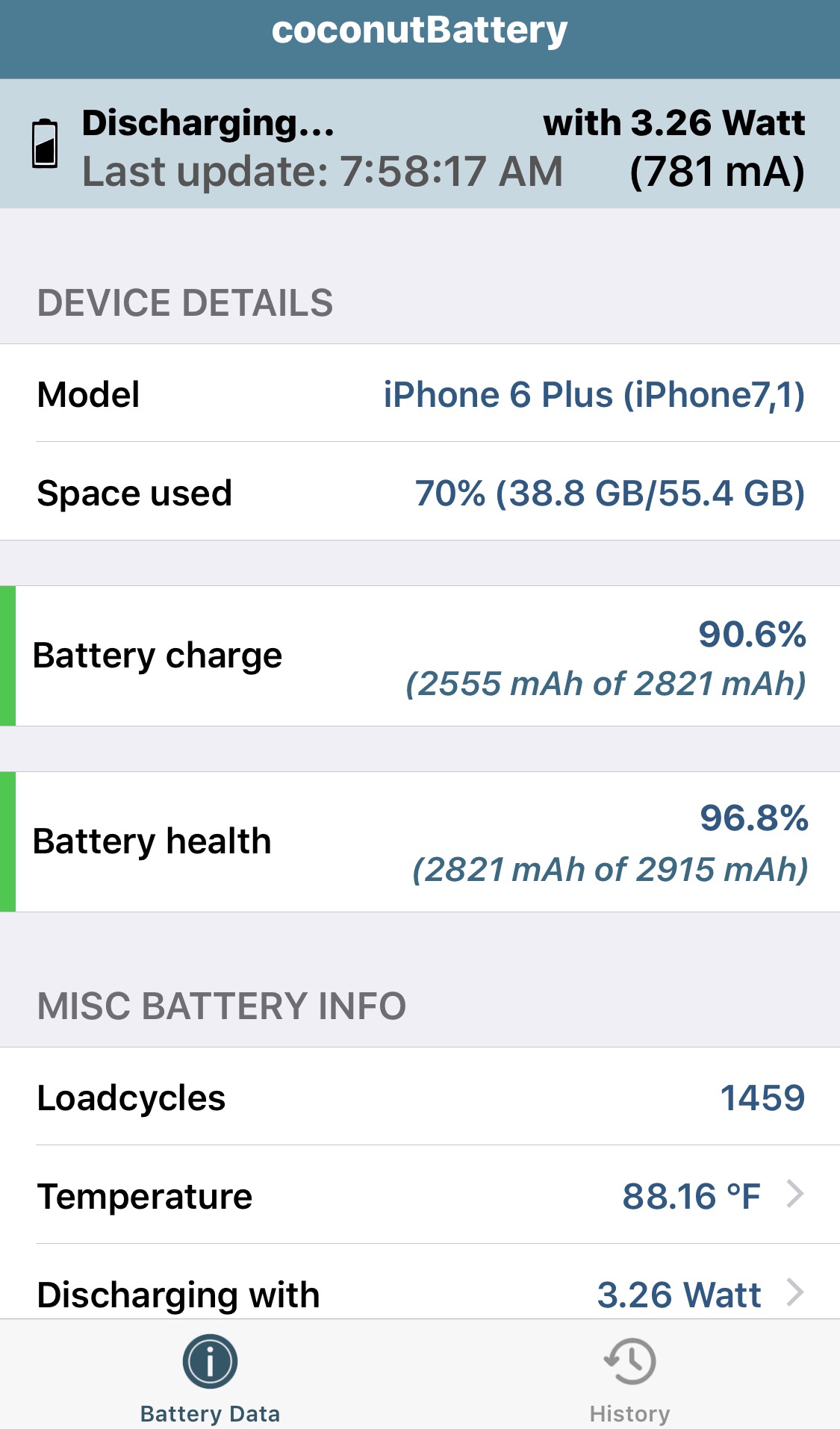

Here's my six year old iPhone 6 Plus. Original battery (running iOS 9)
Interpret it with skepticism
Honestly, all battery health measurements are just an estimate, especially while the battery is still in the 90%+ range.
