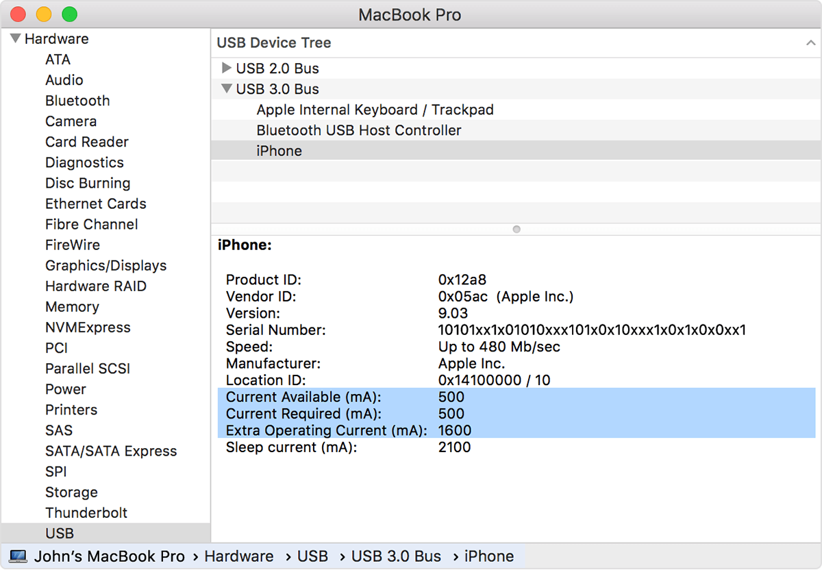

if you open the system profiler on your iMac after connecting your phone, you should see something similar to this:
User uploaded file
In the example above, the USB port offers the default 500 mA, as shown in the Current Available (mA) entry. The Current Required (mA) entry indicates the current the device needs to operate. Extra Operating Current (mA) indicates that this USB port is providing an additional 1600 mA for use with the device.
The ”genuine” power supply, you mention, will probably supply less current.
User uploaded file
nota bene: what’s it with the German luxury fashion house specializing in contemporary clothing and cosmetics?🤓
Thanks a lot; my iMac 27' shows almost the same figures. Now everything is clear.
