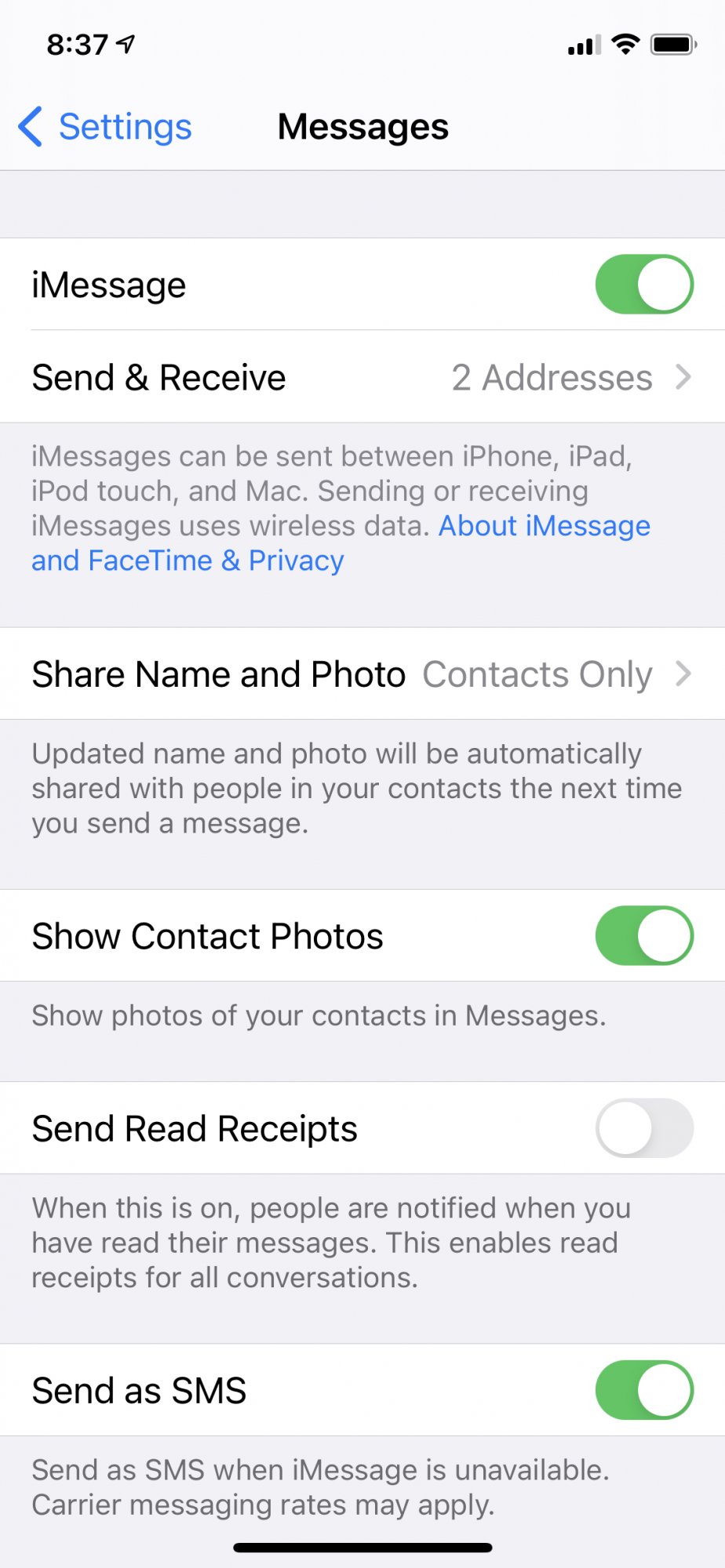

I have an iPhone xR and new M1 MBA, and it's working fine. When you say the "option just isn't there" on your phone, I'm not sure what that means. There's clearly a Text Message Forwarding option under Messages.
There is supposed to be, but I don't have it. It's weird. All of my software is up to date.
Is your Apple ID and phone number checked in the list of Send/Receive addresses?

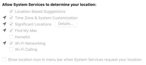

I'll be interested to hear how it goes. One more thought though. Did we talk about location services? Under Privacy & Security > Location Services > System Services, does Find My Mac appear checked?
Thanks for that idea Namara. I wouldn't have thought to look there. Unfortunately, it's on. I even cycled it and still no success.
