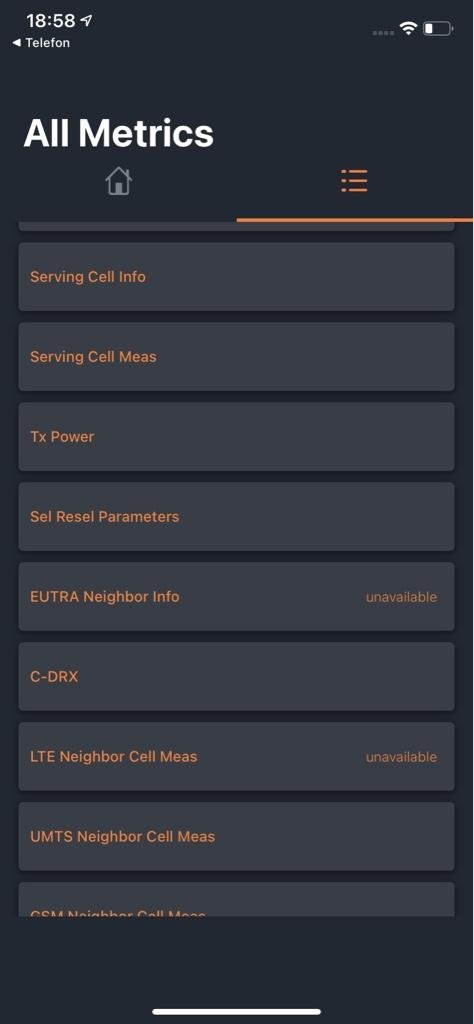

Does anybody geht the field test mode too run especially the LTE Neighbor Cell Meas?
