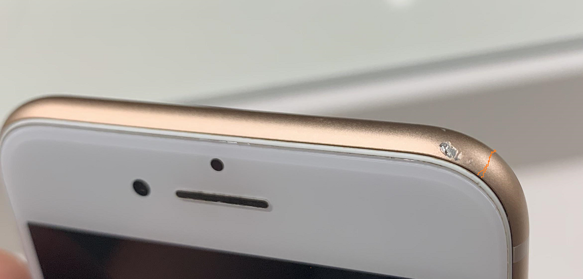

i have been regularly washing my phone for years (iphone 7) and never have any problem by doing that, the phone often falls on hard surface and even have open crack on top right corner.
(illustration photo)
