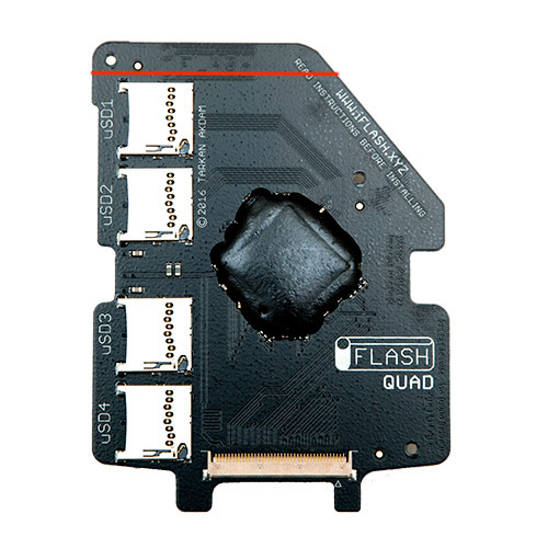

  • iFlash Quad

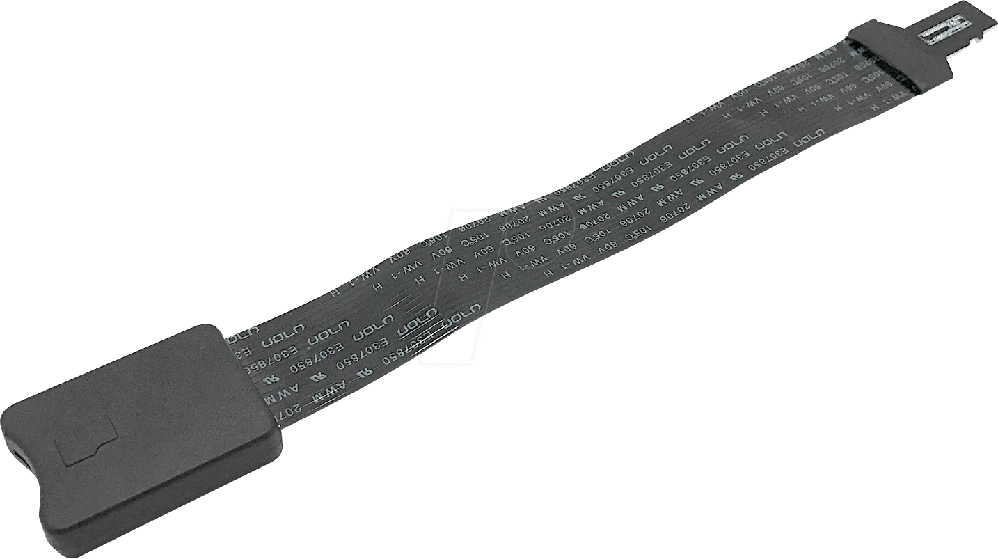

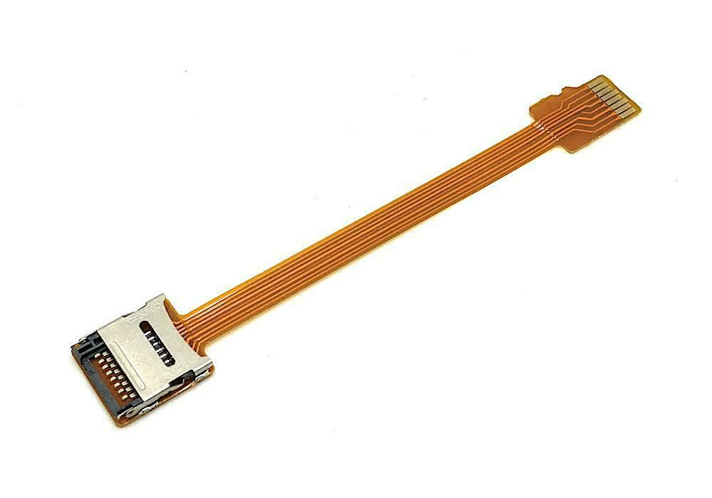

  • microSD extender cable 15cm
  • micro SD TF T-Flash - microSD Verlängerung Kabel Ultraflexibel 10cm Raspberry Pi

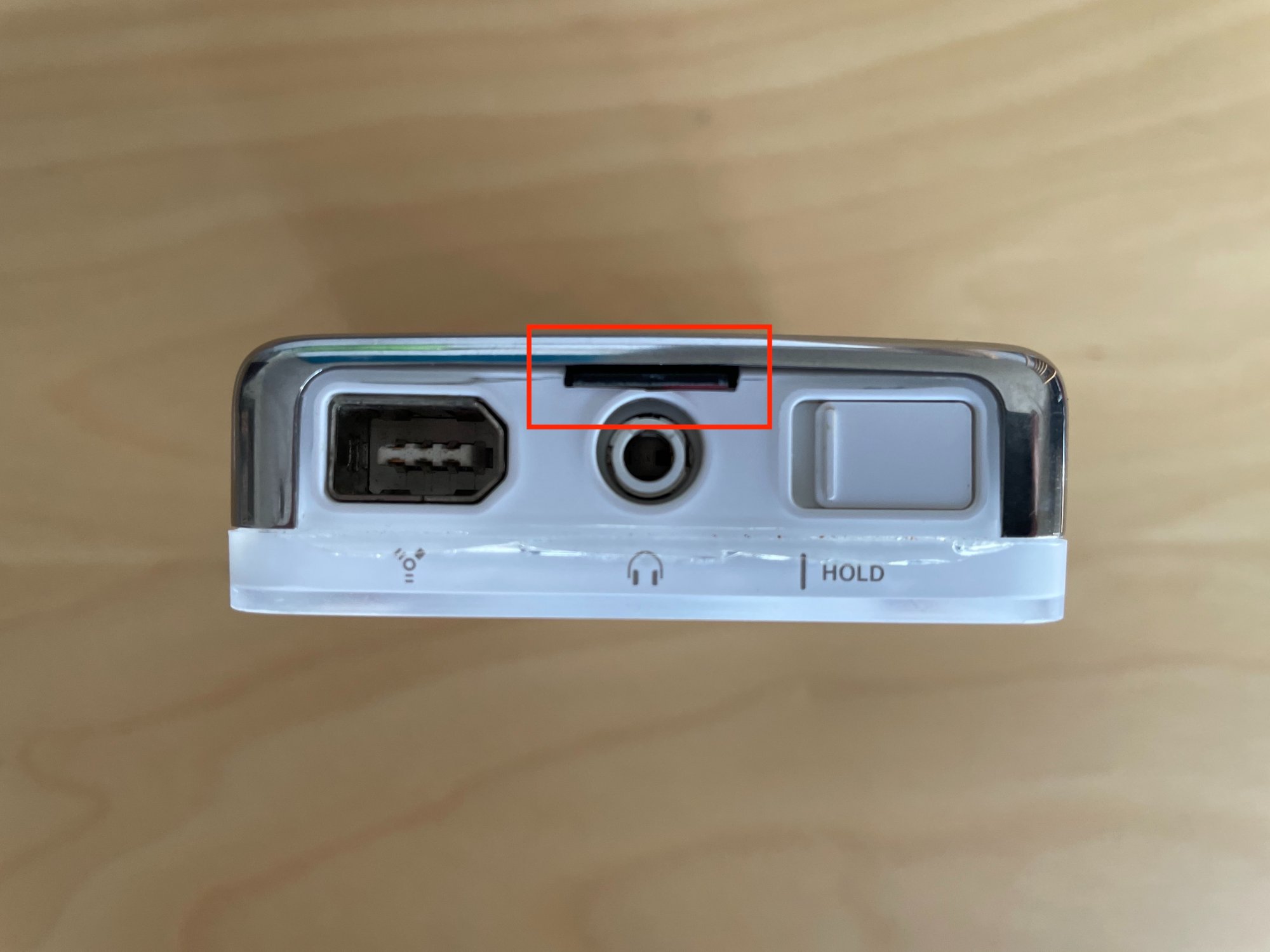

  3. File down a tiny part of the plastic/acrylic front plate right above the headphone port to make the microSD card fit.

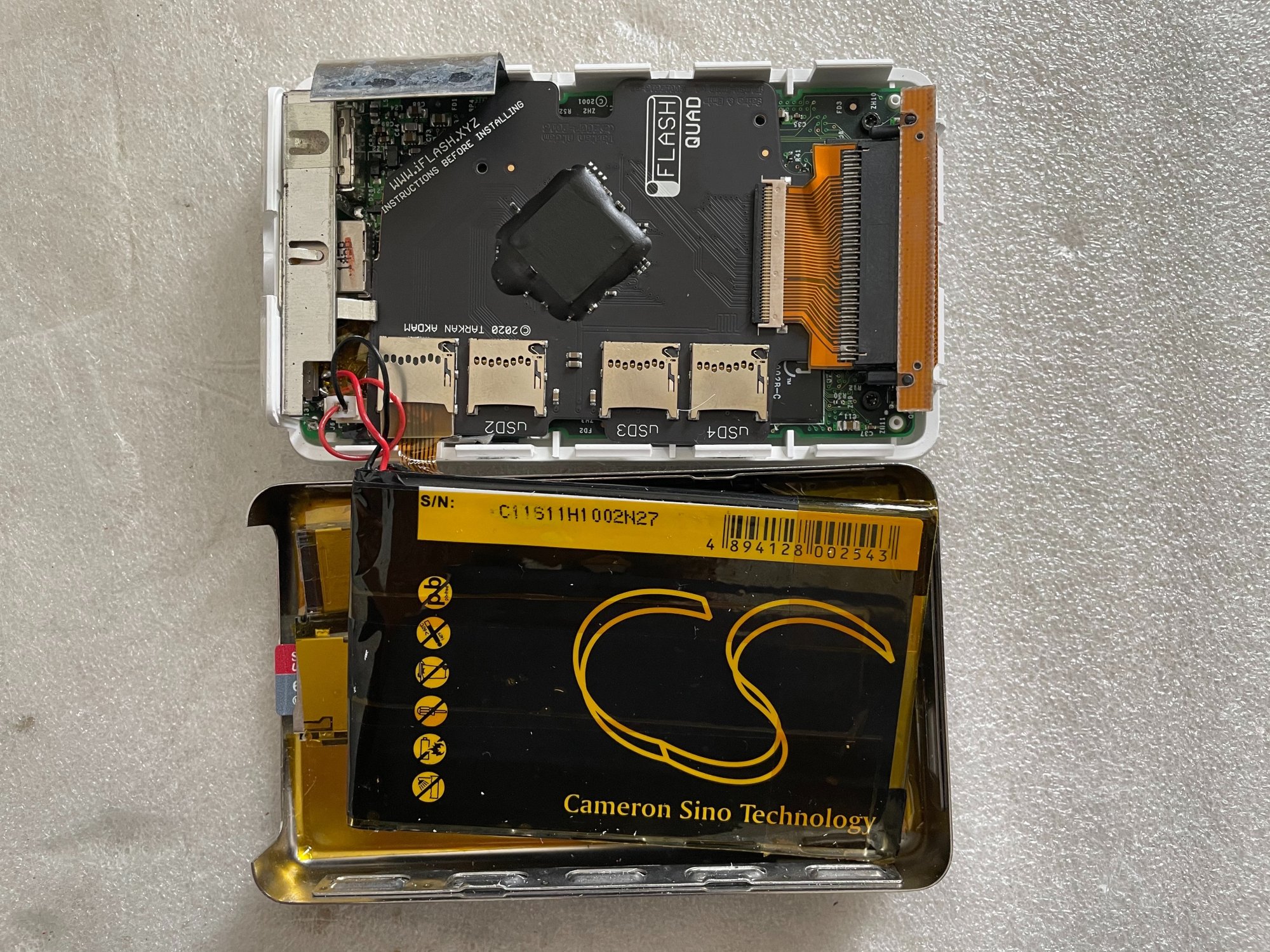

  1. Saw the end of the iFlash adaptor off or use diagonal pliers so it fits flat in the iPod. I marked it with a red line.
Pasted Graphic 4.tiff

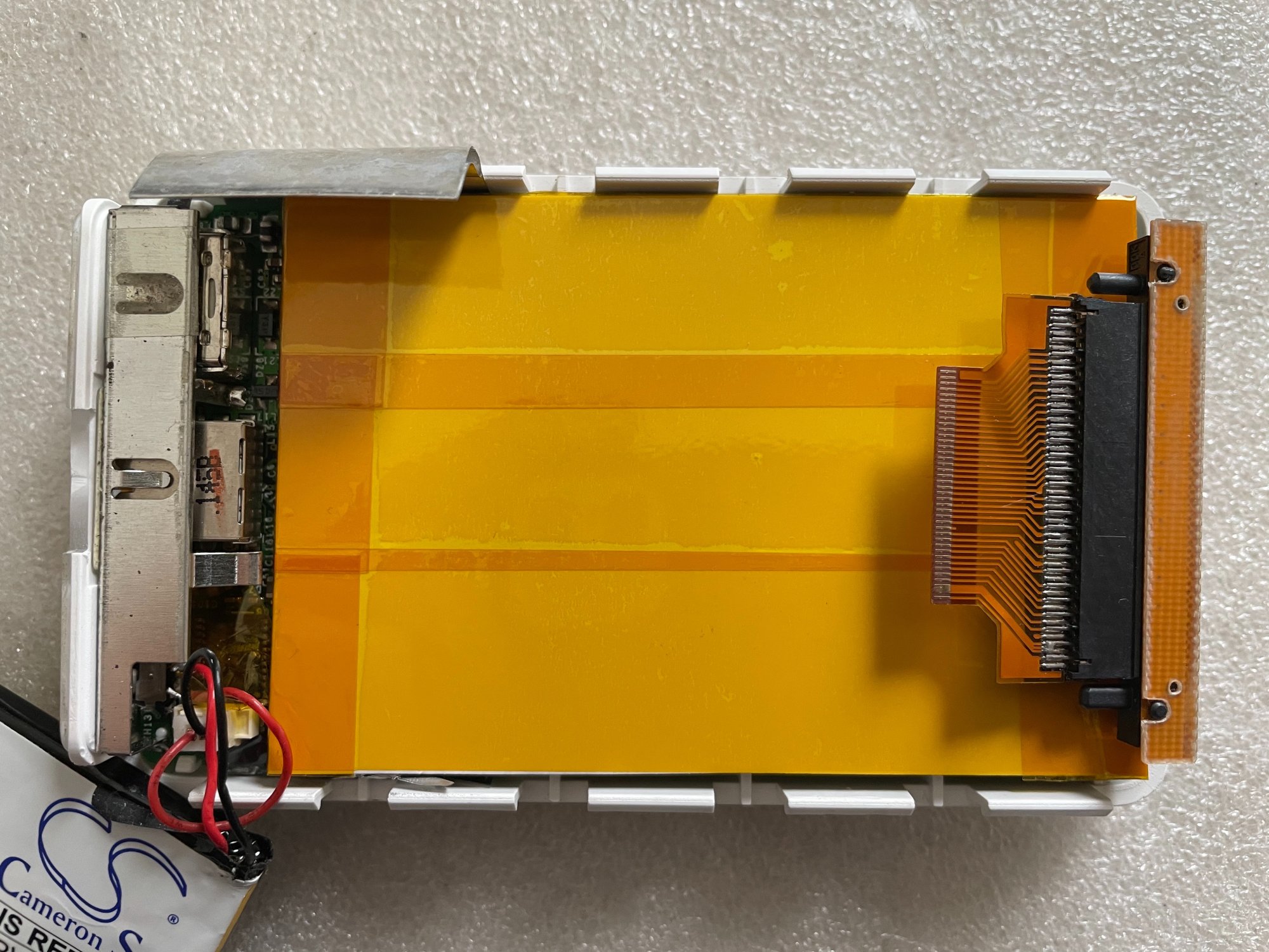

  1. Cut a piece cardboard to make it fit between the logic board and the iFlash Quad adapter to reduce static noise, that occurs when the iPod is loading mp3 file to the RAM. I also used antistatic tape. Much better.

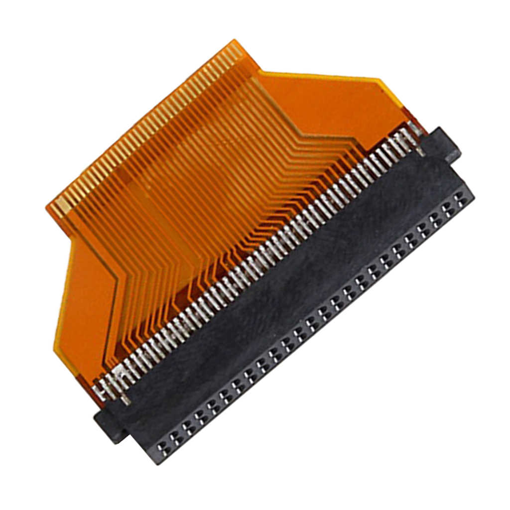

  2. Install the 50 Pin IDE to 40 pin ZIF adaptor.
  1. Connect the iFlash Quad adapter.

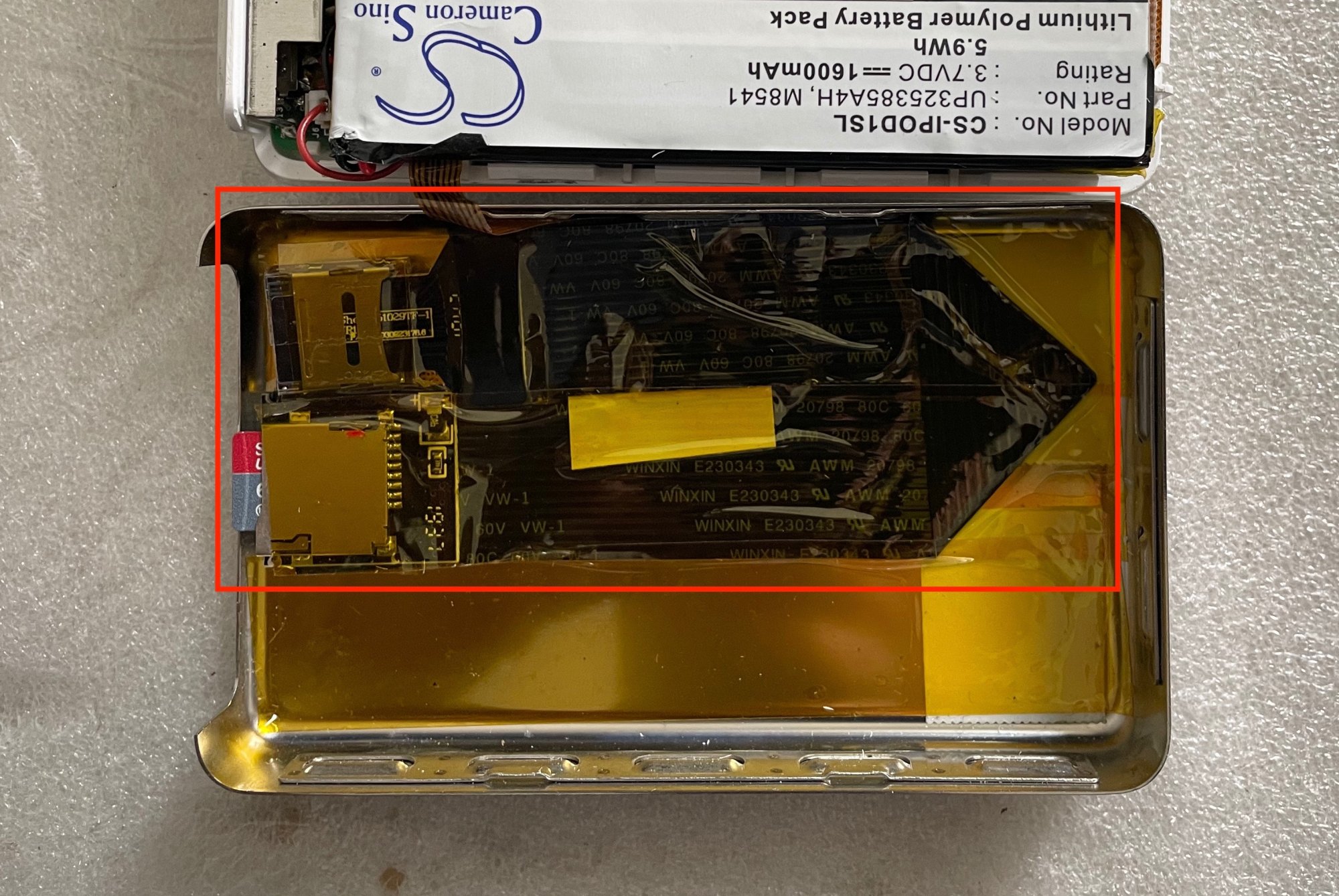

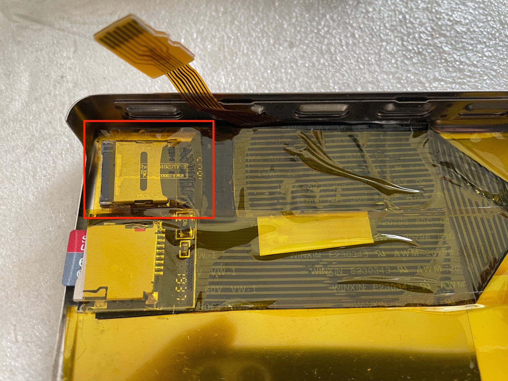

  2. Remove the plastic housing of the microSD female port of the microSD extender cable. Use a double sided tape to attach the female port of the extender cable to the back plate (use a 1 mm piece in between, so that the microSD card can spring in and out smoothly). Connect the two microSD-extension-cables and tape them to the rear cover as seen on the photo.
Pasted Graphic 5.tiff
Pasted Graphic 6.tiff
  1. Insert the extender cable into the iFlash Quad adapter and connect the battery.
On the photo the battery is connected with another little mod that is not needed for this mod. More information at the end.
  1. Close the iPod.

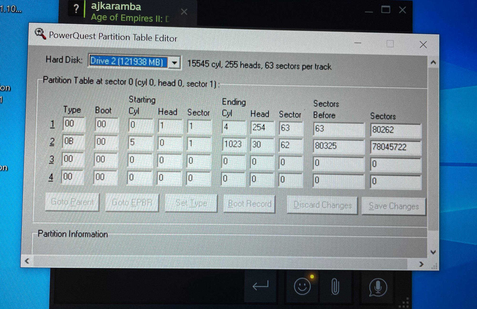

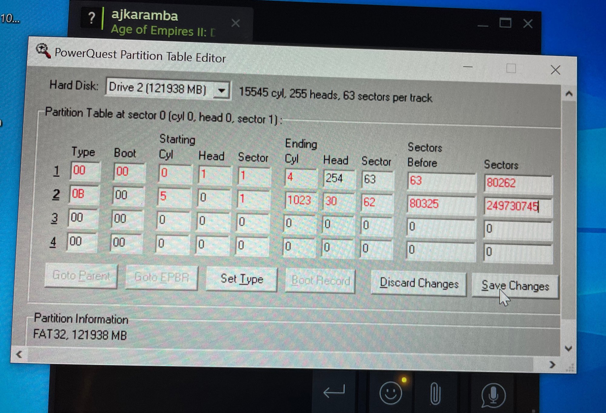

  5. Open PowerQuest Partition Table Editor as admin: first select the correct drive (e.g. „Drive 2 (121938 MB)“, take a photo of the values.
Pasted Graphic 3.tiff
  1. Open a partition manager and extend the FAT-partition (4,X GB) to the maximum of your card. Press execute. Now the microSD can’t be read correctly any more. You have to update the partition table.
  2. Open PowerQuest Partition Table Editor as admin: first select the correct drive (e.g. „Drive 2 (121938 MB)“, change all the values to the old ones (look at the photo) except the last in the second line (change 78045722 to 249730745), you can check the right value in the field „Partition Information“, just calculate the right value, save changes.
Pasted Graphic 2.tiff

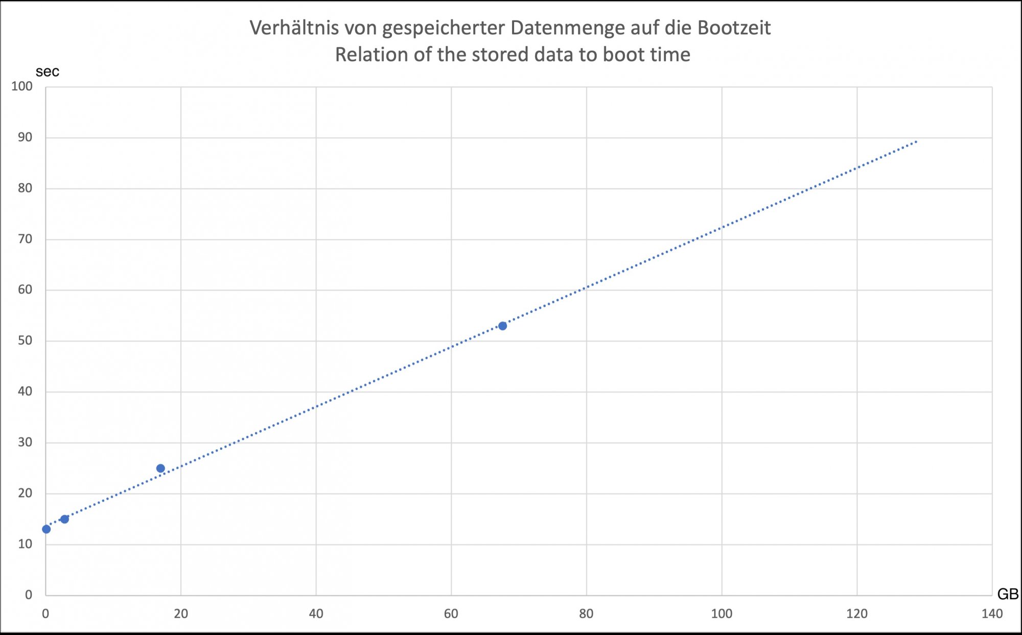

Boot-time:
Pasted Graphic 7.tiff
